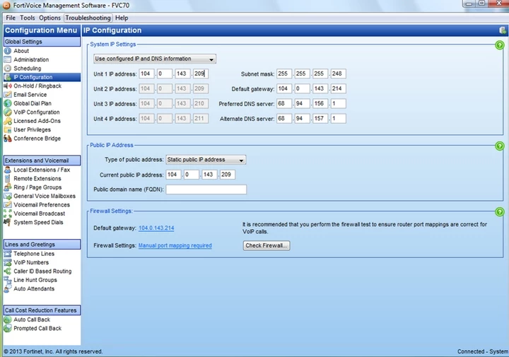

One of these public IP addresses should be assigned to your Fortinet PBX system using the IP Configuration/System IP Settings field. AT&T will give you the default gateway, subnet mask and DNS settings as well. Use the same static public IP address in the “Public IP Address” field:
Enter these values into the IP Configuration and select File > Save.

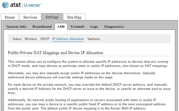

Go to the AT&T router configuration and proceed to the Settings/LAN/IP Address Allocation page:

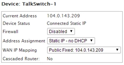

Scroll down and find the Fortinet PBX. This may be called Talkswitch-1. Set the Firewall to “Disabled,” the Address Assignment to “Static IP-No DHCP” and the WAN IP Mapping to “Public Fixed: xxx.xxx.xxx.xxx” where xxx.xxx.xxx.xxx is the static IP address of the FortiVoice PBX that was set above.
Scroll down to the bottom of this page and Save.

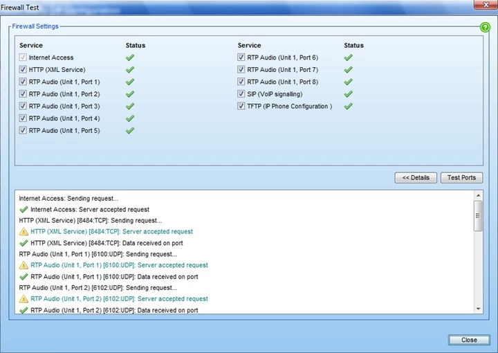

Now check the firewall in the FortiVoice IP Configuration screen
This test shows that all the FortiVoice ports are working to process VoIP. Reboot the router and reboot the FortiVoice PBX.
