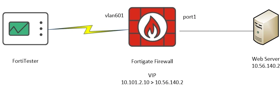

This article describes how to use FortiTester to stress test a Web or Application server by simulating users accessing to the site. Below simple diagram use case where FortiTester sends traffic to FortiGate VIP IP translates back to the Web server.

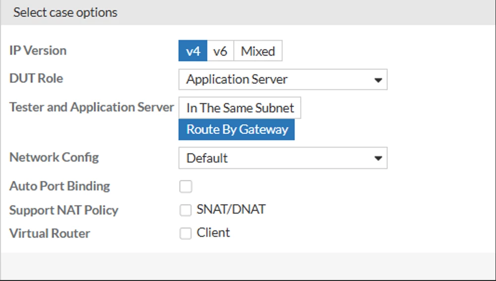

Use Performance Testing to create a test case on the HTTP CPS option:
Select 'Create New ' and select the following:
  • DUT Role = Application Server
  • Tester and Application Server = Route By Gateway
Leave the rest of the setting default as per screenshot below:

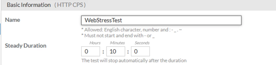

Select 'OK' to proceed, change the Test case name accordingly, and use the default duration of 10 mins to check if it is working fine before changing it to run longer period.

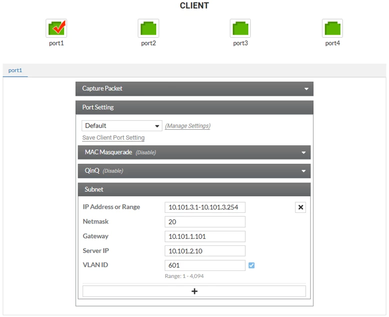

Uncheck other ports except port1 (only use a single port to send load traffic) and remove additional Subnet settings.
Under Network Setting, uncheck all ports except port1, then remove the additional subnet setting. Specify the IP address range, mask, and gateway according to the FortiGate network settings. Server IP refers to the web server or VIP IP address:

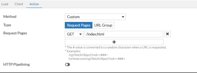

In the Action tab, change the Request Page to point to the correct HTML file for FortiTester to get or use another method like POST or use Custom, which supports a mix of POST and GET on multiple pages.

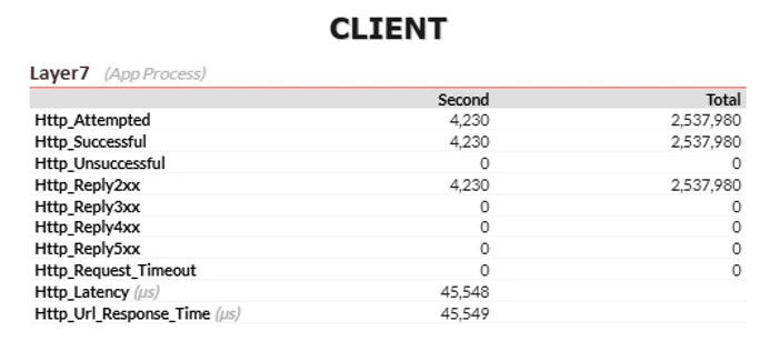

The following is an example of a successful running test result:
