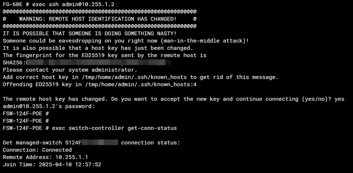

Issue:
Cannot manage FSW via SSHCannot manage FSW via SSH

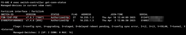

FortiSwitch is Authorized/Up on switch-controller:
FortiSwitch is Authorized/Up on switch-controllerFortiSwitch is Authorized/Up on switch-controller

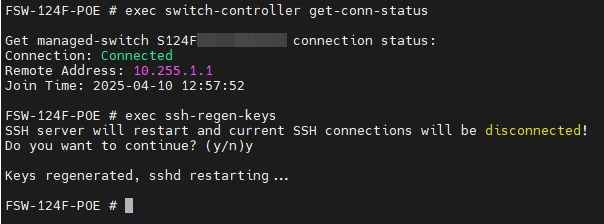

Solution:
Regenerate SSH keys by executing this command on FortiSwitch CLI. Note that this command must be executed via console port (baud rate 115200):
exec ssh-regen-keys
FortiSwitch CLI (connected via console port)FortiSwitch CLI (connected via console port)
Then try again to access the FortiSwitch via SSH from FortiGate or any other SSH client; the issue should be resolved:
Accept the new key generated.Accept the new key generated.
