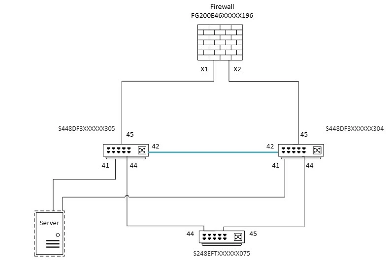

Description This article explains a scenario where the STP state is intermittently disabled on FortiLink trunk ports that has MCLAG enabled, and outlines how to identify and correct this behavior.
Scope FortiSwitch in Managed Mode, versions 7.2, 7.4, 7.6.
Refer to the above topology, where the FortiLink interface is configured as an aggregate (using ports x1 and x2).
Note: STP is disabled by default on the FortiLink trunk (G200E4Q16900196) connecting to the FortiGate.
In some cases, the STP state is observed to be randomly disabled on FortiLink trunks or trunks configured with MCLAG.
For example, consider the following trunk configuration on FortiSwitch S448DF3XXXXXX305:

Root Cause:
This behavior occurs when mclag-stp-aware is disabled on the MCLAG-ICL peer FortiSwitches. By default, this setting is enabled on FortiSwitches forming the MCLAG-ICL pair.
To verify the current setting:
show full-configuration switch global
config switch global
    set mclag-stp-aware disable
Resolution:
Ensure mclag-stp-aware is enabled on the MCLAG-ICL peer switches.
    set mclag-stp-aware enable
Additionally, verify whether this setting is being overridden via configuration pushed from the FortiGate (for example, through custom-commands) or modified by external sources. If this was disabled unintentionally, re-enable the setting as shown above.
