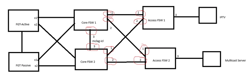

Refer to the below use case in this KB article, and follow the configuration and troubleshooting steps.
For example, the issue is that the IPTV multicast is not working, TV is not receiving the streaming service.
Setup:
FortiSwitches are managed by FortiGate.
TV is trying to join multicast address 239.241.1.1.
IPTV receiver and server/sender are on the same VLAN for eg. vlan2.
Refer to configuration and troubleshooting steps:

  1. When an inter-switch link (ISL) is formed automatically in FortiLink mode, the igmp-snooping-flood-reports and mcast-snooping-flood-traffic options are disabled by default.
For example: Refer to the diagram, the ports marked in red are ISLs. Check config on the ISL interface by taking CLI access to each FortiSwitch and executing the below commands:
show switch trunk
show full-config switch interface <trunk name>
  •  Notice that these settings are disabled on all ISL trunks except the mclag-ICL trunk interfaces on Core FSW1 and Core FSW2 port3.

  1. On all 4 FortiSwtiches, check the below commands:
get switch igmp-snooping group
On Access FSW1 -> the multicast address learned on port3 is visible.
On Core FSW1, Core FSW2, and Access FSW2 ->Tthe ISL trunks learning the multicast address 239.241.1.1 from Access FSW1 is visible.
On Core FSW1, Core FSW2, and Access FSW1 -> The ISL trunks learning the querier address configured on Access FSW2 is visible.
On Access FSW2 -> The querier learnt on port3 is visible.
