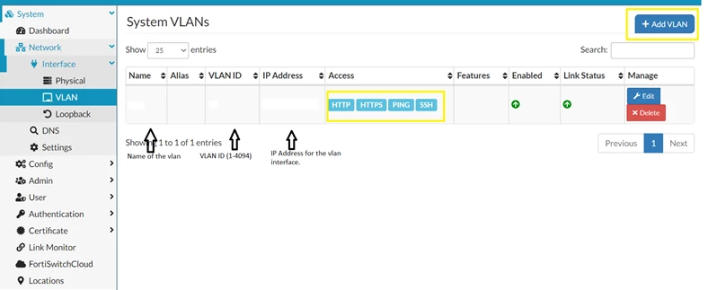

1) Create a Layer-3 system VLAN interface with HTTP,HTTPS,PING,SSH access below.
From GUI of standalone Fortiswitch go to System -> Network -> Interface -> VLAN and select 'Add VLAN'.
From CLI.
# config system interface
(interface) edit "interface name"
(interface name) set mode <static/dhcp> <----- Select static or DHCP.
(interface name) set ip <xxx.xxx.xxx.xxx xxx.xxx.xxx.xxx> <----- IPv4 and subnet mask, if mode set to static.
(interface name) set allowaccess < http https ping ssh >
(interface name) set vlanid <1-4094>
(interface name) set type vlan
(interface name) set status up
(interface name) end

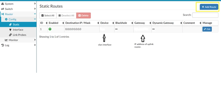

2). Create a static route to get FortiSwitch access on the VLAN.
To provide remote access to the management VLAN, configure a static route.
Set the gateway address to the IP address of the router.
Using the GUI: go to Router -> Config -> Static and select 'Add Route'.
From CLI.
#config router static3) Map the VLAN to desired interface of the switch port.
(static)#edit 1
(1) set device <vlan interface>
(1) set gateway <xxx.xxx.xxx.xxx>
(1) set status enable
(1)end
