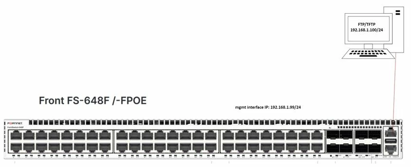

Topology:
 In this example:
  • The PC is directly connected to the management port of the FortiSwitch.
  • The PC is running an FTP/TFTP application.
  • The PC has an IP of 192.168.1.100/24.
  • The FortiSwitch management interface has an IP of 192.168.1.99/24 (in this example, the IP is set on a secondary).
