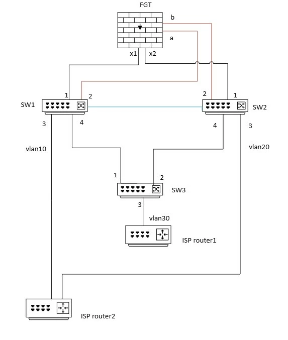

The requirement is to set up multiple ISP connections terminating on FortiGate over an L2 FortiLink setup.
Topology:
Network Setup:
  • SW1, SW2, and SW3 are FortiSwitch devices.
  • SW1 and SW2 are configured in an MCLAG-ICL pair and managed by FortiGate.
  • Aggregate interface name: EXT (FortiGate ports a, b).
  • FortiLink interface name: fortilink (FortiGate ports x1, x2).
ISP Router Connections:
  • ISP Router 1 is connected to SW3 with VLAN 30 tagged and terminated at VLAN interface VLAN30, created under the FortiLink interface.
  • ISP Router 2 is connected to the MCLAG-ICL pair on port3, carrying different VLANs from the ISP:
  • The ISP Router 2 to SW1 link carries VLAN 10 and terminates at VLAN interface VLAN10, created under the FortiLink interface.
  • The ISP Router 2 to SW2 link carries VLAN 20 (PPPoE) and terminates at VLAN interface VLAN20, created under the external aggregate interface EXT.
Since the FortiSwitch devices are managed by FortiGate, the configuration is pushed from FortiGate.

FortiSwitch Configurations Pushed from FortiGate:
SW1 Configuration:
config switch-controller managed-switch
    edit <SW1-SERAIL-NO>
        config ports
            edit port3
                set native-vlan VLAN10
                set dhcp-snooping trusted
            edit "EXT-trunk"
                set allowed-vlans "VLAN20"
                set type trunk
                set mode lacp-active
                set mclag enable
                set members "port2"
SW2 Configuration:
    edit <SW2-SERAIL-NO>
        config ports
            edit port3
                set native-vlan VLAN20
            edit "EXT-trunk"
                set type trunk
                set mclag enable
                set members "port2"
SW3 Configuration:
    edit <SW3-SERAIL-NO>
        config ports
            edit port3
                set allowed-vlans "VLAN30"
Since this is a FortiLink setup, trunks are automatically formed between FortiGate and FortiSwitch devices, as well as between FortiSwitch devices. VLANs are dynamically assigned on FortiSwitch FortiLink trunk ports.
