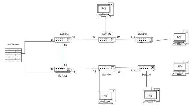

Topology:
Config for the above topology:
VLANs configured (see Configuring VLANs - FortiSwitch FortiLink guide) under FortiLink: 10, 20, 30, 40, 50, and 4093
  • PC1 is on VLAN 10.
  • PC2 is on VLAN 20.
  • PC3 is on VLAN 30.
  • PC4 is on VLAN 40.
  • PC5 is on VLAN 50.

When set to prune, VLANs are dynamically assigned only to ISL trunk ports that are part of the communication path between destinations using those VLANs.
VLAN assignment on trunks with pruning enabled:
Trunk         VLANs Assigned
T1–T6         10, 20, 30, 40, 50, 4093
T8              20, 30, 40, 4093
T10, T12     30, 40, 4093
T7              10, 50, 4093
T9,T11        50, 4093
Note: VLAN 4093 will be included if a quarantine VLAN is configured. See Quarantines - FortiSwitch 7.6.3 FortiLink guide.
