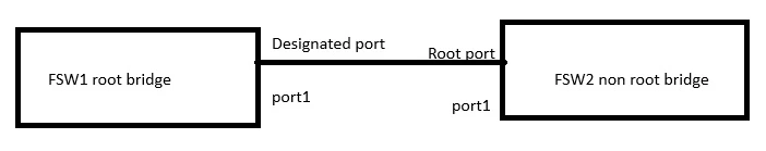

Consider the setup below:
  • FortiSwitch1 is the root bridge.
  • FortiSwitch2 is the non-root bridge.
  • Both FortiSwitches are connected via port1.
Once the ROOT BRIDGE FortiSwitch1 is rebooted and it comes online, there will be a STP convergence, and the NON-ROOT BRIDGE FortiSwitch2 port1 becomes the ROOT port, which is expected.
After 3 minutes and 15 seconds, the port1 on NON-ROOT BRIDGE FortiSwitch2 changes STP role from ROOT to designated and then back to ROOT, without any Topology Change Notification.
