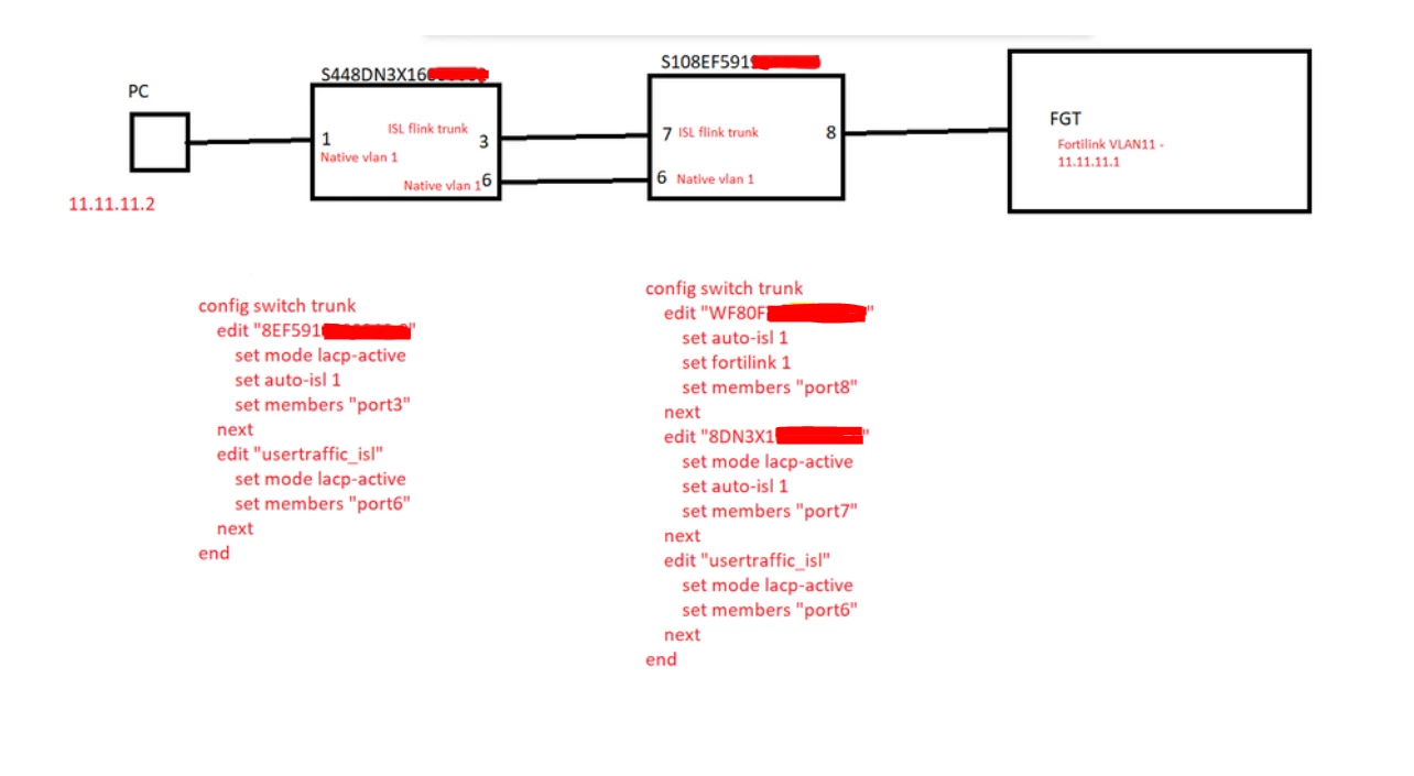

Refer to the below diagram: -
Here on FortiSwitch 448D port3 and FortiSwitch 108E port7 are ISL FortiLink trunk.
By default, all vlans are allowed in FortiLink trunk, here the requirement is that there should be a different link port6 for data vlan11 traffic.
Configuration Steps: -

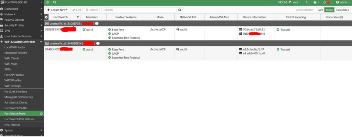

1) In above example, a trunk interface 'usertraffic_isl' is created.
 If required, more ports can be added as member of trunk (LACP). The user vlan is mapped as native vlan, one can add multiple allowed vlans as well if required.
2) Create a separate MSTP instance ID on both FortiSwitches - add vlan11 to the MSTP instance – make sure that core FortiSwitch is the stp root bridge, so a lower stp priority on core switch is required. This  step is needed, so that the trunk 'usertraffic_isl' doesn’t move to alternate state.
