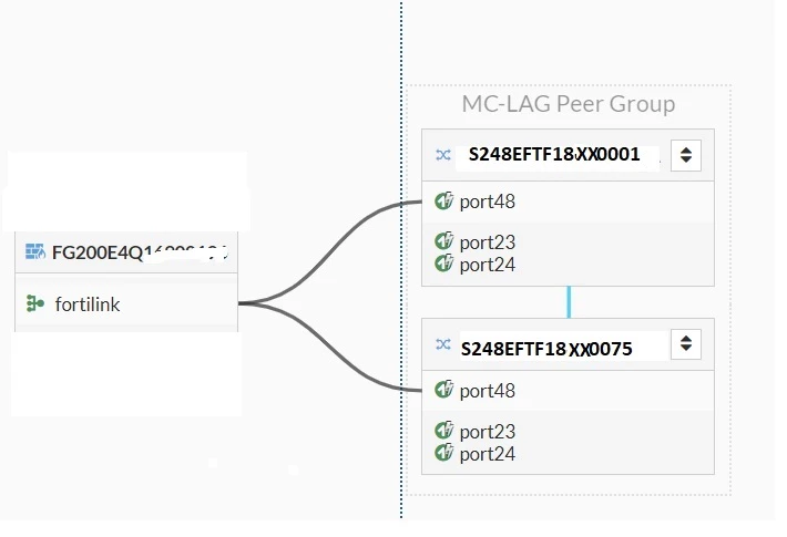

To avoid this issue, get the console to both FortiSwitch and delete the mclag-icl trunk.
An example on FortiSwitch will be: S248EFTF18XX0075 and see the following trunk configured:
# show switch trunk
# config switch trunk
    edit "8EFTF18XX0001-0"
        set mode lacp-active
        set auto-isl 1
        set mclag-icl enable  <-- manually enabled mclag-icl on the trunk
        set members "port23" "port24"
Then delete the trunk in both FortiSwitches.
On S248EFTF18XX0075:
    delete 8EFTF18XX0001-0"
Similarly, delete the trunk on S248EFTF18XX0001 as well.
Now, since default-auto-mclag-icl lldp profile is mapped from the FortiGate to the ICL ports, the FortiSwitches will form a trunk with a new name '_FlInK1_ICL0_'.
