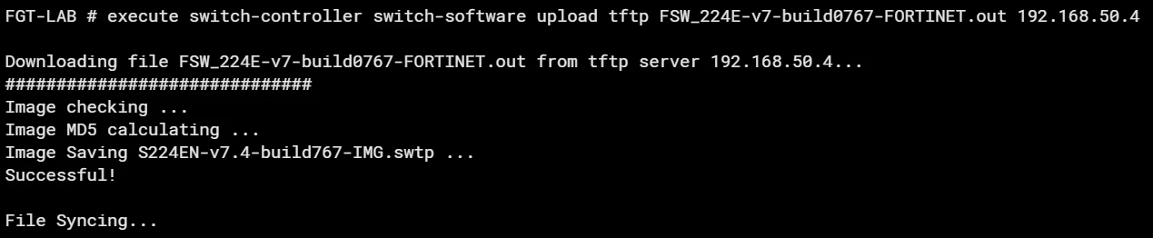

Example:
FortiSwitch firmware image uploaded to FortiGateFortiSwitch firmware image uploaded to FortiGate
After the image is successfully uploaded to FortiGate, the administrator can view it listed with the command below.
FortiGate # execute switch-controller switch-software list-available
