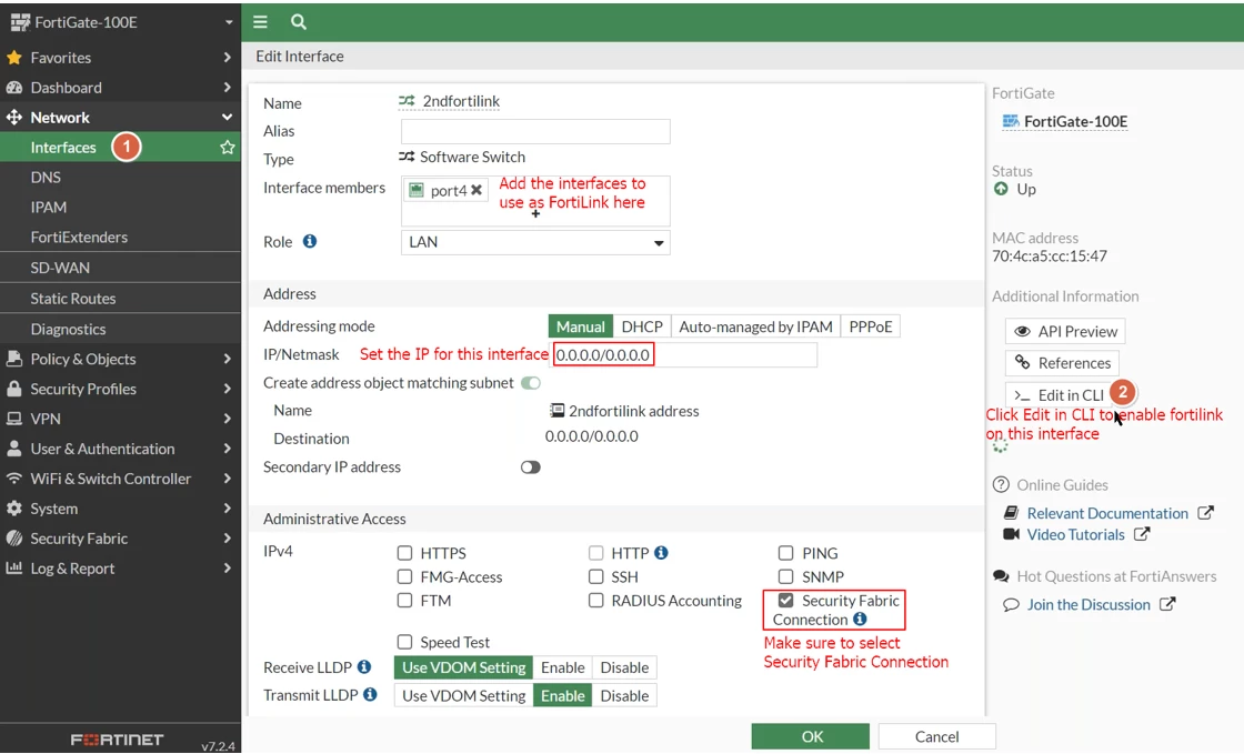

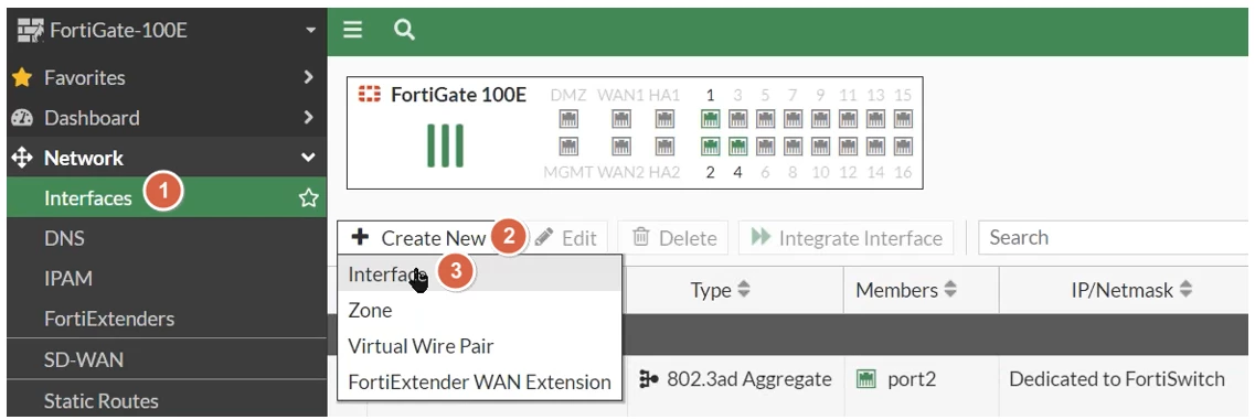

1) If already having an interface created as a Hardware Switch use it or create a new one: Interfaces -> Create new -> Interface -> Type -> Hardware Switch or Software Switch -> OK.
In this step, it should also be created with a name.

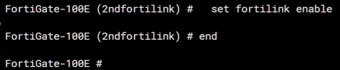

2) On WiFi & Switch Controller menu, select Network -> Interfaces. Then, open the Hardware Switch interface or Software Switch interface created by selecting its name. Then, edit the interface by selecting the button on the right: Edit in CLI -> Enter the command show full-configuration.
It will display that the interface has FortiLink disabled. Then run the commands below to enable it:

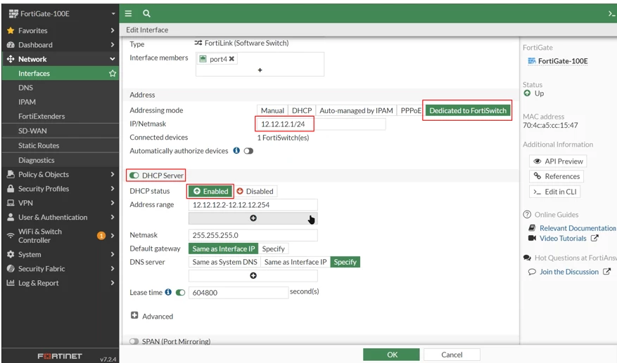

set fortilink enable
Once completing this step, check again the interface if it has the Dedicated to FortiSwitch option enabled and check if it has DHCP status Enabled; finally, assign the ports needed to connect the Switches (in this example, port1 and port4 are used).

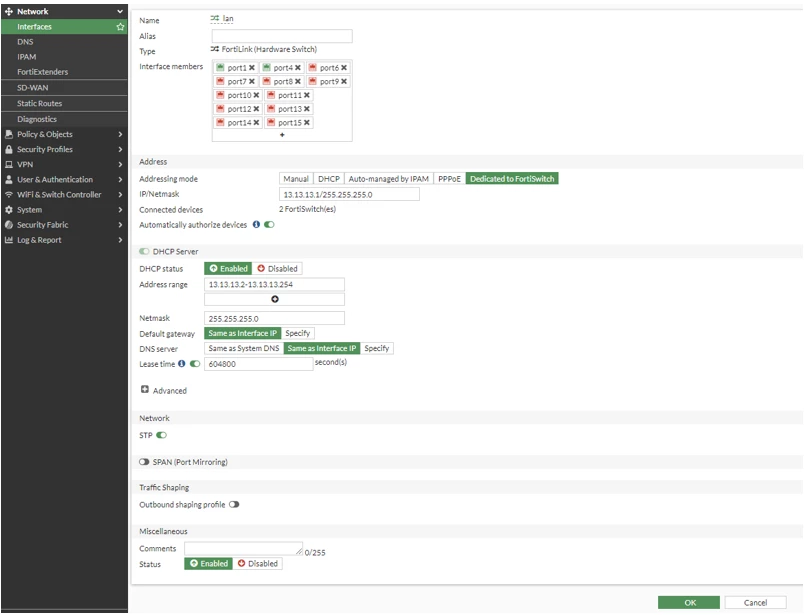

Hardware Switch:

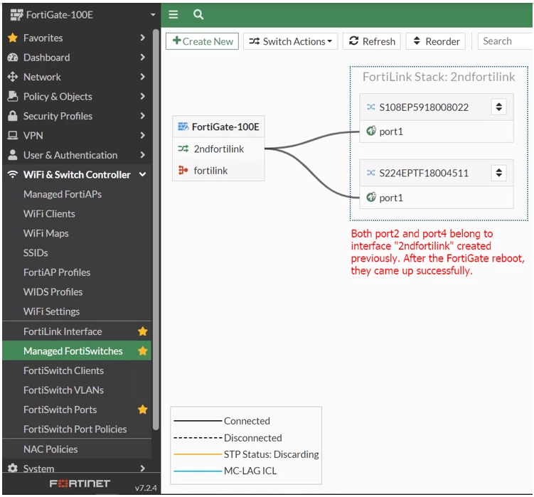

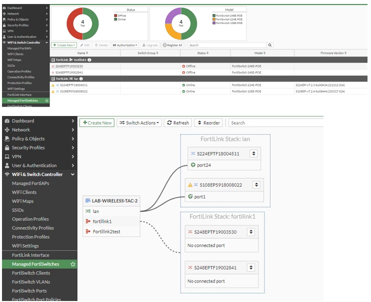

7) After the reboot, it should be seen the topology created with the Hardware switch. As displayed, more FortiLink interfaces have been created, fortilink1 was dedicated to an aggregate interface.
Hardware switch topology:
Software switch topology:
