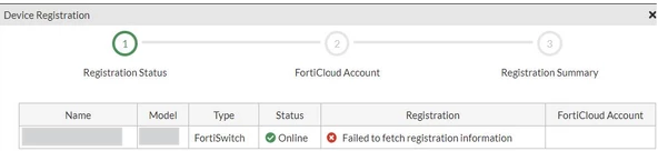

Description This article describes how to fix the error 'Failed to fetch registration information'.
Scope FortiGate, FortiSwitch v7.0 and above.
Error shown in the GUI:
  • First, verify whether the FortiGate and FortiSwitch/FortiAP are registered under the same FortiCloud account. If not, make sure that they are registered in the same account.
For more information on this, refer to Troubleshooting Tip: FortiAP and FortiSwitch registration failed due to FortiCloud account mismatch.
Once devices are in the same FortiCloud account, follow the steps below:
Execute the command 'show full sys fortiguard' on FortiGate.
If the default settings are set:
config system fortiguard
    set fortiguard-anycast enable
    set protocol https
    set port 443
Change the following parameters:
    set fortiguard-anycast disable
    set protocol udp
    set port 8888
    set sdns-server-ip 208.91.112.220 173.243.140.53 210.7.96.53
Then update the FDS servers with the command 'execute update-now' and run the following commands to check the FortiGuard reachability.
diagnose debug disable
diagnose debug reset
diagnose debug application update -1
diagnose debug console time enable
diagnose debug enable
execute update-now
A successful FortiGuard connection will show something like the following in the end:
[1104] ssl_ctx_free: Done
[1085] ssl_disconnect: Shutdown
do_update[684]-UPDATE successful
If it still does not work, disable debug using below commands and restart the FortiCloud process on FortiGate :
- Restarting the FortiCloud process on FortiGate:
Get process ID of FortiCloud process (forticldd:(
FG # diagnose sys process pidof forticldd
179
Restart the process:
FG # diagnose sys kill 11 179
If the restart was successful, a new process ID will be shown.
185
Check DNS configuration on FortiGate by issuing the following command:
get system dns
Ensure DNS is properly configured on FortiGate. The FortiSwitch/FortiAP may fail to reach Fortinet's Cloud servers for registration if DNS resolution is not working.
If neither of the steps above help, follow the instructions described in Troubleshooting Tip: FortiCloud connection failure and open a new ticket with TAC for further assistance.

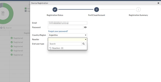

Note 1: This article also fixes the following issue: The 'Reseller' textbox does not load correctly, and it is impossible to continue with the registration process.
Example:
To register FortiSwitch/FortiAP through CLI:
diagnose forticare direct-registration product-registration -N <FortiSwitch/AP Serial Num.> -a <FortiCloud username> -p <password> -T <country> -R <reseller> -e 1
