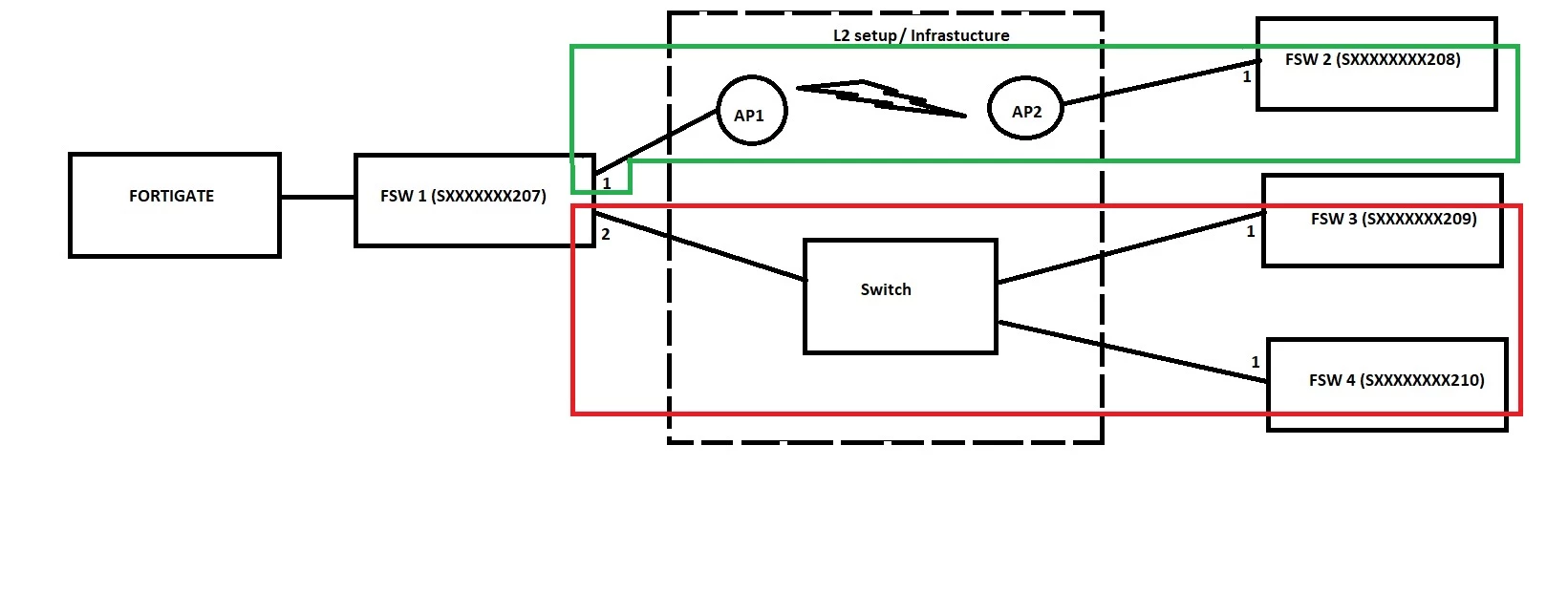

Refer to the below diagram, here two different setups can be seen.
1) The green setup is supported: -
https://community.fortinet.com/t5/FortiSwitch/Technical-Tip-FortiLink-over-p2p-wireless-bridge-mesh/ta-p/214925
2) The Red setup is not supported. Using FortiLink P2P, either FortiSwitch3 or FortiSwitch4 can be bought online on FortiGate but not both FortiSwitch.
              - When P2P is enabled on FortiSwitch1 port2, it will form a trunk with the peer FortiSwitch i.e., either FortiSwitch3 or FortiSwitch4, so only one of the FortiSwitch3 or FortiSwitch4 will come online.
              - The reason is the FortiSwitch3 and FortiSwitch4 are using shared L2 setup and traffic from both FortiSwitches will hit same port (port2) of FortiSwitch1

So it is best to have a dedicated L2 setup per P2P connection to avoid issue as described with RED setup.
P2P is for inter-switch link (ISL) between two FortiSwitches over a layer2 device, so the below setup is also not supported: FortiGate - 3rd party Switch - FortSwitch configured for p2p;
