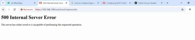

This article describes the cause of encountering '500 Internal Server Error' when attempting to create an ingress/egress ACL policy via the FortiSwitch GUI.

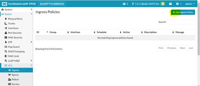

The issue occurs when following the path:
Switch → ACL → Ingress/Egress Policy → Add Ingress/Egress Policy.
ACL service and policer are not available on FortiSwitch-648F, therefore ACL service and policer config are also not available in ACL egress and ingress.
This causes the error 'Uncaught InvalidPathNameError' in the console.
As a workaround, perform this configuration on the device CLI interface and to resolve it, upgrade to v7.4.7 or 7.6.2 and above.
