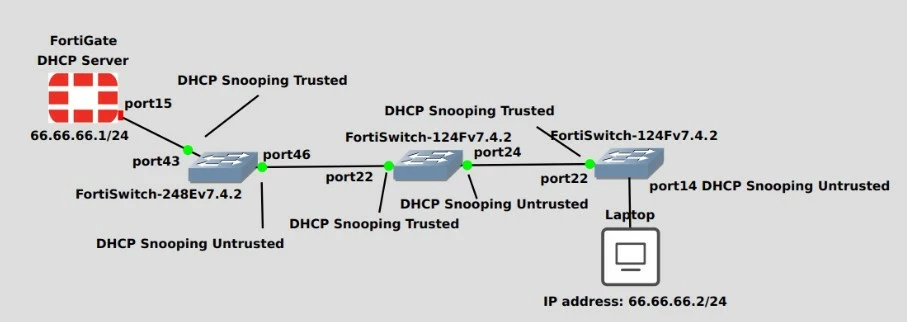

DHCP snooping can be activated between the DHCP Server and the first FortiSwitch and the Client connected to this FortiSwitch can receive IP address, but the problem arises when there is more than 1 FortiSwitch on the topology, the user connected to the Final FortiSwitch might not receive IP address if FortiSwitches has any other firmware version like 7.2.x or some other different one that 7.4.x, this is the topology to achieve:

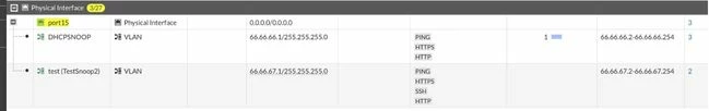

FortiGate is acting as the DHCP server, but the DHCP Server in charge could be any other box, port15 is the elected one which has inside 2 VLANs, and VLAN 66 is the one which will be providing the IP address to the final device:
The first FortiSwitch-248E should have a trunk connection, VLANs allowed, DHCP server access list  on global mode enabled, and VLAN with DHCP snooping enabled along with the server access-list:
