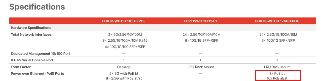

  • The PoE++ is not supported from the FortiSwitch model 108F FPOE, as indicated in the FortiSwitchâ„¢ Secure Access datasheet on page 9. The 'Power Over Ethernet (PoE) Ports' row indicates that it supports only 802.3af/at (PoE and PoE+).
  • The PoE++ is supported instead by the FortSwitch 124G FPOE, it support the PoE++ for 8 ports, as indicated at the page 10 of the same Datasheet quoted below:
Screenshot of the first part of the page 10 of the DatasheetScreenshot of the first part of the page 10 of the Datasheet
