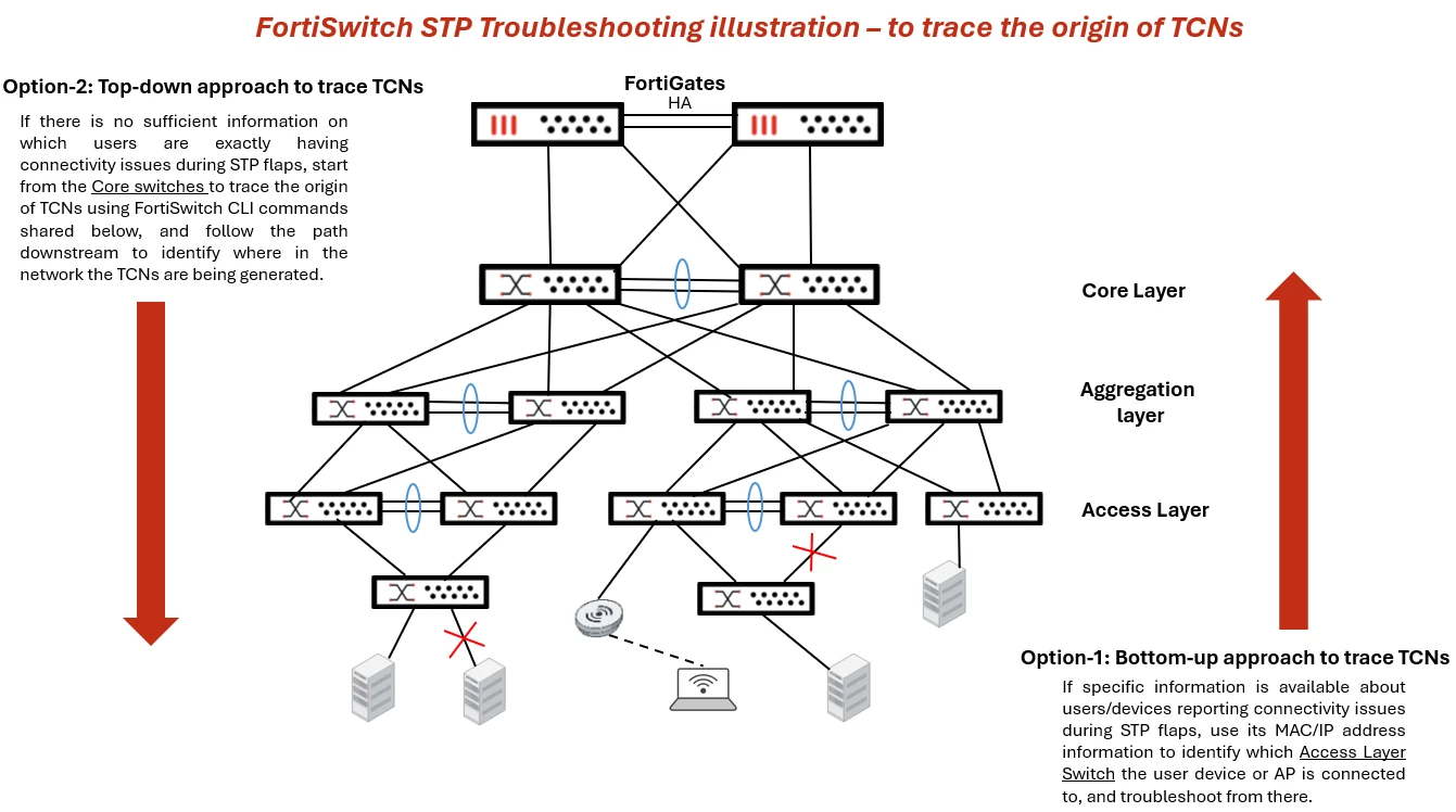

Step 6: Trace the origin of TCNs (Topology Change Notifications) in the network.
STP reconvergences are usually triggered by TCNs created by one or more switches in the network. Typically when a port status changes, TCNs are created and STP reconverges to reflect the change. But there are situations when TCNs would be created excessively or incorrectly which can cause repeated STP reconvergences/flaps, causing network instability. A managed FortiSwitch deployment has MSTP enabled by default, and consists of two MSTP instances:
  1. Instance 0: For data plane traffic (all ports/trunks), for all VLANs in the network (except FortiLink management VLAN).
  2. Instance 15: For control plane traffic (FortiLink/Capwap), with a FortiLink management VLAN (by default, VLAN 4094).
Check if the TCN Events triggered/received counters were incremented recently (in the last few minutes or hours) in either of the two instances, which would indicate STP reconvergences. Use the following command to review the diagnostic status of STP instances 0 and 15.
FortiSwitch# diagnose stp instance list
MST Instance Information, primary-Channel:
Instance ID 0 (CST)
Config Priority 20480
Bridge MAC abcdabcdabcd, MD5 Digest ashah31hw7a8a8s7a7sa
Root MAC abcdabcdabcd, Priority 20480, Path Cost 0, Remaining Hops 20
(This bridge is the root)
Regional Root MAC abcdabcdabcd, Priority 20480, Path Cost 0
(This bridge is the regional root)
Active Times Forward Time 15, Max Age 20, Remaining Hops 20
TCN Events Triggered 1034 (0d 3h 35m 20s ago),Received 31024(0d 0h 0m 1s ago) <----- TCN's received counter is incrementing faster and more frequently (see the last sent timer which shows 1 second ago) than TCNs triggered (locally on the switch), indicating the port flaps/topology changes are not happening on this switch, but instead happening on another switch in the topology.
<Snippet>
The STP status of all the FortiSwitches in a managed FortiSwitch topology can be obtained with a single command from the FortiGate CLI using 'diagnose switch-controller switch-info stp'
To trace the origin of TCNs, either top-down or bottom-up approach (w.r.t Core, Aggregation, Access layers) can be used depending on how much information about the issue is available at the beginning of troubleshooting.
6.1 Bottom-up approach:
If specific information is available about any users/devices reporting connectivity issues during STP flaps, use its MAC/IP address information to identify which access layer switch the user device or AP is connected to - either by using the FortiGate GUI (if using FortiSwitch in managed mode), or by using the CLI as shown below:
FortiGate GUI: If the FortiSwitches are in managed mode, go to the FortiGate GUI -> Dashboard -> Users & Devices -> Device Inventory -> Search, and filter for the IP address or MAC address of the affected user/device and look for 'fortiswitch ports' column (disabled by default, can be added using column settings on this table). This will help identify which switch in the access layer the device is connected to. Use this switch as the starting point to trace the TCNs, use the command 'FortiSwitch# diagnose stp instance list' to check the TCN Received/Transmitted tracker in the output of this switch to analyze whether this switch is sending TCNs (which indicates topology changes being triggered on this switch) or its only receiving (from another part of the network). Continue to trace the network (using 'FortiSwitch# get switch lldp neighbor-summary' on each of the switches to find out the other neighbor switches) to look for the origin of TCNs using the same 'FortiSwitch# diagnose stp instance list' command as shown in the example outputs in previous sections.
FortiGate CLI: Alternatively, use the command output from running 'FortiGate# diagnose user device list' on the FortiGate and search for the affected user/device's IP/MAC address in the list to identify which switch it is connected to. Once identified, follow the same procedure as mentioned in the previous section to trace the origin of TCNs using FortiSwitch CLI (by connecting to FortiSwitch SSH/console directly, or using the "connect" option from within FortiGate GUI in the "Wifi & Switch Controller > Managed FortiSwitches->Topology" section by right-click on the corresponding FortiSwitch).
6.2 Top-down approach:
If there is no sufficient info on which users are exactly having connectivity issues during STP flaps, start from the Core switches to trace the origin of TCNs using the output of 'FortiSwitch# diagnose stp instance list', and follow the path downstream to identify where in the network the TCNs are being generated, using 'FortiSwitch# get switch lldp neighbors-summary'.
Once the origin of TCNs is located, review the logs from the switch to check for frequent port flaps (Refer to Step 4). Use the cable diagnostics on the affected ports to identify possible cable issues (when cable diagnostics are run, it could reset the interface - so it is recommended to run this in a maintenance window). If the port is an SFP port, use the command 'get switch module summary' to check for any issues with the SFP module.
FortiSwitch# get switch module summary
  Portname   State    Type       Transceiver    RX  Vendor           Part Number      Serial Number
   port25     INSERT  SFP/SFP+    10G-Base-LR    LOS FS               SFP-10GLR-31     F2031892158   <<<<<<<<<<<<<<<<<<< RX showing LOS/Loss, possible issue with SFP
  port26     INSERT  SFP/SFP+    10G-Base-LR    LOS FS               SFP-10GLR-31     F2031892157  <<<<<<<<<<<<<<<<<<<<RX showing LOS/Loss, possible issue with SFP
  port27     EMPTY
  port28     EMPTY
In managed mode, it is possible to use the switch-controller CLI in FortiGate to speed up collecting the 'diagnose stp instance list' output from all of the FortiSwitches in the topology in one go and then trace the origin of TCNs. Use the two commands below on the FortiGate for this task as shown:
FortiGate# execute switch-controller diagnose stp instance [Enter]
This gives the list of all switch serial numbers in the topology, copy this to a text editor like notepad++ which will give line numbers. Use this to map the serial numbers to its TCNs using the output of the next command shown below.
FortiGate# execute switch-controller diagnose stp instance | grep TCN
Copy this output again to a new tab in Notepad++ which will give the line numbers. Now, check where the TCNs are being triggered in the output, and map those line numbers with the previous output collected which has the serial numbers. This gives the potential list of switches where the TCNs are originating from.
With FortiSwitch firmware 7.6.2 and later versions, a new CLI has been introduced that will show the specific port on a FortiSwitch from which a TCN was last received (or the port from which it was last sent/triggered). This would further help in speeding up the tracing of primary location of TCNs in the network. Here is the CLI command (with a grep for TCN for brevity)
FortiSwitch# Diagnose stp summary state forwarding | grep TCN
TCN Events Triggered 1 (0d 2h 23m 50s ago, from port4), Received 4 (0d 0h 12m 57s ago, from port6)
