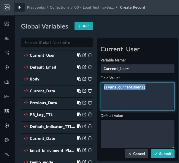

Hi @Anonymous,
Can someone help me figure out how to get the currently logged-in user details through a playbook in FortiSOAR?
Thanks.
    Best answer by AlokAgar
    You can directly retrieve and use it from the Global Variable

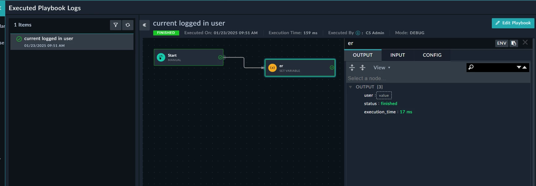

    Hi @AlokAgar ,
    when i am trying this i am getting value empty
    I am trying to fetch all the logged in user

    January 23, 2025
    @kaashif_m you need to trigger/execute this playbook from the alert page.

    January 23, 2025
    hi @ranjeet
    the response is getting only my user back.
    but currently I have three users logged in
    to get all the user who are logged in to the SOAR in this scenario.
    do you know what is supposed to be done ??
