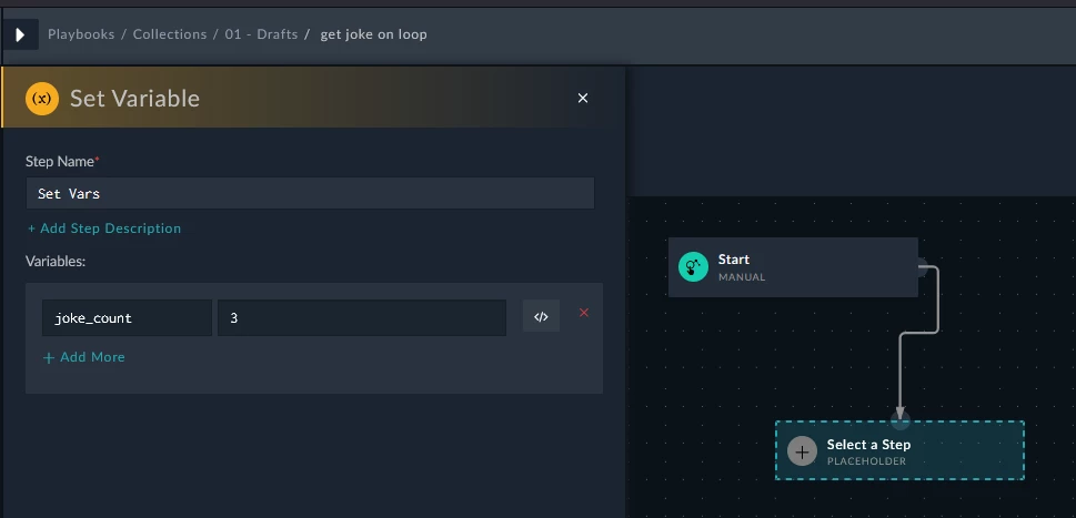

I've set a variable called joke_count to 3
To run a step on a loop, we need to pass the step a list to iterate over. So in this case I'm going to convert the joke_variable to a list that has the length of the integer. This is done with the jinja
{{range(vars.joke_count) | list}}

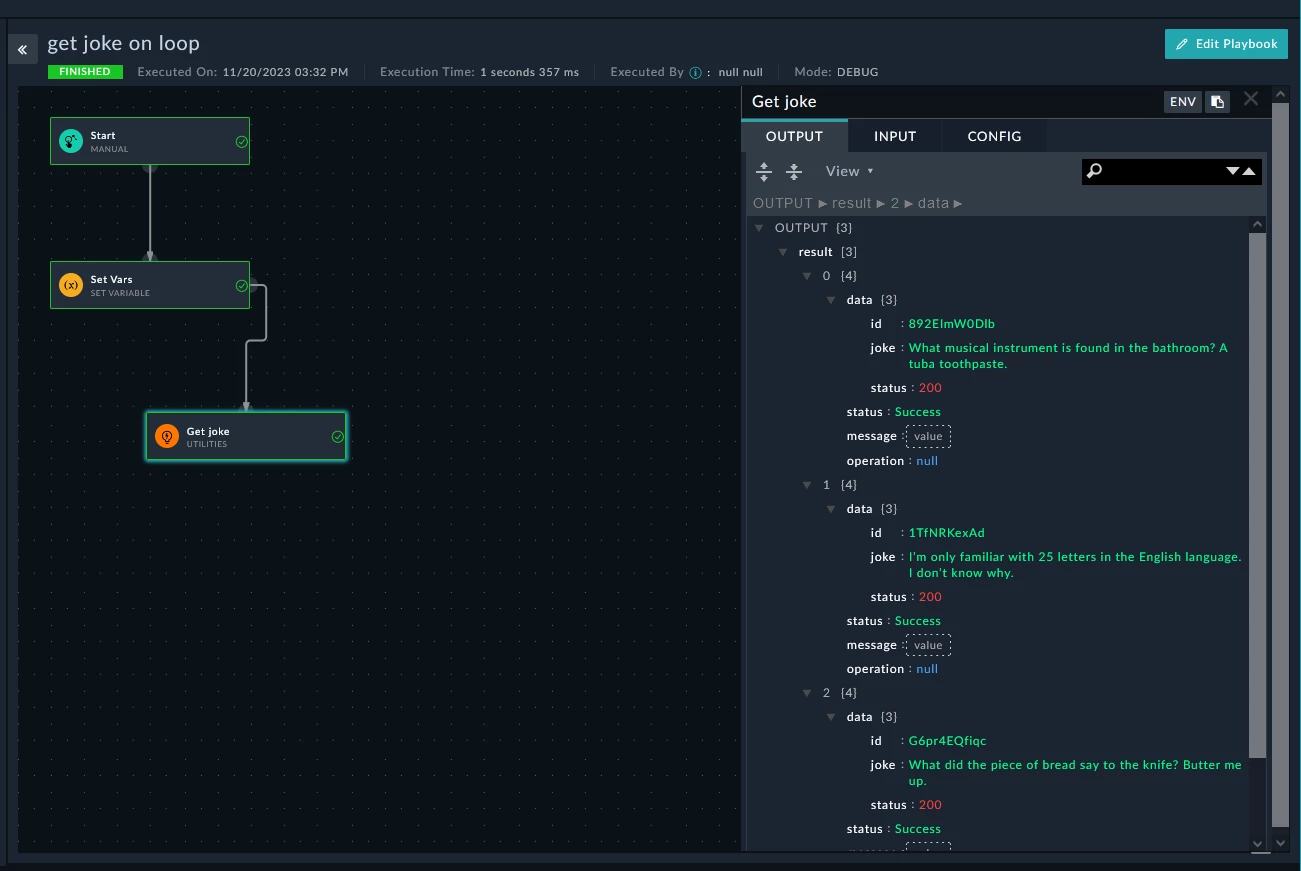

So we insert that Jinja as a for each loop on the playbook step that calls the joke api 
Running the playbook with that loop shows 3 different jokes came back

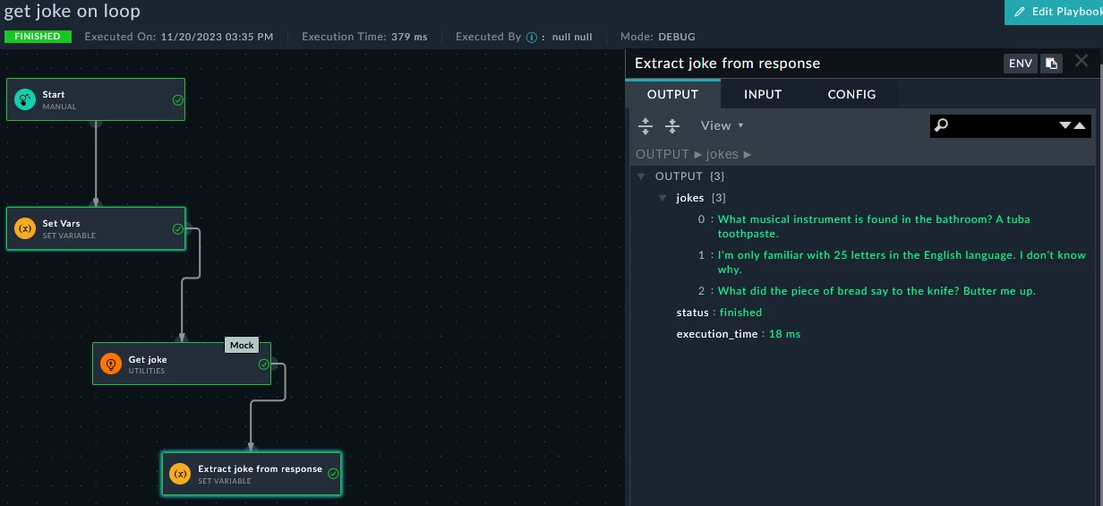

You can then use a jinja filter called json_query to grab just the jokes from all the responses in another set variable step. The correct jinja to do this is {{vars.steps.Get_joke | json_query('[].data.joke')}}

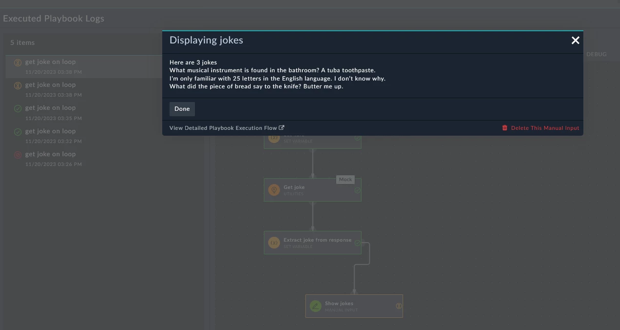

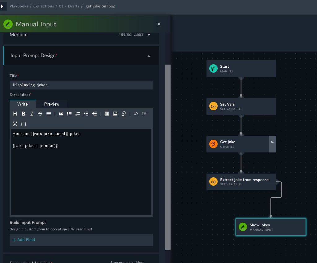

Displaying the jokes is pretty easy to do now with a manual input step 
