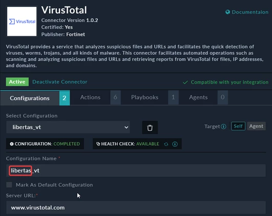

For the Connector Tenant Config Locator to work, the connector configuration for each tenant must have the tenant name in it. consider a tenant called <<libertas>> the connector configuration for this tenant must have the word "libertas" as shown below:

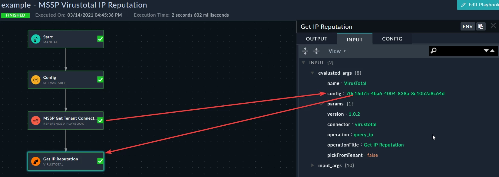

before using any connector, use the "Connector Tenant Config Locator" reference playbook to locate the current tenant configuration ID. the tenant name can be used directly from the record for it is one of its attributes (Alerts, incidents...), check the example below:
1lVn1OwpTe6XXP0l29LR_msedge_nUhRwfsHhA.pngHow it Works:
