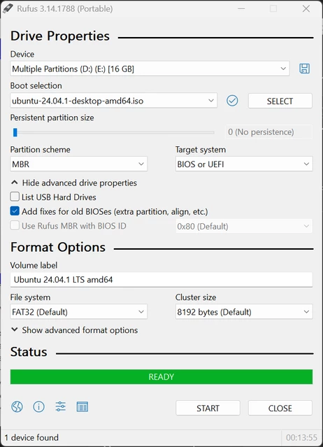

  1. Prepare the bootable USB Key:
    1. Download the Ubuntu Image from a Windows PC https://ubuntu.com/download/desktop.
    2. Open Rufus application with admin permissions.
    3. Plug the 8GB USB disk into the device.
    4. In the Device field, select the involved USB.
    5. Select the Ubuntu Image file just downloaded.
    6. In the Partition Scheme, select 'MBR'.
    7. Inthe  target System, select BIOS or UEFI.
    8. Display advanced properties and Tick 'Add fixes for old BIOSes (extra partition, align, etc.)'.
    9. Leave the 'Format Options' section with default values.
    10. Press 'Start'.

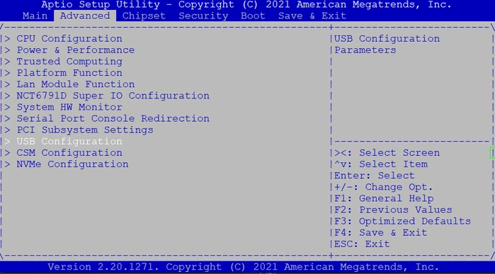

    5. In the BIOS menu, activate USB features and boot to USB Key:

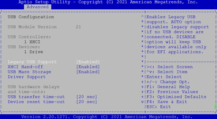

      1. Go to 'Advanced' menu .
      2. USB Configuration:
Activate 'USB Mass Storage' by putting 'Enabled', then press 'Esc' to go back tto he initial menu:

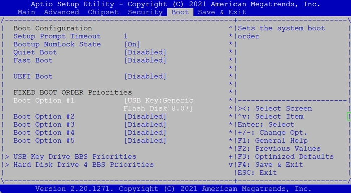

 Go to 'Boot' menu, and modify 'Boot Option #1' to 'USB Key' (Leave UEFI Boot = Disabled):
Go to 'Save & Exit' menu and select 'Save changes and reset'.
The machine will reset and boot on the USB key.

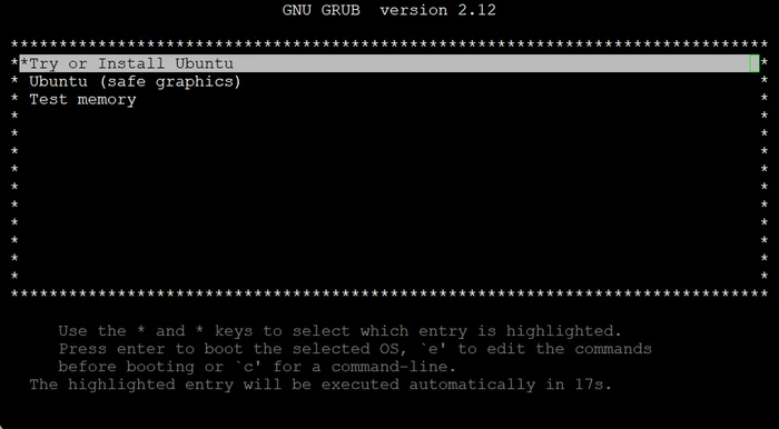

  1. Re-imaging from Ubuntu USB:
    • When booting on the Ubuntu USB key, select the 'Try or Install Ubuntu' option:
  • Go through the Ubuntu steps with 'Try' mode.

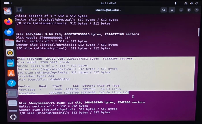

  • Run 'fdisk -l' to identify the SATA 32GB disk and note its name '/dev/sdx' . Warning! This step is important to avoid re-imaging on the wrong disk:

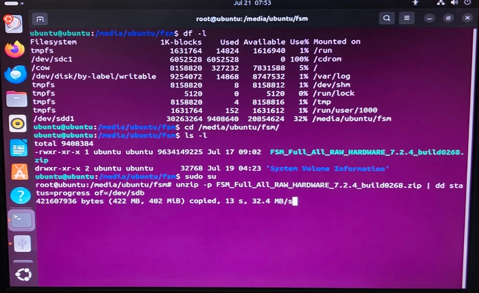

  • Plug the USB key with the FortiSIEM image.
  • On the Ubuntu desktop, click on the USB key just plugged to mount and open it.
  • Identify the FortiSIEM image file location and change directory to that location:
df -l
cd /media/ubuntu/fsm
ls -l
FSM_Full_All_RAW_HARDWARE_7.2.4_build0268.zip
  • Then re-image the disk with the command (Replace the disk name /dev/sdx with the one found earlier):
unzip -p FSM_Full_All_RAW_HARDWARE_7.2.4_build0268.zip | dd status=progress of=/dev/sdb
  • Wait for the transfer to proceed.
  • Once finished, Run 'shutdown -h now' to stop the machine.

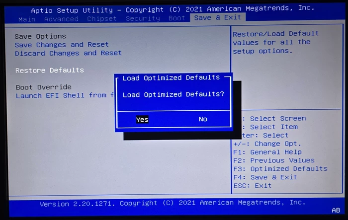

  • Restore the default BIOS settings at the 'Save & Exit' menu and select 'Restore Defaults', type Yes:
  • select 'Save changes and reset'.
