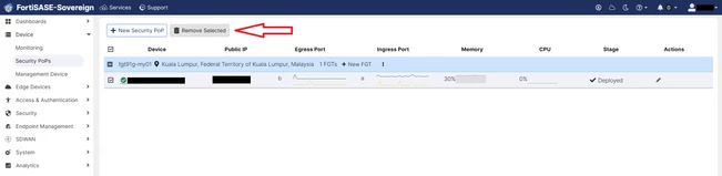

  1. Delete Security PoP in FortiSASE-Sovereign portal: Device -> Security PoPs > select Security PoP > select ‘Remove Selected’.

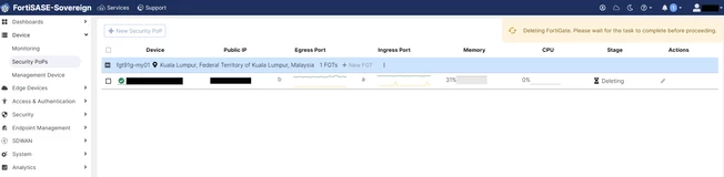

  1. Wait until deletion completes:

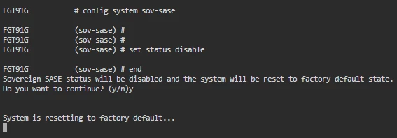

  1. Disable FortiSASE-Sovereign setting in FortiGate CLI console:
config system sov-sase
    set status disable
FortiGate will reset to factory default.

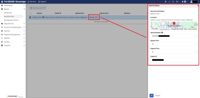

  1. Re-configure FortiGate appliance according to guidelines in FortiSASE-Sovereign deployment guide and apply necessary changes required in the deployment:
    Set Up FortiGate Appliance

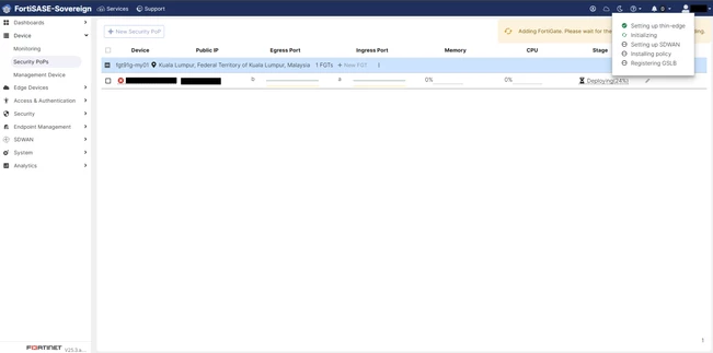

  2. Re-deploy Security PoP.
