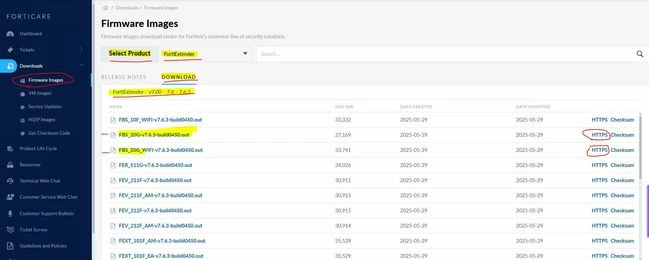

Description This article describes where to find the firmware images for FortiBranchSASE Series devices.
Scope FortiBranchSASE.
The firmware images for the product FortiBranchSASE can be found under FortiExtender.
Log in to the Fortinet support site (Support).
Navigate to Downloads -> Firmware Images -> Select FortiExtender under Select Product.
