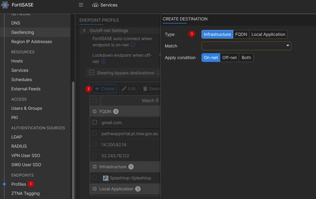

In this case, the subnet 192.168.2.0/24 should be bypassed and routed by the local gateway. In the FortiSASE customized profile, there are only three types of bypass:
Infrastructure, FQDN, Local Application:

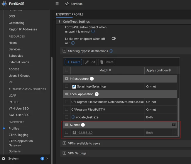

In the FortiSASE SSL Instances, the subnet will only be available in the default profile (refer to the note at the end of this article).
All profiles will apply once the bypass subnets are configured in the default profile, but it is greyed out and read-only:
The PC can reach the printer once the bypass subnet 192.168.2.0/24 is added.
