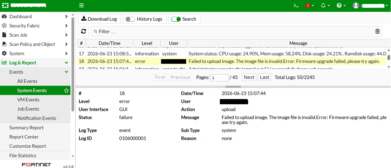

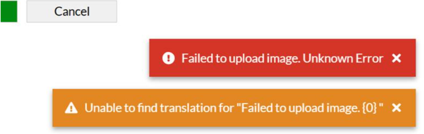

The errors in the GUI may be similar to the following:
The Errors in Logs & reports -> Events -> System Events are similar to the following:
FortiSandbox.
This error is observed during the update process when the firmware has an error.

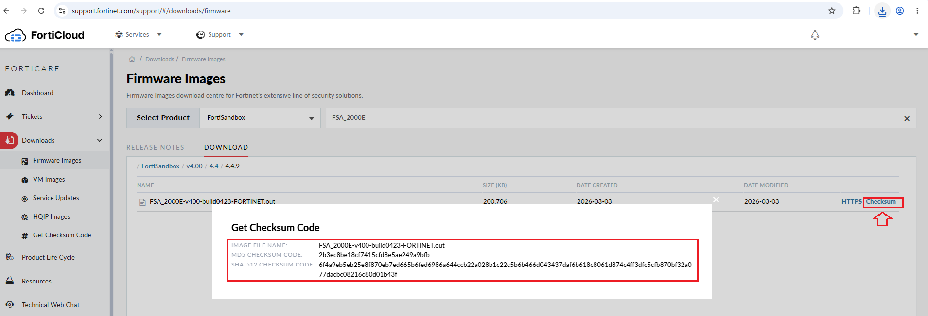

Within the Support Portal, obtain the image and the Hash value (in this case SA_2000E-v400-build0423-FORTINET.out).

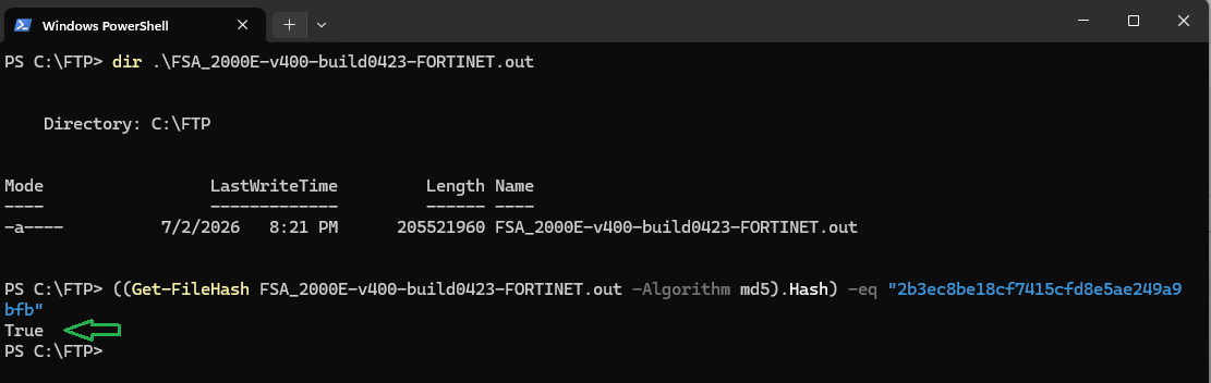

Once these values have been obtained through Windows PowerShell, they must be validated with the following command:
((Get-FileHash "image_name.out" -Algorithm md5).Hash) -eq "hash_md5"
For this example: FSA_2000E-v400-build0423-FORTINET.out.
The output should be 'True' as shown in the following output:
