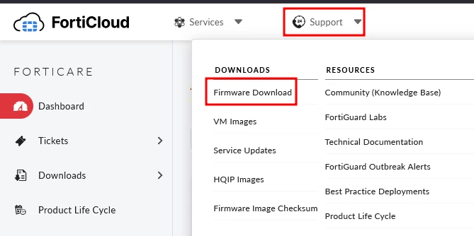

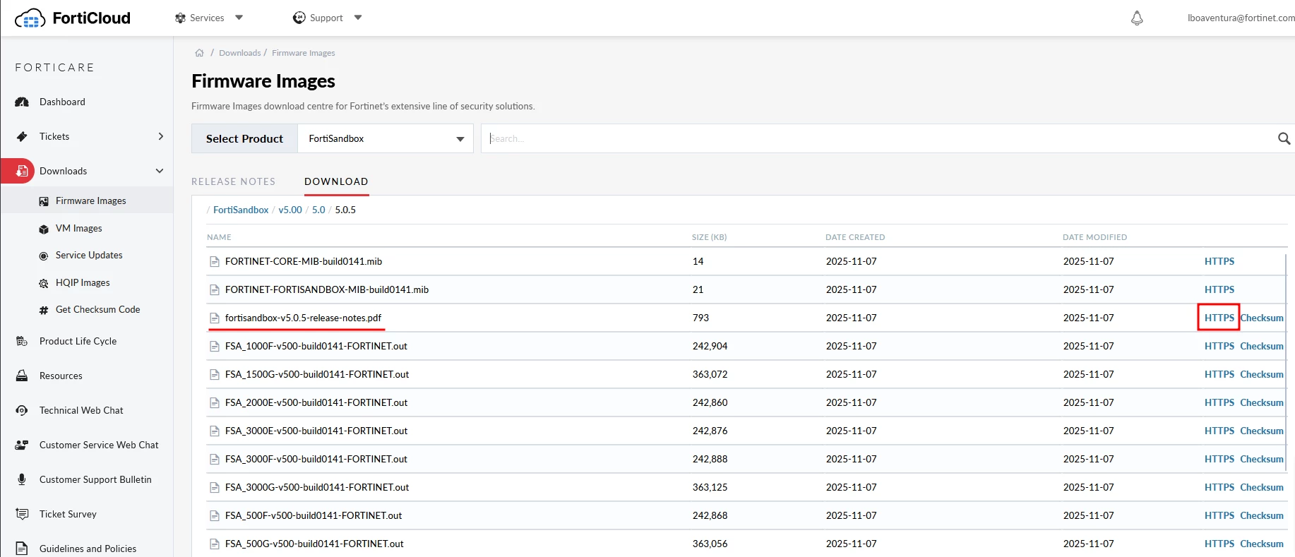

  1. Log in to the Customer Service & Support web portal at Support, and select the 'Download' option, followed by 'Firmware Images'.

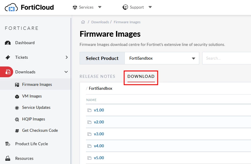

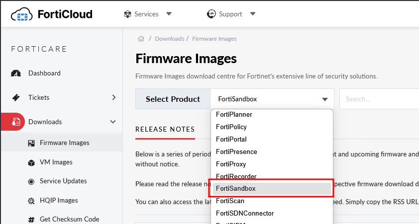

  1. Using the dropdown under 'Select Product' choose the FortiSandbox.
  2. Select the 'Download' tab.
  3. Navigate through the directories to find the preferred firmware version, first selecting the firmware version, then the master release, and then the patch version.

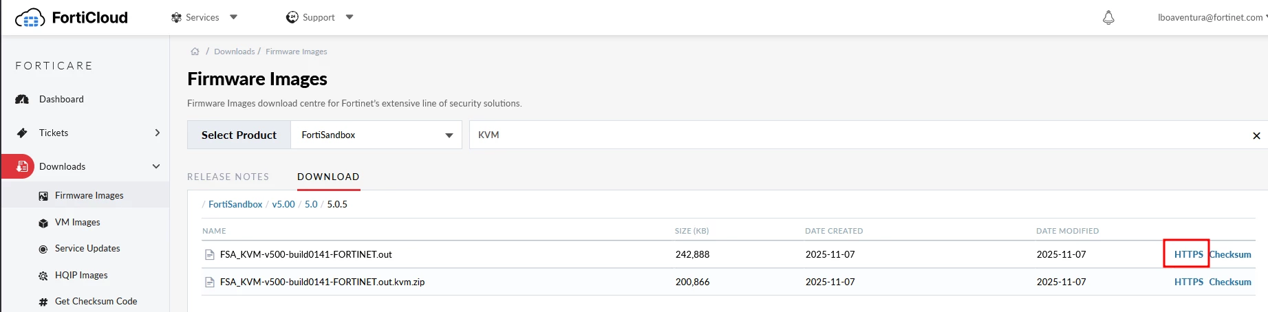

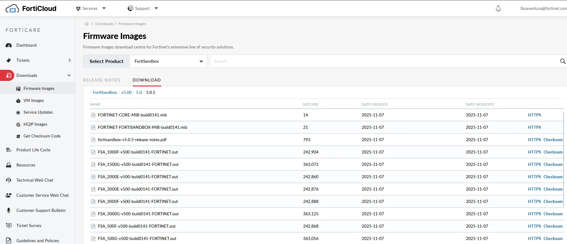

  4. Find the image that corresponds to the VM version or hardware version of the device and select the 'HTTPS' button to the far right.
  5. Find the PDF file listed as 'release-notes' and download it using the HTTPS button.
  6. Review the release notes document for all relevant information (special notes, upgrade details, etc.).
  7. In the release notes in the section listed as 'Upgrade Information', there is the supported
    upgrades available and the upgrade paths.
  8. If there is an upgrade path, use the above-listed steps to download the other images and release notes.

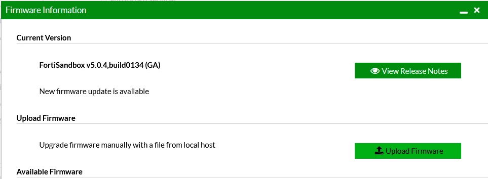

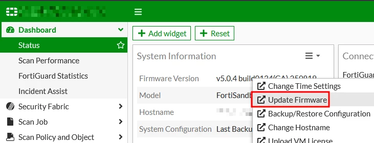

  1. Log in to FortiSandbox via web UI.
  2. Under the Dashboard in the 'System Information' widget, it should show a line showing the current firmware build with an Update link next to it. Select the Update link.

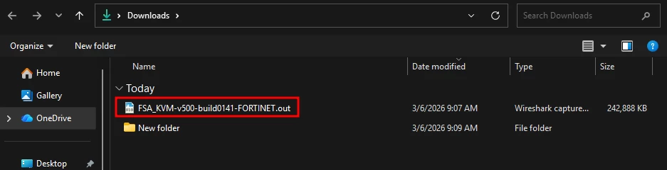

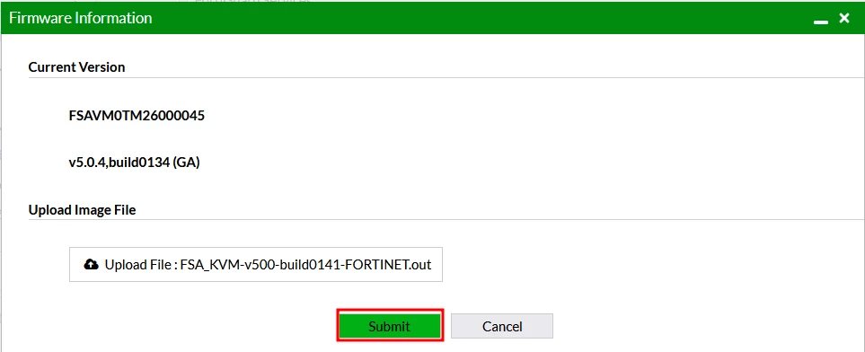

  1. Select the Browse button and find the first image in the upgrade path that is saved on the PC. And select Open.
  2. Select the submit button.

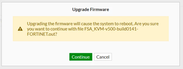

  3. Confirm to upgrade at this point (the device will be out of operation during the upgrade and will reboot).
  4. Eventually, it will be redirected to a new page during the upgrade. Do not navigate away, refresh, or reboot the sandbox during this time.
