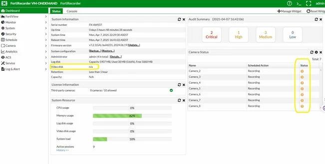

  1. The dashboard shows 'n/a' for the Video disk value, and the camera recording status shows an exclamation mark.

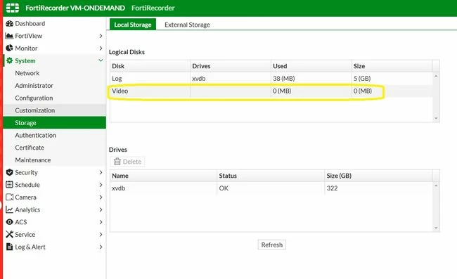

  1. The video logical disk shows a value of '0MB' under System -> Storage -> Local Storage.

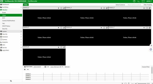

  1. All recordings under Monitor -> Video -> Video show a 'Failure, Please Refresh' message.
Solution:
Run the following command to fix the issue:
execute formatvideodisk
