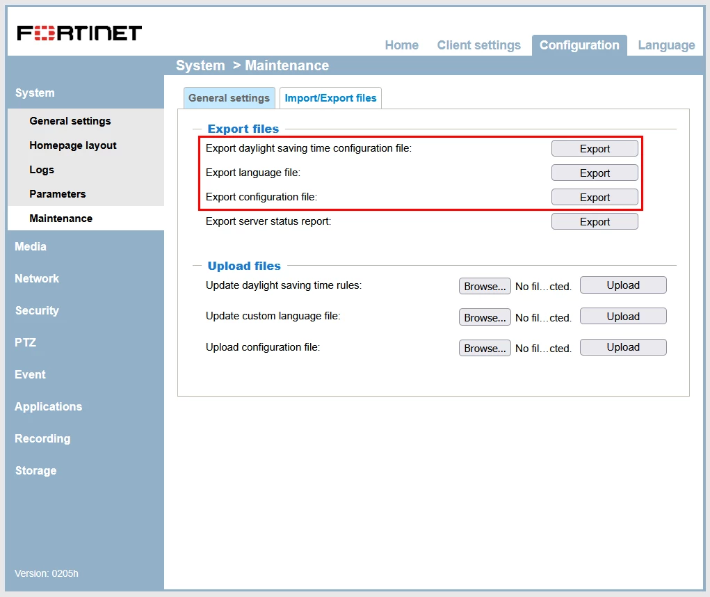

Note: Since the process requires a factory reset, the configurations and custom language files can be exported first if needed. They can be found in the camera's web UI under System -> Maintenance -> Import/Export files:

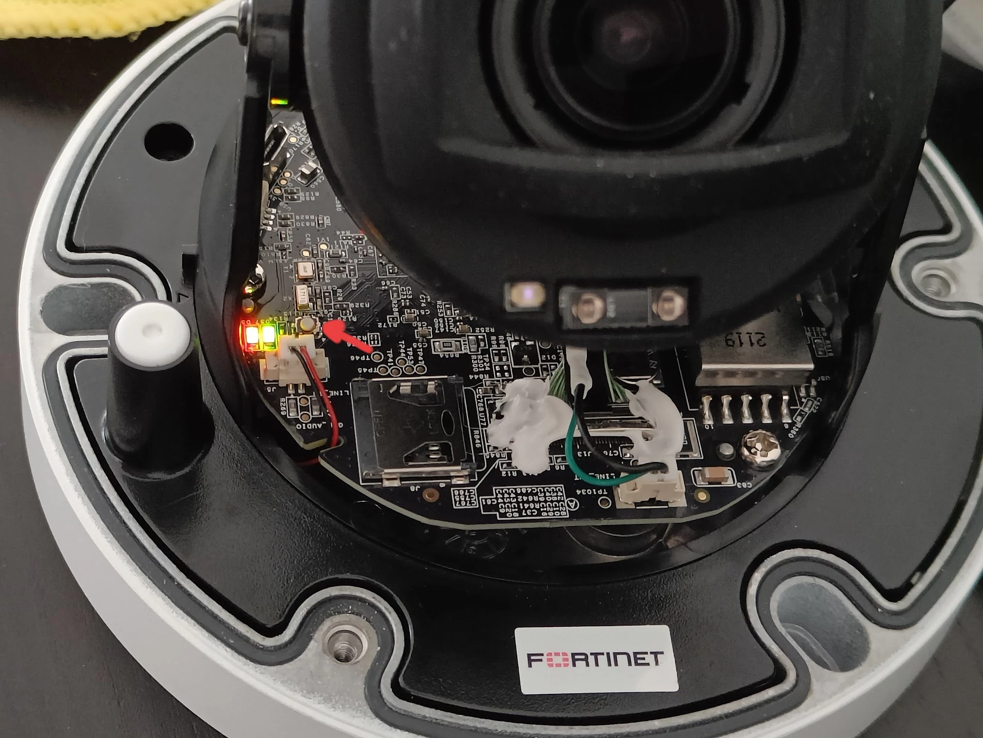

  1. Remove the glass dome using the TX10 Allen key provided with the camera.
  2. With the camera powered on, press and hold the reset button for 10 seconds to factory reset the camera.
    The picture below shows the location of the button:
  3. Once the reset button is released, allow about a minute for the camera to reboot. During the initialization process, the lens should move automatically through its full travel, then start auto-adjusting the focus in small steps.
