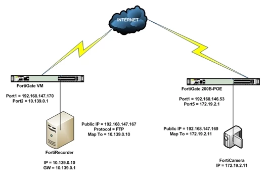

The motion detection is performed by the FortiCamera itself, and it sends the video clips back to the FortiRecorder using FTP protocol.
Ensure that the FortiRecorder side firewall has an FTP port opened in order to allow the FortiCamera to send the motion detection clips. The following network diagram illustrates the setup.

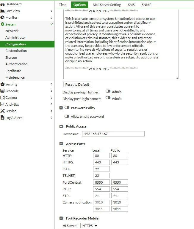

- Go to System -> Configuration -> Options.
- Change the 'Host name' under 'Public Access' to the public IP of the FortiRecorder (this is required to let the FortiCamera know where to upload the video clips) and click 'Apply' to save the changes.

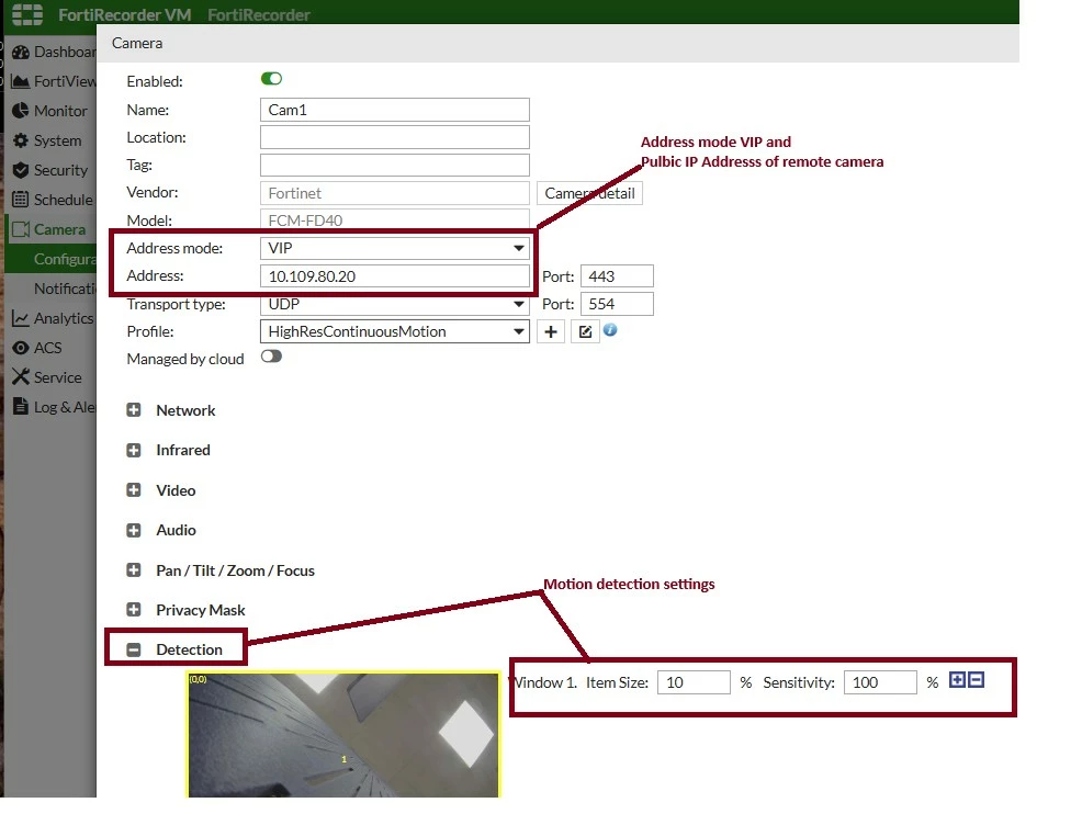

- Add the FortiCamera in the FortiRecorder under Camera -> Configuration.
- Provide name, camera model, and select 'VIP' for address mode. Provide the Public IP of the remote FortiCamera.
- Expand the detection option and under Detection, select '+' on the Monitor Windows.
- Change the value of the 'Sensitivity' to 100 and select 'Create'.
