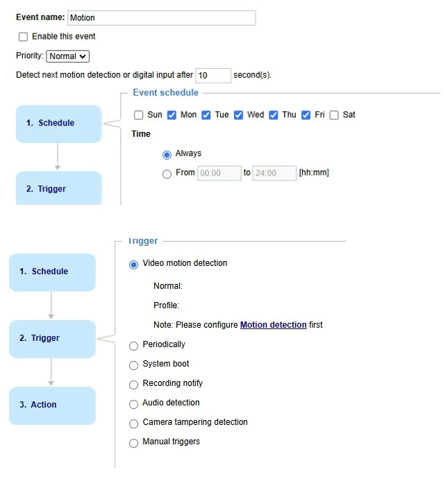

On the FortiCamera configuration settings under Configuration -> Event -> Event settings -> Add event.

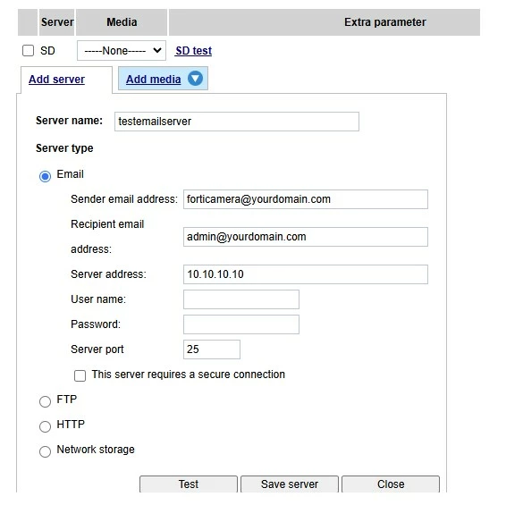

In the action tab, add server can be used, so this way the email server can be configured, once is configured save server

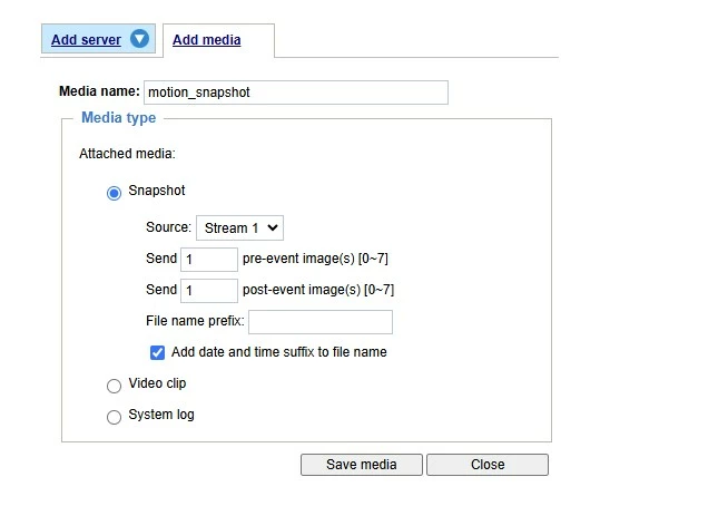

Once the server is added a Media has to be added, where a snapshot/video clip or system log can be used.

Once the media is added, the event can be saved:
By following the steps above emails, should be generated with motion detection snapshots.
