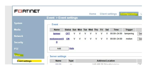

On the FortiCamera configuration settings under Event -> Event settings, a new event can be added.

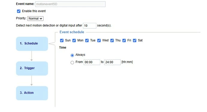

A schedule has to be added when is triggered.

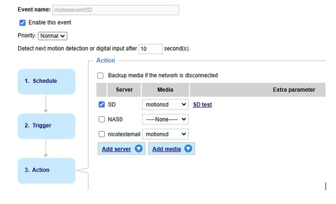

Once this is done, the add media can be used, where it can be a snapshot, video clip or system log, then save.
By using the steps above, the alerts should be stored on the SD card without the usage from the FortiCamera end without the FortiRecorder.
