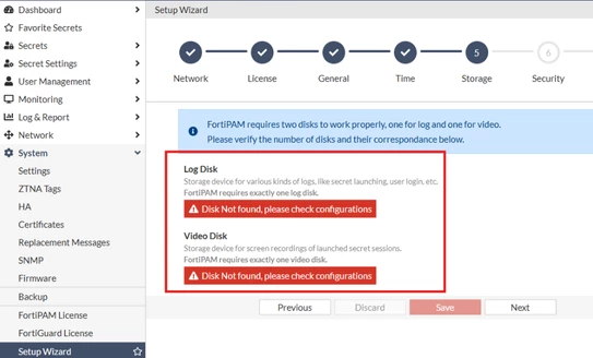

This article describes the error displayed on the FortiPAM hardware model when using the setup wizard.
Scope FortiPAM v1.6.x and FortiPAM v1.7.x.
Run setup wizard for FortiPAM hardware model, such as 3000G, will encounter the following error:
This is a known issue for the FortiPAM hardware model with disk RAID.
This issue will not affect disk usage.
The fix is released on firmware version 1.8.0 and above. To fix the issue, upgrade to firmware version 1.8.0 or above.
