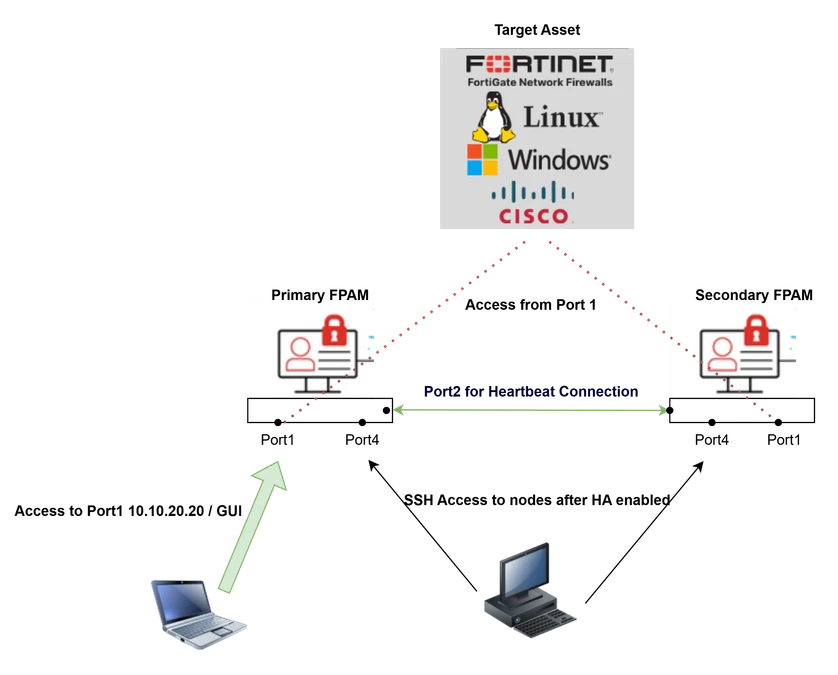

Below is a schema showing how FortiPAM HA cluster nodes are connected.

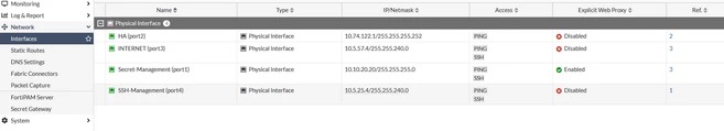

In this article, the primary FortiPAM node has three interfaces configured:
  • Port1 (10.10.20.20) – This interface provides GUI access to FortiPAM. A firewall virtual IP is configured on this interface. Access to secrets is also handled through this interface.
  • Port2 (10.74.122.1) – This interface is used as the heartbeat interface for HA communication. In order for nodes to successfully join the cluster, these interfaces are recommended to be configured within the same broadcast domain.
  • Port4 (10.5.25.4) – This is the management interface, used for SSH access to FortiPAM nodes after synchronization is completed.
Screenshots of Interfaces Configured:

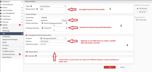

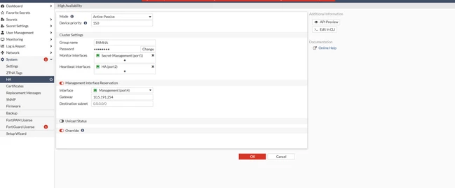

Configuration made on High Availability for the Primary Node:
Mode:
Active-Passive / Device-Priority: 200 (For Primary Node, this priority should be higher than secondary).
Cluster Settings:
  • Group Name: A specific name used for the cluster. This must match on both nodes.
  • Password: The password required for the nodes to join the cluster.
  • Monitored Interfaces: Typically, this is the interface used for launching secrets, targets, and GUI access.
  • Heartbeat Interface: The interface used for heartbeat communication between FortiPAM nodes.
    • If both nodes are in the same network, interfaces should remain within the same IP subnet or pool and the same broadcast domain.
    • If nodes are in different subnets or locations, enable Unicast Status.
      Note: Configuration for Unicast HA is out of scope for this article.
Management Interface Reservations:
This step allows the configuration of interfaces designated for SSH access to FortiPAM.
The interface used for SSH should:
  • Have only the SSH service enabled.
  • Not have GUI access enabled.
  • Not have any static routes associated.
  • Have its gateway defined under the HA settings.
Override:
It is recommended to enable this option.
When enabled, the primary device will automatically resume the master role if it rejoins the cluster after a failure or reboot.

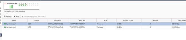

Configurations followed on Secondary Node:
After enabling high availability, the nodes will negotiate to form a cluster. The node with the higher device priority will be designated as the primary node.
Access to the primary node should remain available via:
  • Port1 for GUI access.
  • Port4 for SSH access.
GUI access to the secondary node will no longer be available. Only SSH access, as configured under Management Interface Reservation, will be permitted.

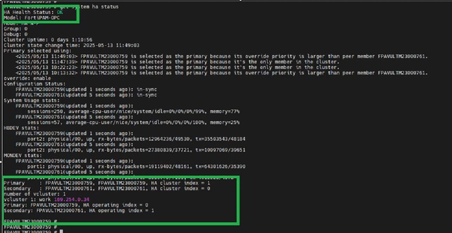

The HA status should reflect a synchronized state as shown below:
  1. Troubleshooting from CLI:
The following commands can assist with verification and troubleshooting of HA status and synchronization:
get system ha status
Verify via System-ARP that Layer-3 HA IPs and Heartbeat Link local addresses (169.254.X) are being learned correctly.
get system arp

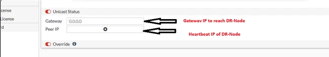

In scenarios where an additional DR node is located at a different site (in a separate broadcast domain), it is important to enable 'Unicast Status' in the High Availability cluster configuration, as shown below:
This can be configured via CLI as well:
config system ha
    set unicast-gateway X.X.X.X
        config unicast-peers
                set peer-ip Y.Y.Y.Y
