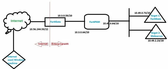

Refer to the diagram below, which shows the enterprise LAN is protected by a FortiGate, and FortiPAM is behind the FortiGate. Users on the internet need to access the targets, as it is first required to connect to FortiPAM.
To configure the above setup, the following steps need to be followed.
FortiPAM uses port 1444 to access targets.
10.56.244.59 is a public IP as per the diagram.
VLAN between FortiGate and FortiPAM is 3
VLAN between FortiPAM and Target is 49
Targets are directly connected to FortiPAM; hence, no gateways are configured.

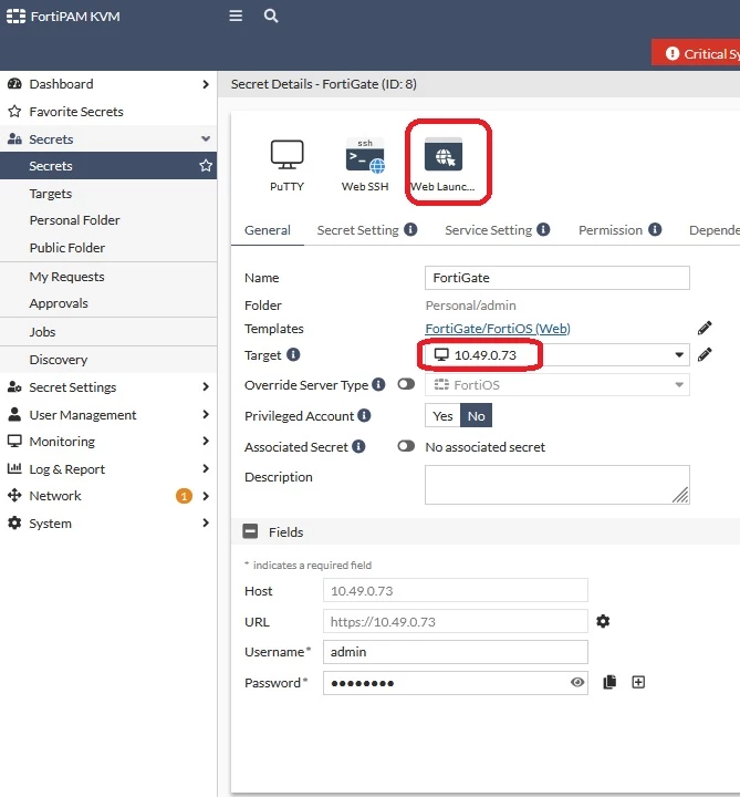

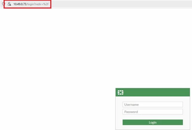

  1. It is possible to access the Targets as follows.
