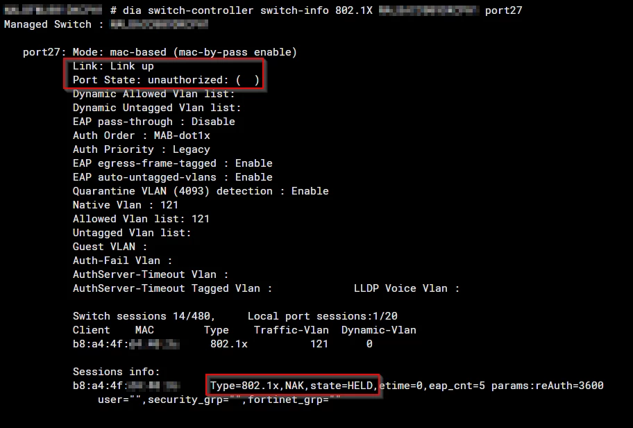

Description This article describes the troubleshooting steps for cameras that are unable to get the correct VLAN from FortiNAC.
Scope FortiNAC-F v7.2.x+, FortiSwitchOS v7.2.3 and above.
When port security is applied, some types of cameras are unable to get a correct VLAN. FortiSwitch port status shows 'unauthorized'.
2025-08-27_19_21_07-FortiGate_-_NALBFWL001DKCPH1_and_11_more_pages_-_Work_-_Microsoft__Edge.png

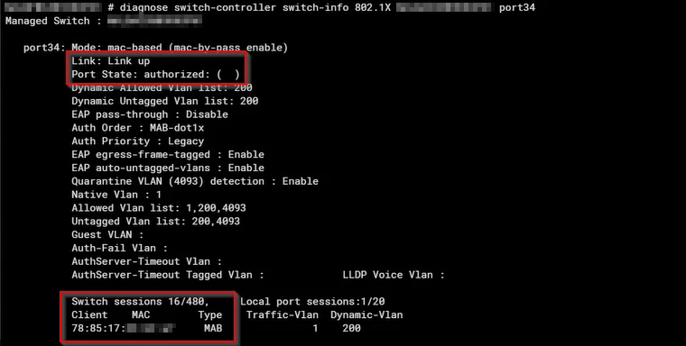

On the other hand, with the same port settings, the port status of the PC shows 'authorized', and the correct VLAN is obtained.
