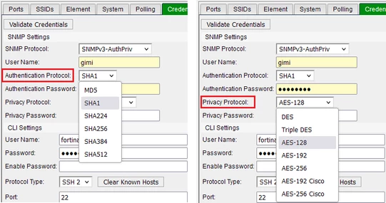

SNMPv3 is used in environments that require a secure network communication. The configuration is more complex compared to SNMPv2 since it offers options to configure an username for authentication and a password for privacy. Since there are different protocols to chose from, sometimes there are compatibility issues between these devices and FortiNAC.

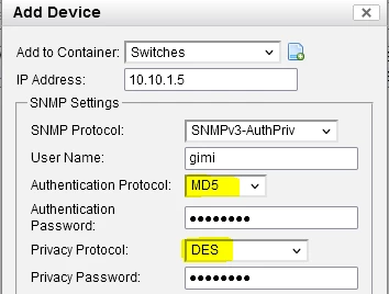

Since the firmware/hardware on this switches may be old, complex protocols may not be compatible. It is suggested to use simple protocols like MD5 for Authentication and DES for privacy in case when other combinations don't work:
Configurations done in the switch:
HP2530(config)# snmpv3 user gimi auth md5 ******** priv des ********​
HP2530(config)# snmpv3 group managerpriv user gimi sec-model ver3​
HP2530(config)# no snmpv3 user initial​
HP2530(config)# show snmpv3 user​
Status and Counters - SNMP v3 Global Configuration Information​
User Name                       Auth. Protocol   Privacy Protocol​
FortiNAC                          MD5               CBC DES
