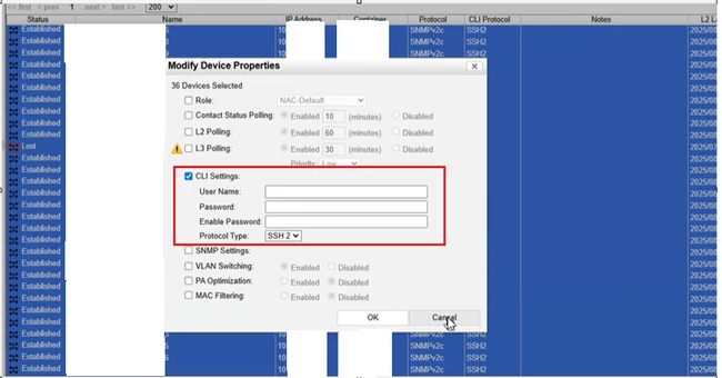

Procedure for Updating CLI Credentials in FortiNAC via GUI:
To update the CLI credentials for multiple network devices in bulk:
  1. Access the FortiNAC web console and navigate to Network → Inventory → Container.
  2. From the list on the right-hand side, select all devices or multiple devices by using CTRL and the left button of the mouse for which the CLI credentials need to be modified.
  3. Right-click on the selected devices and choose 'Modify Device Properties'.
  4. In the CLI Settings section, enter the new CLI credentials.
    Once saved, the updated credentials will be applied to all selected devices simultaneously.
