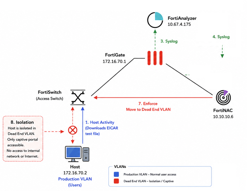

In this scenario, FortiNAC responds to security incidents based on syslog messages received by FortiAnalyzer.
Flow:
  1. The host in a production VLAN attempts to download a virus file or is blocked access to a web page based on a web filter profile.
  2. FortiGate detects the activity through Firewall policies and sends a Syslog message to FortiAnalyzer.
  3. FortiAnalyzer filters for UTM syslog events and sends the message to FortiNAC.
  4. FortiNAC parses the Syslog message, generates a security event and triggers an alarm based on the Security rules.
  5. The alarm action is configured to disable the host.
  6. FortiNAC applies (Technical Tip: 'State based Control' concept and VLAN changes) by changing the VLAN to 'Dead End'.
  7. The host is isolated on the Layer 2 and can only communicate with FortiNAC acting as DHCP and DNS server in 'Dead End' state.

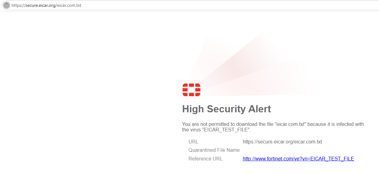

Initially, the host will be blocked to download the infected file. The following shows the web page the end user is presented by FortiGate:

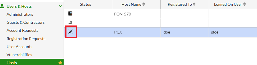

The alarm action is set to disable the host. The following shows the host marked as 'Disabled' and FortiNAC changes the VLAN on the connected port:
