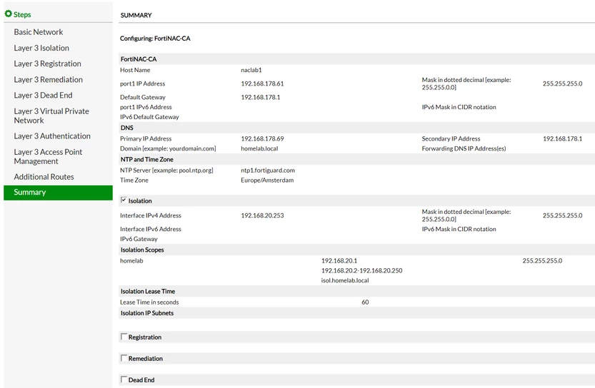

The image below shows a summary of the Config Wizard before being applied:
Figure 1. Configuration Wizard summary.Figure 1. Configuration Wizard summary.

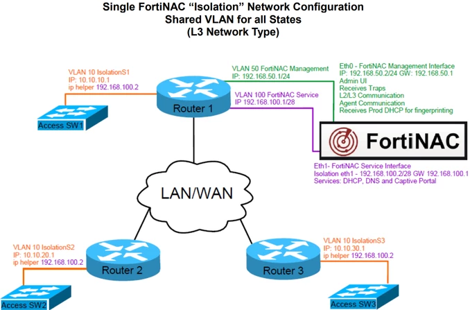

It is recommended to use an L3 Network -> Layer 3 network: Routed Network with multiple scopes for each isolation network.
This way, it will be possible to scale and add Branch office networks when the network expands. FortiNAC is not an Inline solution but can sit on the edge and manage all sites.
The L3 Isolation Network is a shared state that includes all other separate states (registration, remediation ...).
So for a simple deployment, only an isolation network will be required with defined scopes, which FortiNAC can provide with DHCP, DNS, and captive services, depending on the host state. This is known as state-based control.
See the diagram on page 73 of the deployment guide for an example of the necessary configuration.
Figure 2. FortiNAC network configuration example using the shared VLAN state called 'Isolation'.Figure 2. FortiNAC network configuration example using the shared VLAN state called 'Isolation'.
The customer will need to configure at least 2 VLANs/Subnets.
  1. Stub VLAN: this is where the FortiNAC isolation interface resides.
  2. Isolation VLAN: this is where FortiNAC will put Rogue hosts (not profiled hosts) (FortiNAC eth1 IP could also reside in this network).
  • The FortiNAC Eth1 IP address will act as a DHCP and DNS server for all added Isolation subnets.
  • The routed VLAN interfaces in Isolation should be configured through ACL to speak only with Eth1 IP address.
  • All Isolation Subnet gateways in L3 Switches should have an IP-Helper pointing to Eth1 IP address.
  • At this point, FortiNAC will provide Isolated hosts with an IP address from the defined DHCP scope in the L3 Isolation network.
  • Isolated Hosts will be provided an IP configuration with the FortiNAC Eth1 IP address acting as a DNS server.
  • All HTTPS/HTTP requests from these hosts will be filtered to FortiNAC, which presents the captive portal to them for registration/mediation depending on the host state (Rogue/At-Risk).

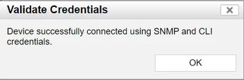

The validate credential button should give the successful results for both the SNMP and the CLI:
Figure 4. Credential Configuration confirmation.Figure 4. Credential Configuration confirmation.
Important: Do not proceed with the next steps if either the CLI or SNMP returns an error or failure. If not configured properly, the customer may experience different issues such as L2/L3 polling not working, being unable to read VLANs, or FortiNAC being unable to change VLANs on the affected switch.

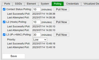

  1. Polling network devices (manually/scheduled).
Manual/scheduled polling can be checked for the respective network device under Network -> Inventory -> Select device -> Polling.
  • Contact Status Polling - This is a ping that FortiNAC performs against the switch to check if it is online.
  • Layer 2 (L2) polling - FortiNAC reads the network device's MAC address table.
  • Layer 3 (L3) polling - FortiNAC reads the network device's ARP table.
Figure 5. FortiNAC polling tab.Figure 5. FortiNAC polling tab.

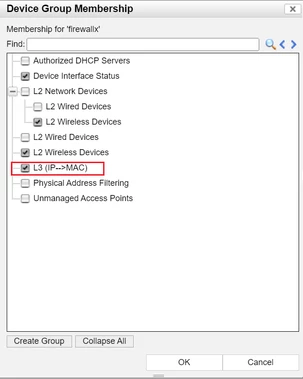

It is also important to verify that L3 devices that are added in FortiNAC will not be automatically included in the L3 polling feature. For Manual/Scheduled L3 polling to appear, the device must be included in the L3 group manually.
'Right-click' the FortiGate device model in Inventory View and select Group Membership.
Figure 7. Group membership for Network Inventory Devices.Figure 7. Group membership for Network Inventory Devices.
Enable the 'L3 (IP->MAC)' group and select OK. After refreshing the GUI, the L3 polling entry will show up in the 'Polling' tab of the modeled device.

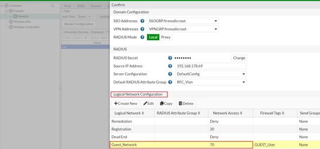

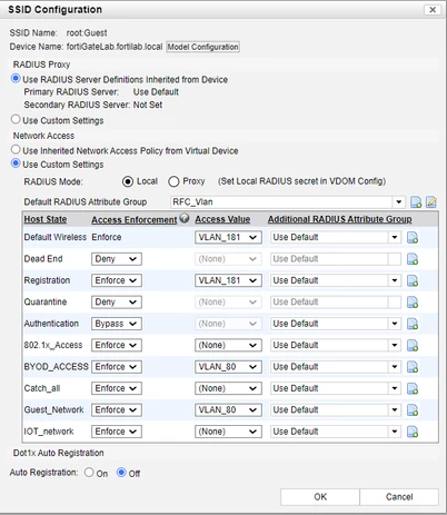

When a customer is using FortiNAC as a local radius or proxy radius, the customer can leverage 802.1x to automatically register hosts by associating them with the logged-in user after successful authentication.

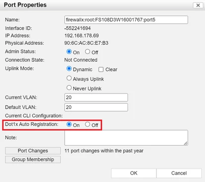

Dot1x auto registration for testing purposes can be enabled on a single port by editing the port properties as shown below:
Figure 8. Dot1.X Auto registration setting for individal port.Figure 8. Dot1.X Auto registration setting for individal port.

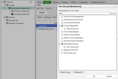

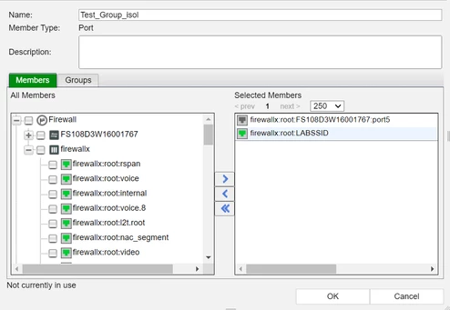

To enable enforcement, the switch ports or SSID where hosts connect must be part of the respective system group. These groups are created by default when FortiNAC is deployed and have specific functions as described.
See system groups in the administration guide for more information.

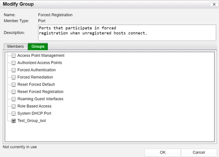

Forced Registration
Host marked with (?)
Ports that participate in forced registration when unregistered hosts connect.
Add switch ports that participate in forced registration when an Unregistered Host connects to the Forced Registration port group. Only ports that participate have their VLAN ID set to the Registration VLAN when an unregistered host connects.

  • Enforcement on Wired Ports.
In the example below, a new port group was created under System -> Settings -> Groups.
Port 5 of the FortiSwitch is included in this group.
Figure 9. Custom group membership for Wired ports.Figure 9. Custom group membership for Wired ports.
After, apply the forced registration on all members of the Test_Group_isol by making it a member of the forced registration system group.
Under System -> Settings -> Groups, edit the forced registration and select the test group to make it part of 'Forced Registration'.
Figure 10. Add custom groups to the 'Forced Registration' system group.Figure 10. Add custom groups to the 'Forced Registration' system group.
This way, new ports can be added as members to 'Test_Group_Isol', and all of them will be treated with the same enforcement when the group is added to other system groups.

To have state-based control applied, apply group membership on the SSID itself where hosts will be connecting.
In Network -> Inventory -> Select WLC/Device -> Select the SSID tab and 'right-click' the SSID by selecting group membership.
Figure 11. Enforcement for SSID objects.Figure 11. Enforcement for SSID objects.
In this case, the SSID 'Guest' has been added to the Forced Registration and 'Role based Access' system groups. This way, wireless-connected hosts will be initially isolated and be forced to register based on any method preferred and then have VLAN access dynamically changed based on their role after being registered/classified by FortiNAC.
Additionally, by modifying the 'GUEST' SSID configuration, it is possible to apply a unique configuration independent from the base model configuration of the FortiGate.
This configuration takes precedence over the base model configuration.
Figure 12. SSID Configuration tab.Figure 12. SSID Configuration tab.
As seen in the entered configuration, a RADIUS Server inherited from the base model config of the FortiGate root VDOM is currently being used, but a custom Logical network configuration for Network Access is also in use.
In another SSID, it is possible to use a completely different RADIUS configuration and Access VLANs for the same logical networks.
This allows great flexibility in enforcing control by using the same logical network names for different locations: Enforcement Groups.

Configure Logical network in Network -> Logical networks.
Logical networks
Define Logical network access Value in the model configuration.
In this case, a logical network has been added in the FortiGate model configuration under Virtualized devices -> 'root' VDOM (see logical networks).
The Access Value VLAN 70 was assigned. At this point, hosts matching the respective policy that has the 'Guest_Network' logical configuration will be moved to VLAN 70.
Figure 13. Logical Network Configuration in the model config.Figure 13. Logical Network Configuration in the model config.
