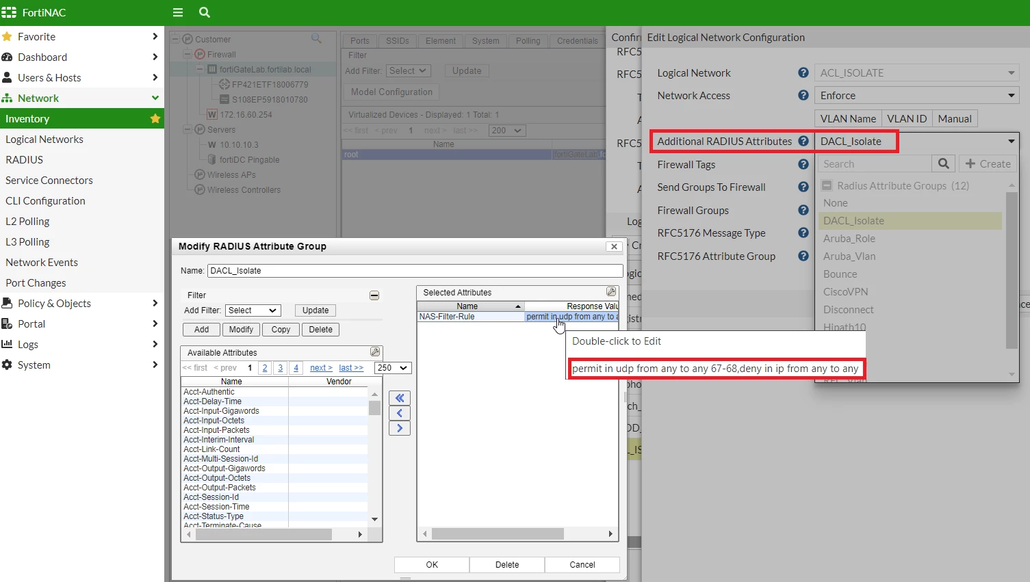

First, it is necessary to create a RADIUS Attribute Group entry for the DACL.
These are the ACLs that FortiNAC will return with RADIUS Accept-Accept once the session is reauthenticated successfully.
Go to Network -> RADIUS -> Attribute Groups (or edit an already created Attribute Group from the FortiGate model config).
Create a new entry with the ACLs separated by a comma ','.
Figure 1. Configuring the Radius Attribute Group entry for NAS-Filter-Rule and ACL paramteres.Figure 1. Configuring the Radius Attribute Group entry for NAS-Filter-Rule and ACL paramteres.

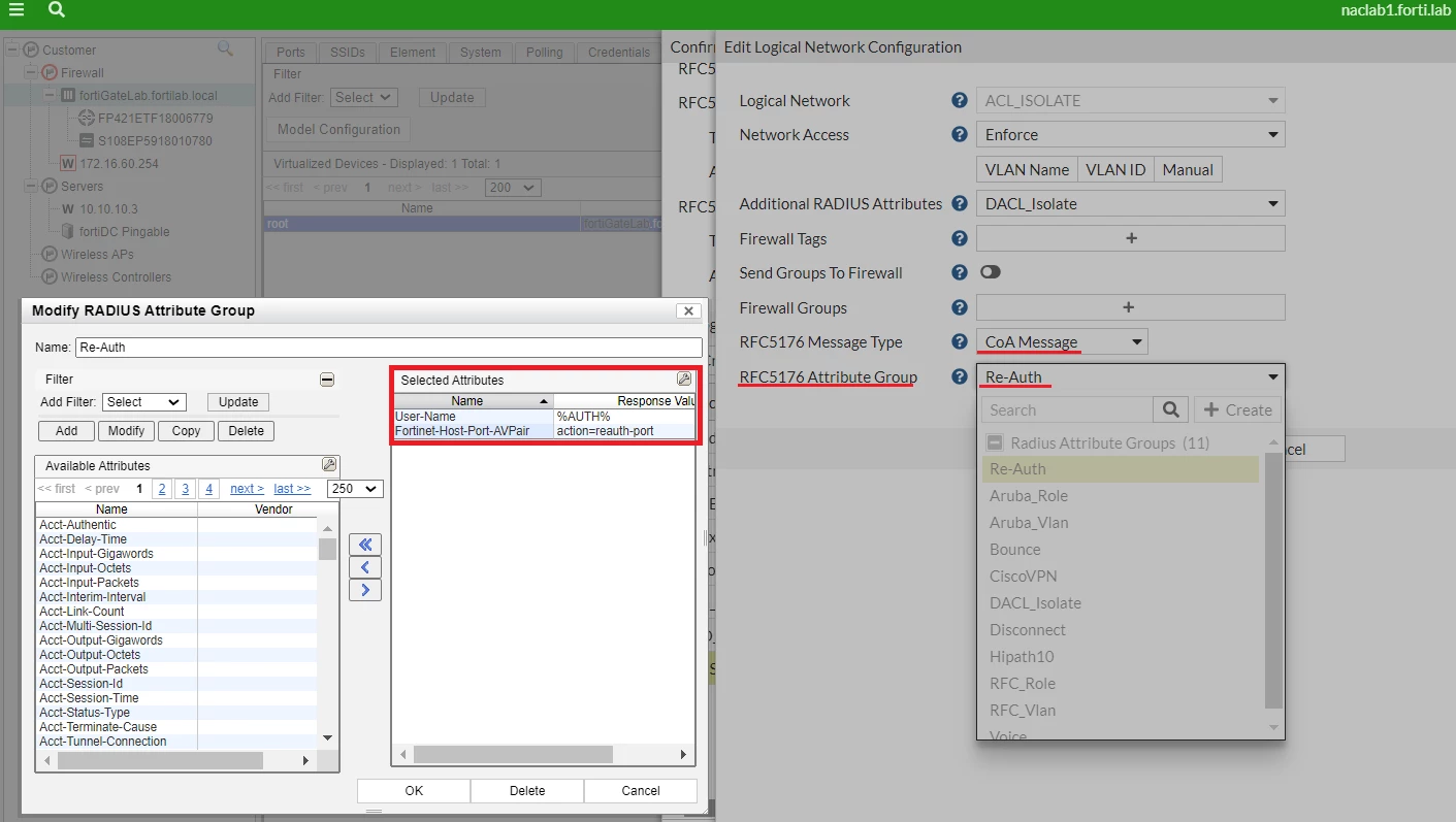

After that, create a RADIUS Attribute Group entry for the CoA Message to dynamically reauthenticate the user session.
Go to Network -> RADIUS -> Attribute Groups (or edit an already created Attribute Group entry from the FortiGate model config on the matching logical network that the NAC policy will apply).
In this test, the Host will apply the Logical network 'ACL_ISOLATE' after changing its role. FortiNAC will then build the CoA message from the Logical network configuration (RFC5176 Attribute Group) to reauthenticate the session.
Figure 2. Configure CoA Message attributes for user session reauthentication.Figure 2. Configure CoA Message attributes for user session reauthentication.

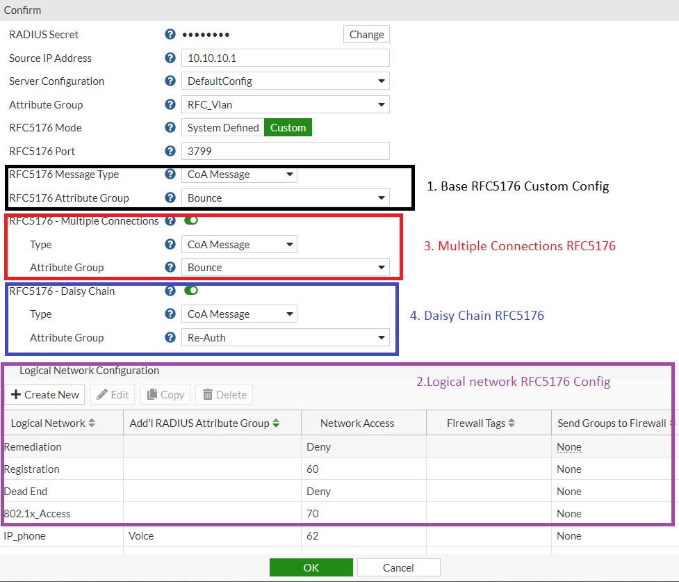

(Optional) CoA Configuration and FortiNAC logic when generating the CoA message.
RFC5176 support in FortiNAC includes some additional configuration options for multiple connections and daisy chain connections.
There are 4 configuration options.
  1. Base RFC5176 Custom Config - Applies in case FortiNAC detects only 1 host on the port.
  2. Logical network RFC5176 Config - Applies in case FortiNAC detects only 1 host on the port, and that host matches the respective logical configuration. This will override (1. Base RFC5176 Custom Config).
  3. Multiple Connections RFC5176 - Applies in case FortiNAC detects more than 1 Host on the port, and that host is not registered as a default IP phone type.
  4. Daisy Chain RFC5176 -  Applies when FortiNAC detects more than 1 Host on the port, and that host is registered as a default IP phone type.
Figure 3. GUI visualization of the RFC5176 configuration options.Figure 3. GUI visualization of the RFC5176 configuration options.

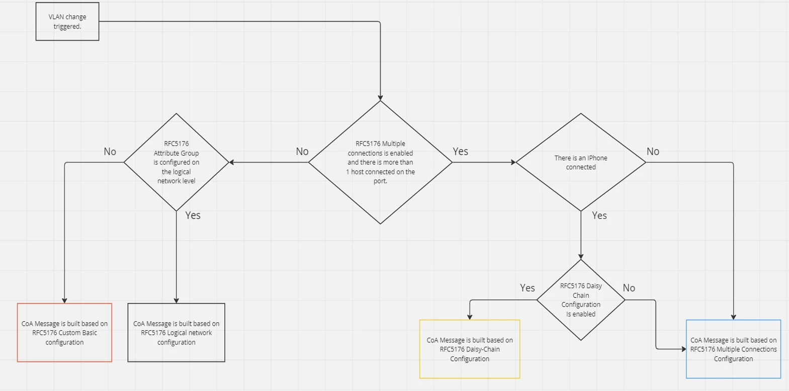

When FortiNAC sees a need for a VLAN change for a particular host, it will re-evaluate the Policies and apply the new logical configuration.
It will then build the CoA Message to change user session authorization.
The logic FortiNAC uses can be described by the diagram below:
Figure 4. Logic used by FNAC to build the CoA message when RFC5176 Mode = Custom.Figure 4. Logic used by FNAC to build the CoA message when RFC5176 Mode = Custom.

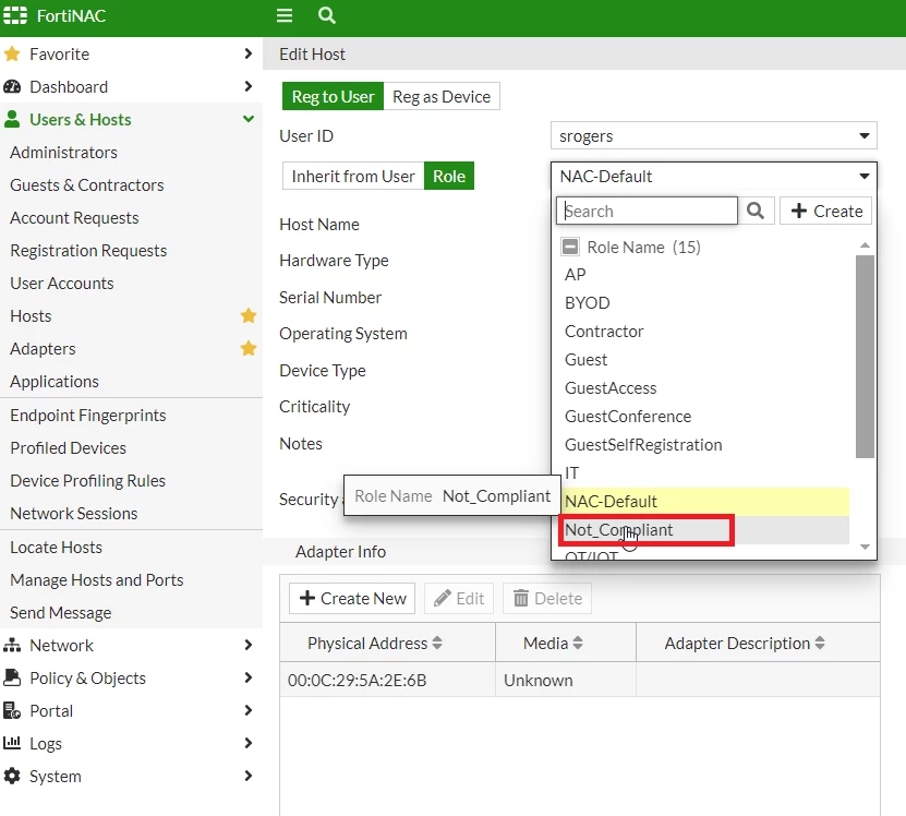

To validate the results, trigger a host posture change by manually modifying the Host Role in FortiNAC GUI:
This will trigger a VLAN change and policy re-evaluation. The Host will match the new Policy, which applies the Logical Configuration containing the RFC5176 Attribute for the CoA message 'Re-Auth' and the Radius Attribute group for 'DACL'.
Figure 5. Manually changing the Host role to trigger a user session reauthentication.Figure 5. Manually changing the Host role to trigger a user session reauthentication.

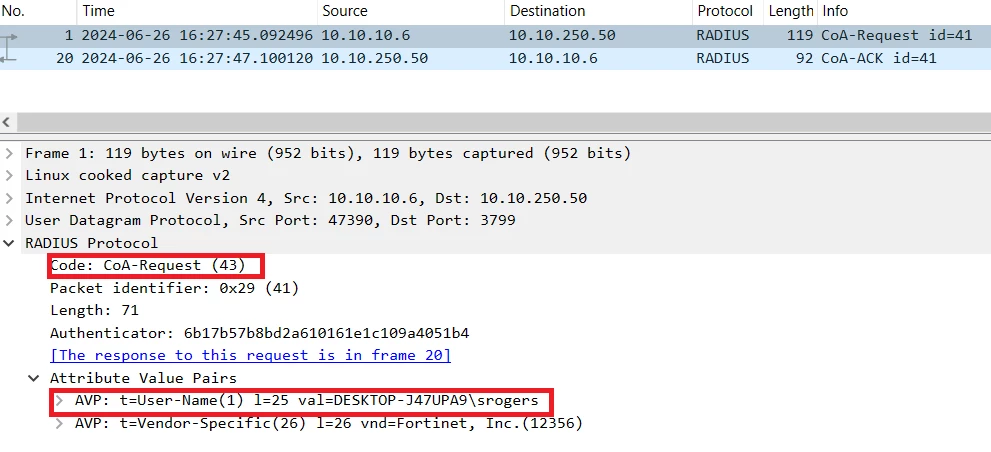

FortiNAC will send the CoA Message to which the Switch responds with CoA ACK while at the same time reauthenticating the user session:
Figure 6. CoA Message exchange for the user session in Wireshark.Figure 6. CoA Message exchange for the user session in Wireshark.

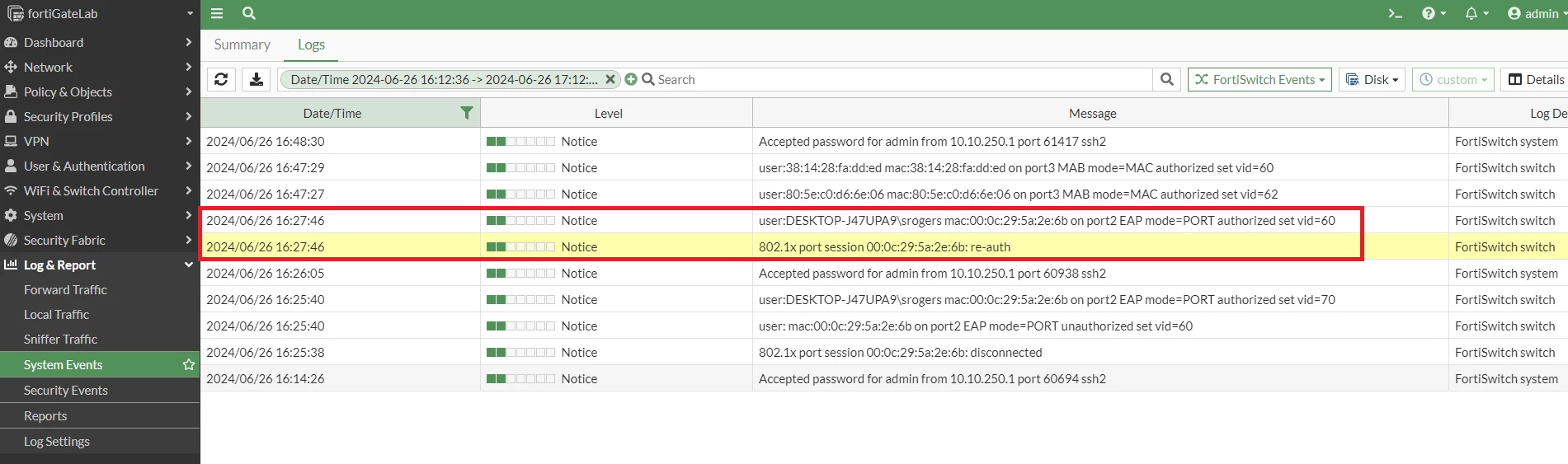

In FortiGate Log & Report -> FortiSwitch events, it is possible to see the following Notice level log:
Figure 7. FortiGate Log events related to FortiSwitch port changes.Figure 7. FortiGate Log events related to FortiSwitch port changes.

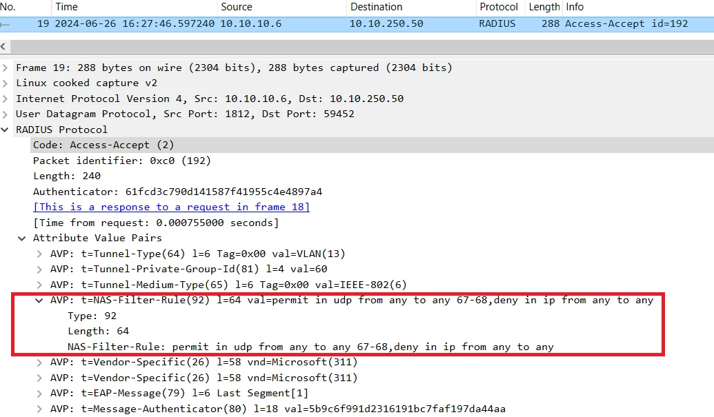

FortiNAC evaluates the new authentication attempt and responds in the RADIUS Accept-Accept with the following attributes containing the ACLs:
Figure 8. FortiNAC sends DACL through RADIUS Accept-Accept after successful user reauthentication.Figure 8. FortiNAC sends DACL through RADIUS Accept-Accept after successful user reauthentication.

  • When multiple hosts are connected on the same port, the RFC5176 Logical network configuration is ignored.
  • RFC5176 logical network configuration is not appended to the RFC5176 base configuration.
