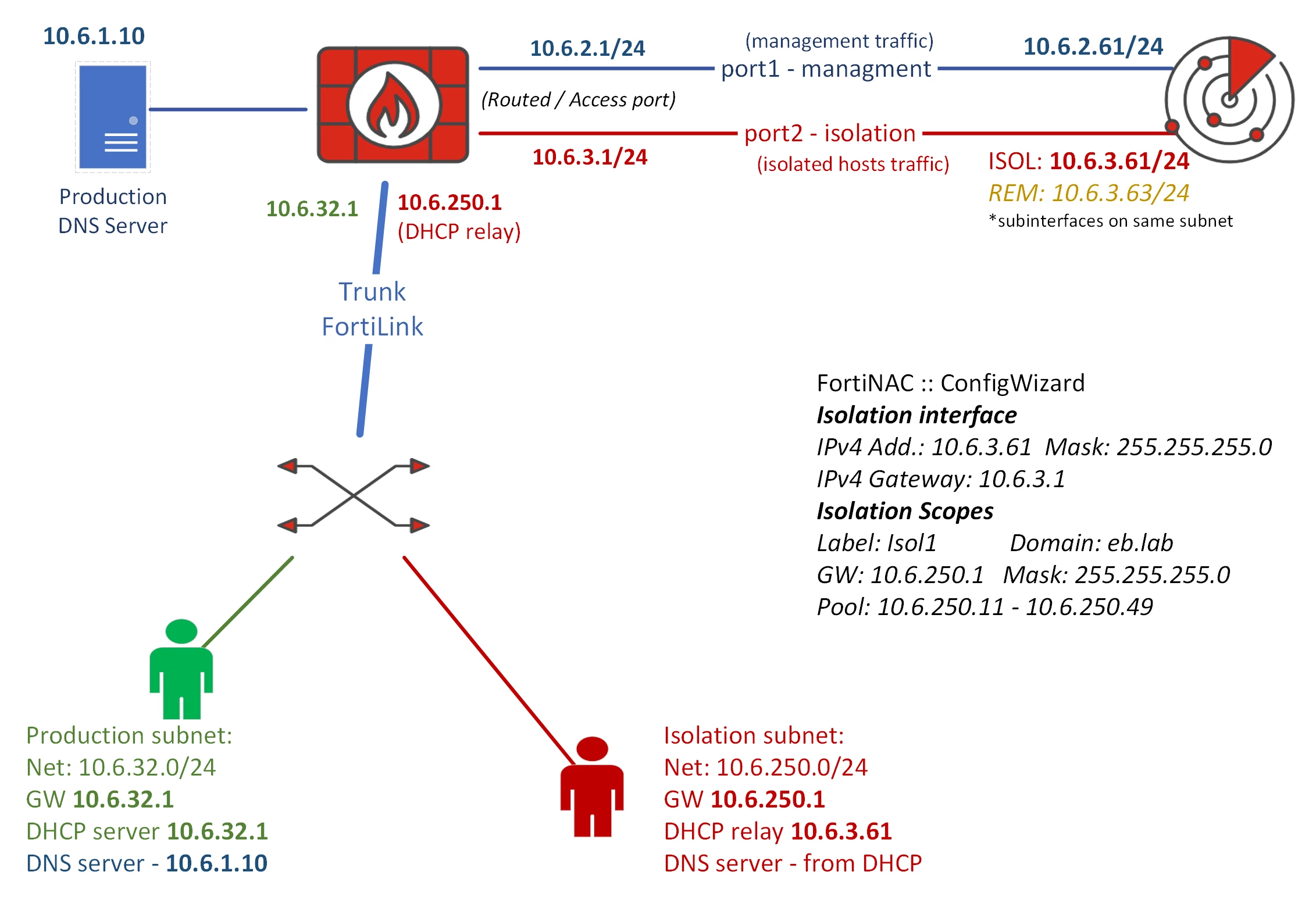

Below is an example of a network diagram when FortiNAC is deployed as an L3 routed (recommended and most used type):

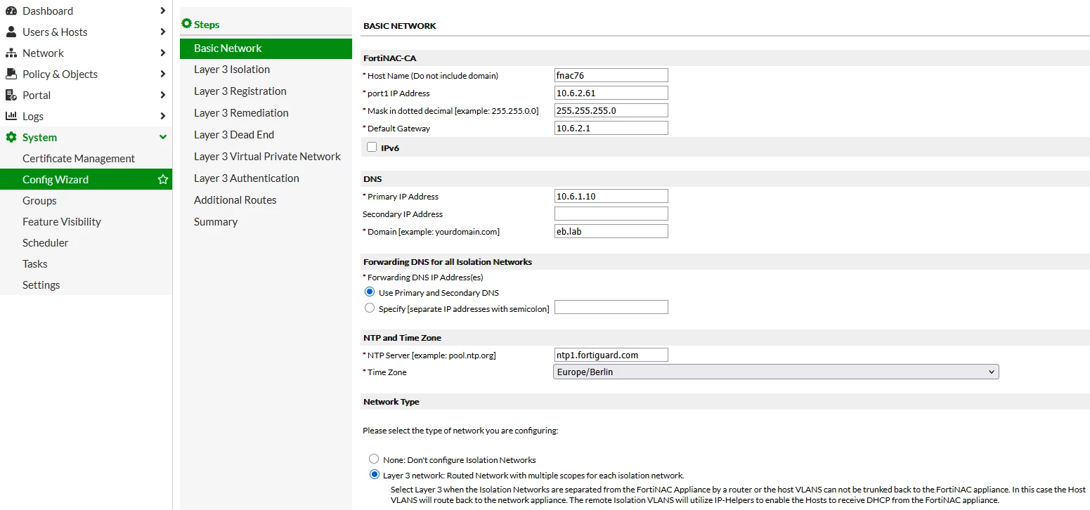

FortiNAC can apply these network configurations by following the configuration steps in ConfigWizard:
  1. Configuring port1 (management interface):

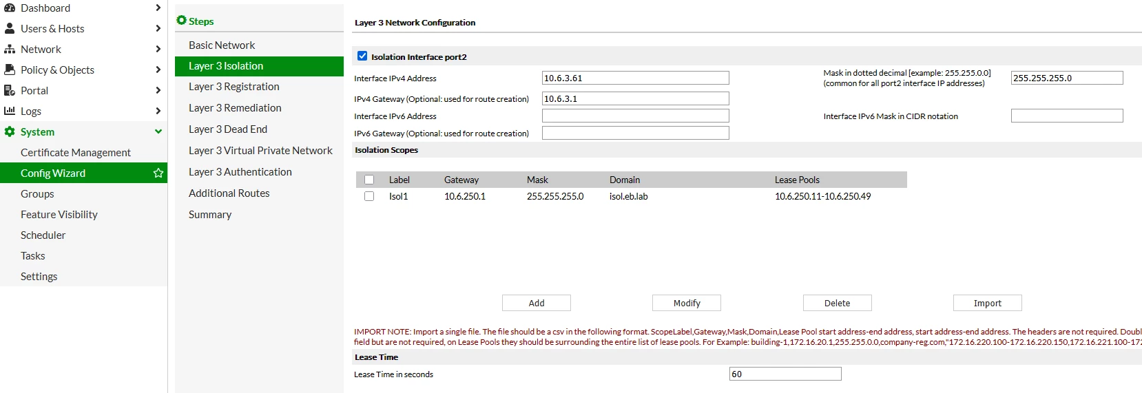

  2. Configuring port2 (isolation interface) and DHCP pools with network details for isolation networks. In smaller setups, to simplify the configuration, only the Layer 3 Isolation can be configured to handle all types of isolated hosts. In larger setups, using a dedicated remediation network may be required.

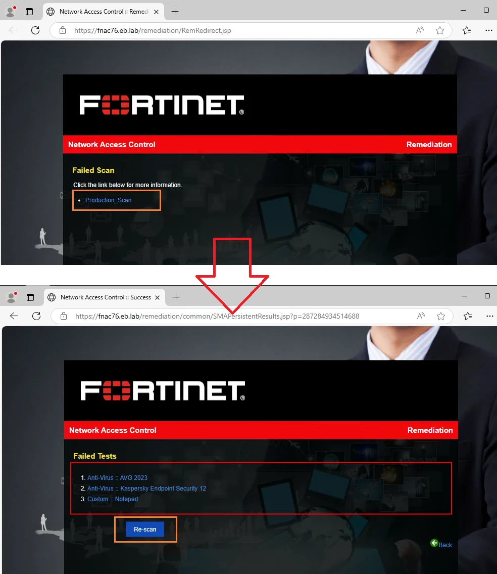

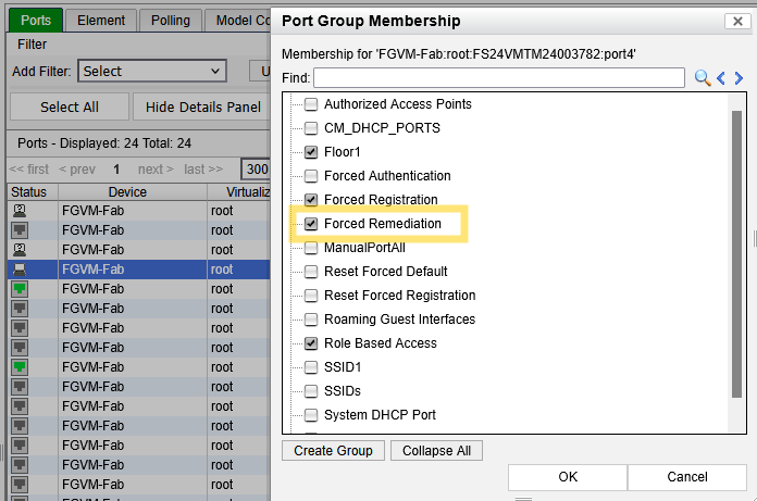

When 'Forced Remediation' is enforced on the port where the host connects, any host identified as At-Risk will be automatically placed on the quarantine network.
After the host is moved to the isolation network, the end user will be presented with a portal page, showing the reason for the isolation, the parts of the Scan that are failing, instructions to follow (optional), and a button to trigger a rescan of the system after the conditions are met. Typically, the remediation steps may require Operating System or Antivirus updates, specific configurations, or processes running/not running on the end host.

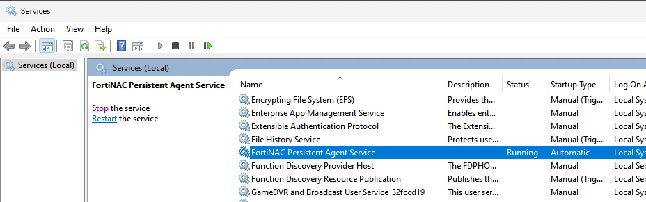

  1. Service status.
Verify that the service is running under the name 'FortiNAC Persistent Agent Service'. The service can also be restarted each time there is a configuration change to speed up the communication process:

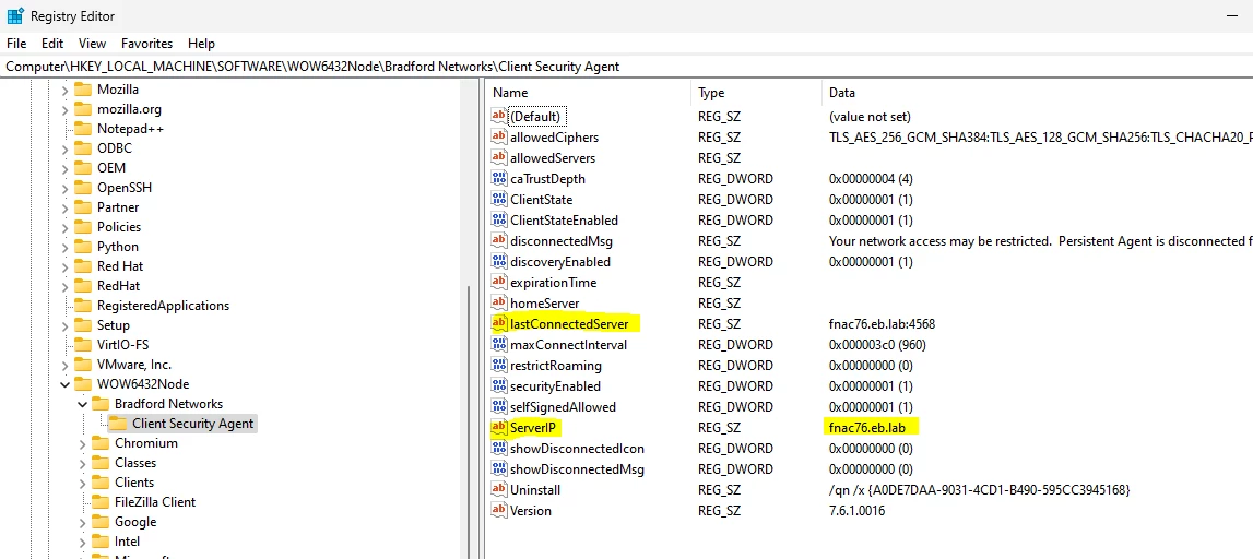

Check the registry editor on the end host and verify that the 'ServerIP' and 'lastConnectedServer' are showing the right values. Make sure that the end host can resolve the domain to an IP, and there is no network limitation (routing or firewall) that blocks the connection (TCP port 4568) to FortiNAC. The path is:
Computer\HKEY_LOCAL_MACHINE\SOFTWARE\WOW6432Node\Bradford Networks\Client Security Agent
Computer\HKEY_LOCAL_MACHINE\SOFTWARE\WOW6432Node\Policies\Bradford Networks\Persistent Agent

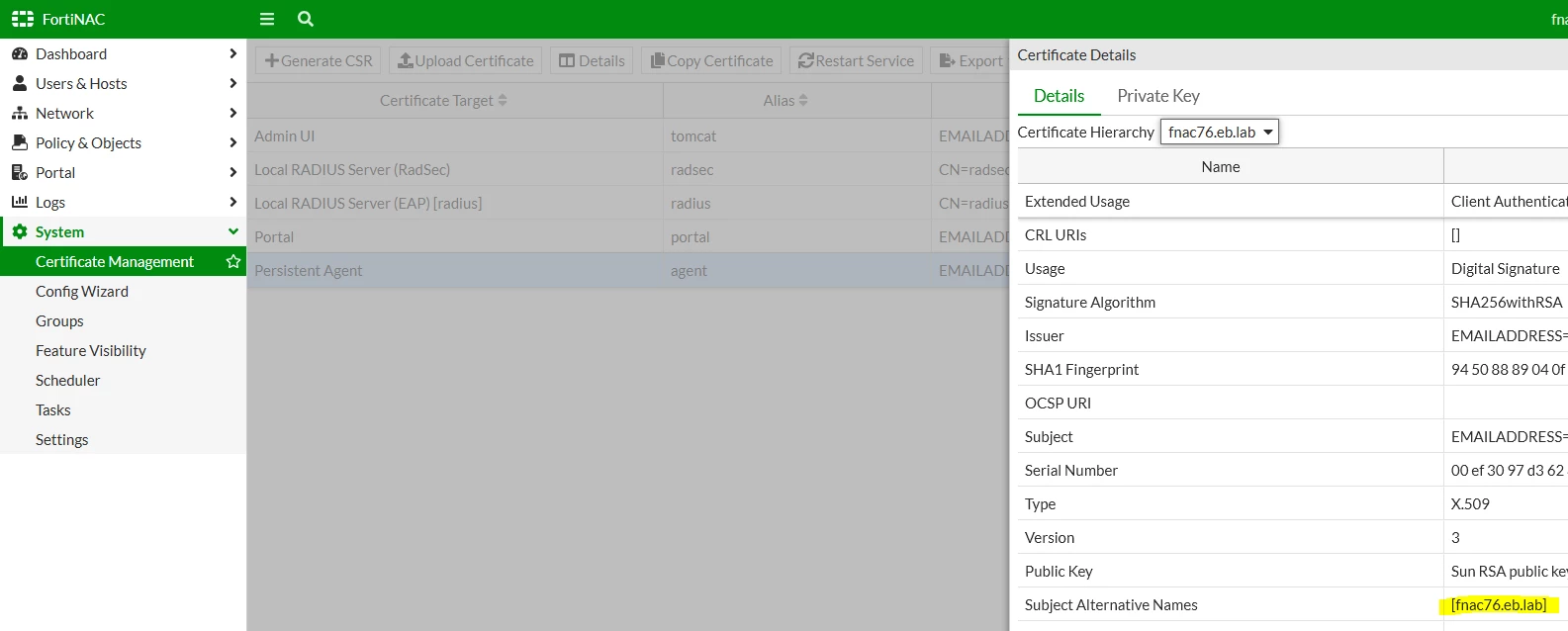

A valid certificate needs to be applied for the Agent service in FortiNAC. Using the built-in self-signed certificate is not supported; some details are shown in the SSL certificates of the Administration Guide. Usually, a certificate generated from a private CA is sufficient as long as the end host has that root CA in their Trusted Root CA Store. In case the trust chain includes other intermediate CAs, those need to be uploaded together with the certificate. The trust chain can be checked in the 'Certificate Hierarchy' drop-down field:
More details on how to troubleshoot certificate issues are shown in this article: Technical Tip: Persistent Agent fails to communicate with 'SSL_get_verify_result' log entry.
