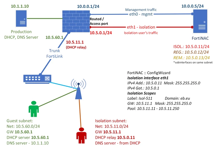

  1. Network design and IP planning.
Below is the example of deploying FortiNAC as a L3 Routed (recommended and most used type):
More details and requirements for this network schema can be found here: Technical Tip: An example of a simple network deployment of FortiNAC with FortiGate/FortiSwitch. Remember to allow the needed services (DHCP/DNS/HTTP/S) at the interface level configuration for port 2 as shown below (in the FortiNAC CLI):

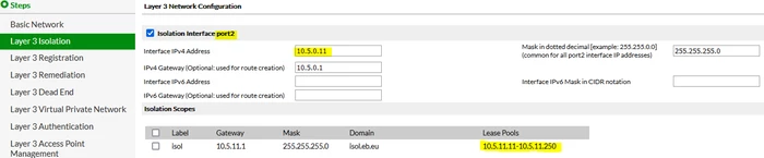

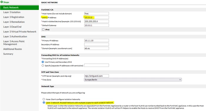

FortiNAC can apply these network configurations when following the ConfigWizard:
  1. Configuring port1 (management interface):
  2. Configuring port2 (isolation interface) and DHCP pools with network details for isolation networks. In smaller setups to simplify the configuration only the Layer 3 isolation can be configured to handle all types of isolated hosts:

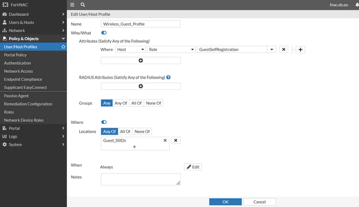

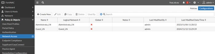

Configuring the logical network, the User/Host Profile and a Network Access Policy for the guest hosts that will be created.
The User/Host Profile may contain multiple options that are used as filters. In this example it will be set to check only the Host role (GuestSelfRegistration) and the hosts that are connected to a specific location (interested SSIDs):
The logical network is used to tie the Network Access policy with different physical network configuration for each network device. This way it allows same policy to have a different result that is significant only for that network device in the Model Configuration tab (details in the first picture of step 2).

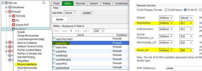

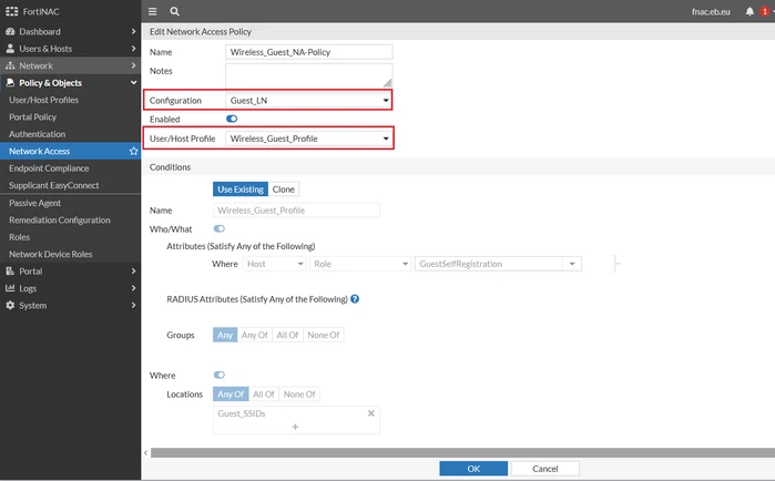

The Network Access policy:

After adding a new FortiAP or making other changes like adding SSIDs or VLAN interface to the FortiGate, resynchronization is needed. 'Right-click' on the FortiGate and select 'Resync Interfaces'. Make sure that all of the SSIDs are listed. In model configuration (Virtualized Devices), the VLANs need to be tied to the isolation/logical network.

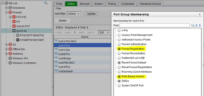

Group membership at the SSID level to enforce Registration and VLAN assignments through access policies:

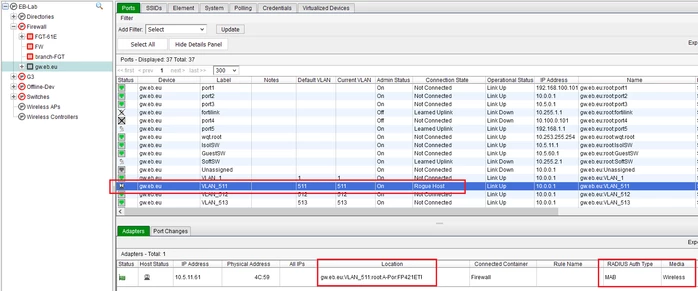

When a host connects to the SSID and the host is unknown to FortiNAC (Rogue), it will be put in an isolation VLAN:

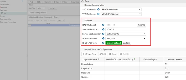

In the Virtualized Devices tab, it is necessary to configure the RADIUS secret, Source IP (NAS IP/Source in FortiGate) and other details:

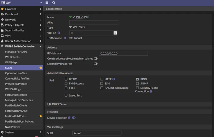

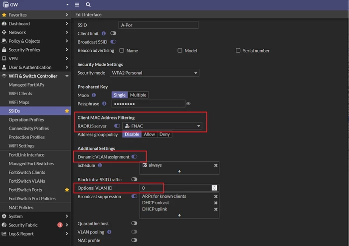

In this example, only guest solution is covered. It can use an Open or PSK-protected SSID with 'Client MAC Address Filtering' and use FortiNAC as a RADIUS server. Since the FortiAP is managed by FortiGate, all the configurations are done in FortiGate only.
Creating the SSID (Tunnel mode) without specifying any IP configuration or DHCP scope:
Continue with SSID configuration while paying attention to the highlights:
Security Mode can be Open or WPA2 Personal, the later will require from the user to know the PSK in advance before proceeding with self registration. If the Open mode is missing in the dropdown, it can be enabled under Feature Visibility, Wireless Open Security.

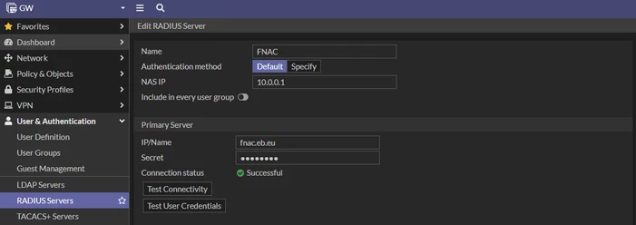

FortiNAC needs to be configured as a RADIUS server in FortiGate and the same shared secret and NAS IP need to also be used in FortiNAC:

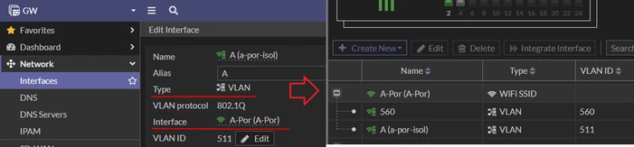

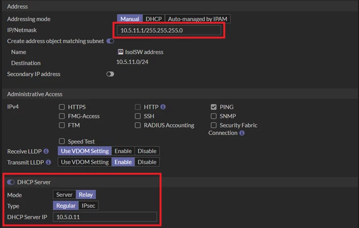

Both the isolation and guest VLAN need to be created as VLAN interfaces under the SSID in FortiGate, VLAN ID must match with the ones configured in FortiNAC:
The guest interface should be configured like a common interface with local DHCP and network access. The isolation interface IP configurations should match with the configuration in FortiNAC shown before and the DHCP should be configured as Relay to send the requests to the isolation interface of FortiNAC:
A firewall policy is required in FortiGate to allow the end host to reach the isolation interface of FortiNAC for DHCP, DNS, and HTTP/S services.

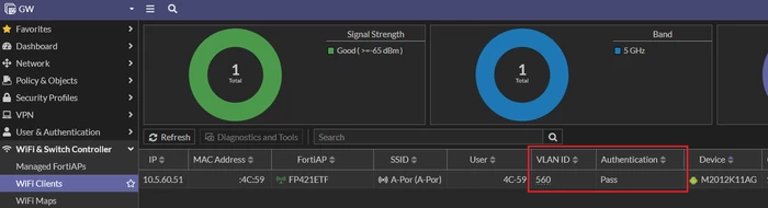

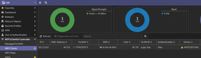

It is possible to verify also from the FortiGate that the host is residing on the isolation VLAN (make sure to include the VLAN ID column):

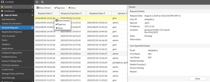

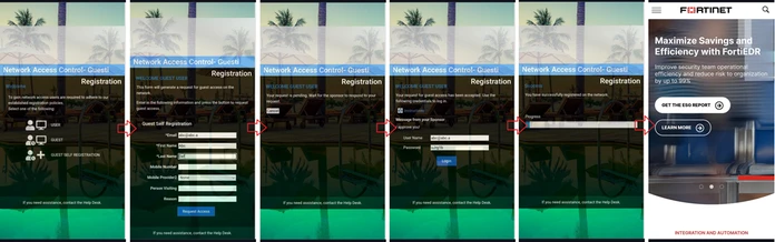

This is a summary of the steps followed by the end host (Android smartphone):
By default, the progress bar is displayed for 45 seconds. It encourages the user to wait and should provide enough time for the network changes to occur in the background. This timer and other related values can be customized as needed in Portal -> Portal Configuration -> Registration -> Success in the field 'Please Wait Message'.
Approval from FortiNAC:
Verifying from the FortiGate that the host is authenticated and is residing in the right VLAN:

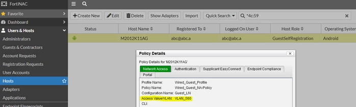

  • A Network Access Policy does not match in FortiNAC. Check UHP, logical network, model configuration, or other possible misconfigurations. The policy that should match can be easily checked by 'right-clicking' in the host and selecting 'Policy Details':
