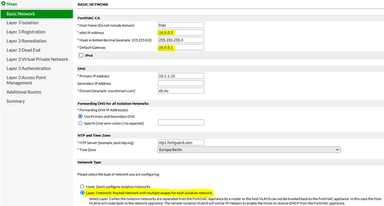

FortiNAC will apply these network configurations while following the ConfigWizard steps:
  1. Configuring eth0/port1 (management interface):

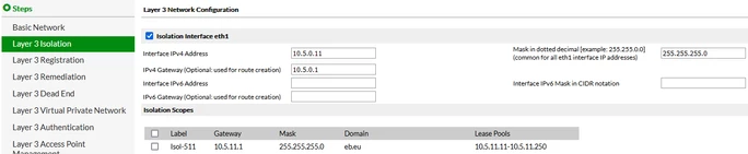

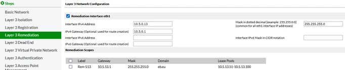

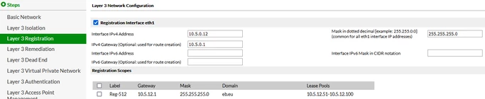

  2. Configuring eth1/port2 (isolation interface) and DHCP pools with network details for isolations networks:
    ISOL:
    REG:
    REM:

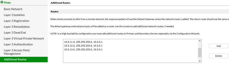

  3. Routes for these isolation networks (DHCP pools) are automatically created and can be checked in Additional Routes section:

And the routes:
> ip route
default via 10.0.0.1 dev eth0
10.0.0.0/24 dev eth0 proto kernel scope link src 10.0.0.5
10.5.0.0/24 dev eth1 proto kernel scope link src 10.5.0.11
10.5.11.0/24 via 10.5.0.1 dev eth1
10.5.12.0/24 via 10.5.0.1 dev eth1
10.5.13.0/24 via 10.5.0.1 dev eth1

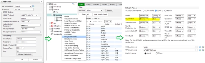

  1. Adding FortiGate in FortiNAC:
After adding a switch to FortiGate or making other changes like adding VLAN interface resynchronization is needed, 'right-click' on the FortiGate and 'Resync Interfaces'. In model configuration (Virtualized Devices) the VLANs need to be tied to the isolation network:

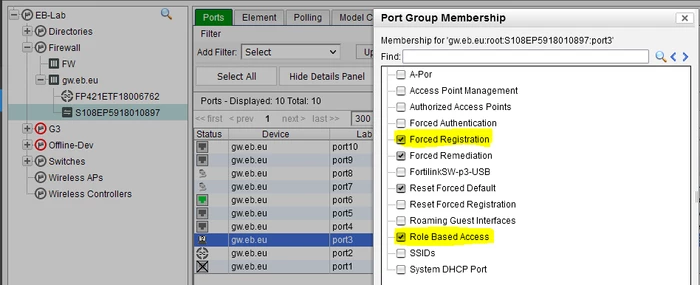

Group membership at the port level to enforce Registration and VLAN assignments:

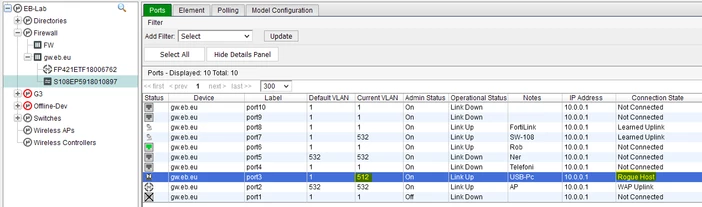

When a host connects to the switch in port3 and the host is unknown to FortiNAC (Rogue) it will be put in registration VLAN:

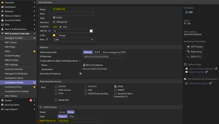

Configuring the isolation VLAN in FortiGate for the managed Switch (port5 is the FortiLink port in this setup):
In order for the portal redirection to occur smoothly, the DHCP server must be configured as a relay.
Here, it is possible to see that FortiNAC has enforced Registration VLAN (512) on the switch port (as Native) when an unknown device is connected to that port:
A firewall policy needs to be created to allow communications with FortiNAC eth1/port2 interface only and block other access.

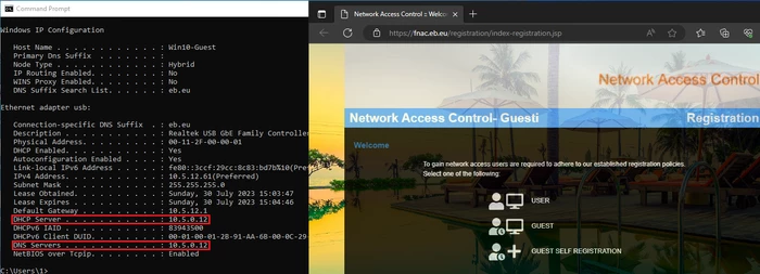

Here is shown the screen of the Guest host: '> ipconfig /all' output and browser page redirection (done via DNS) to the Registration portal page: 

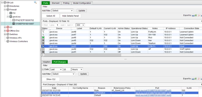

After successful login the host is redirected to the Guest VLAN (enforced by FortiNAC) and the port of the switch is bounced to trigger an IP release on the end host:
The host will now receive an IP from VLAN 560, and the browser will be redirected to the custom success page.

Port changes history as seen from FortiNAC, from Default to Registration and Guest VLAN:
