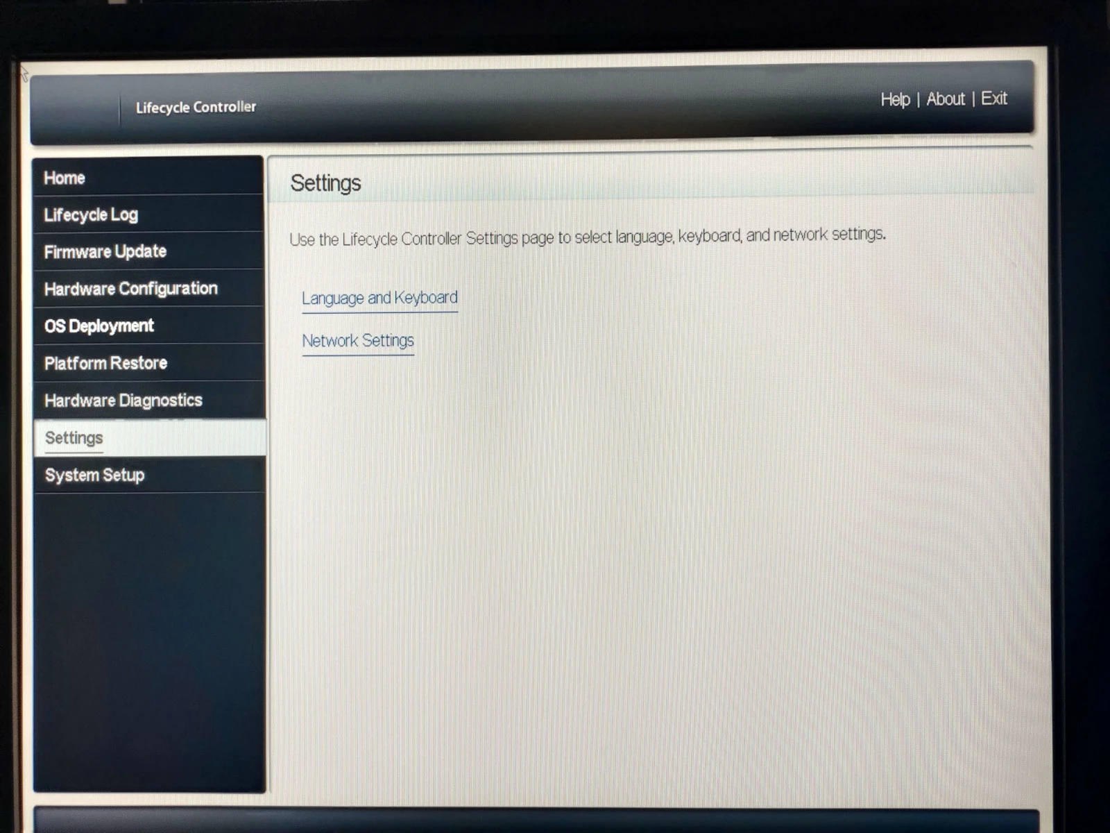

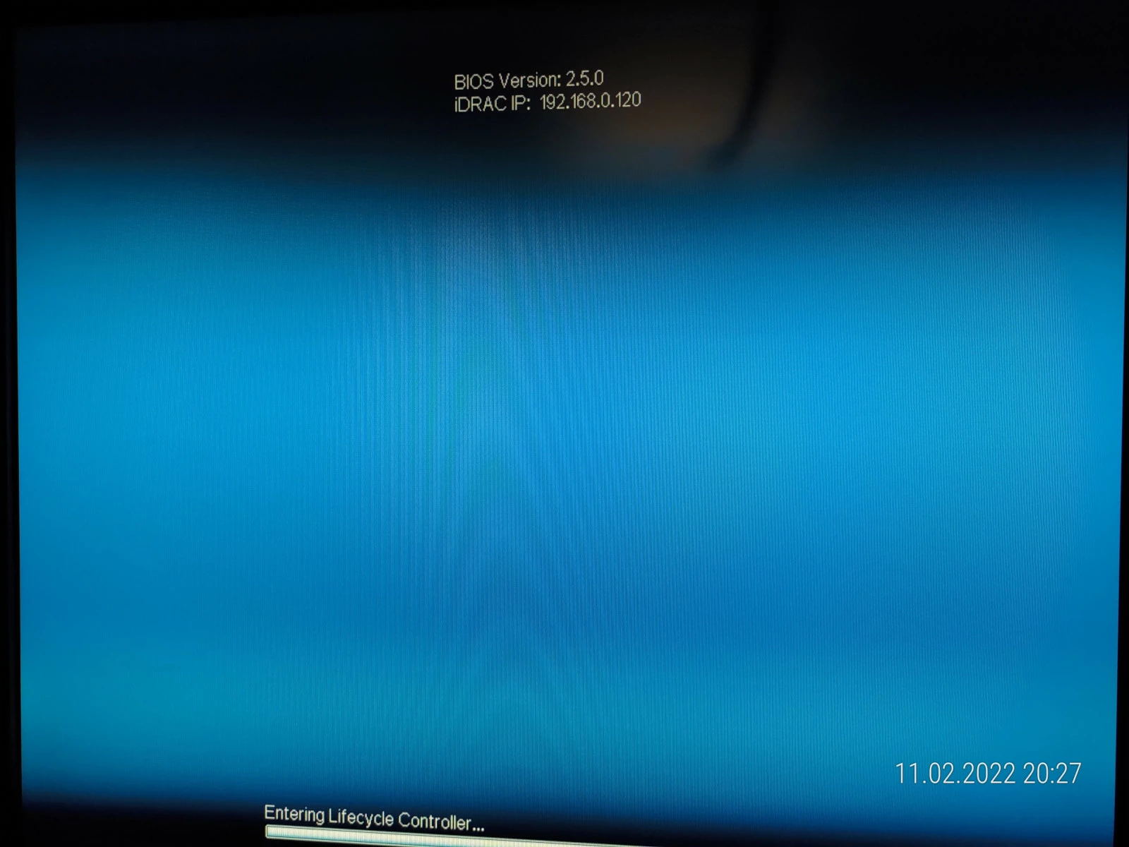

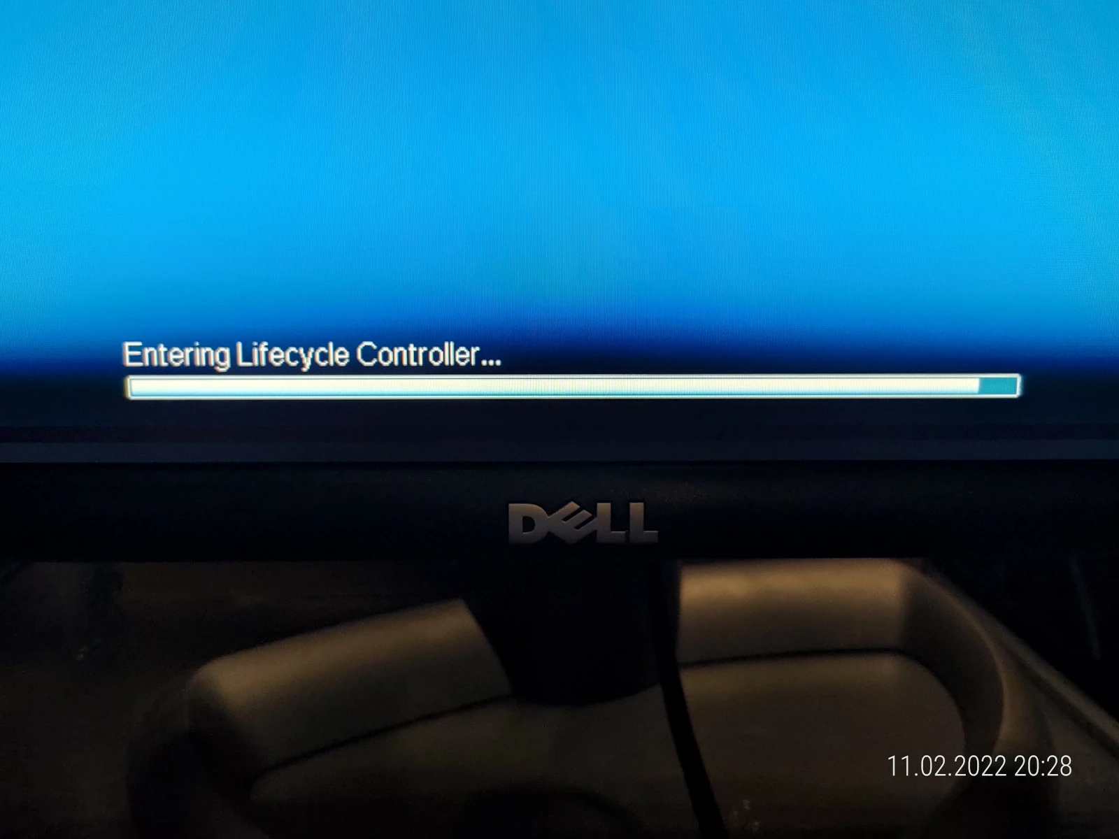

1) entering the setup, displays the firmware version:
2) It will take a little time.

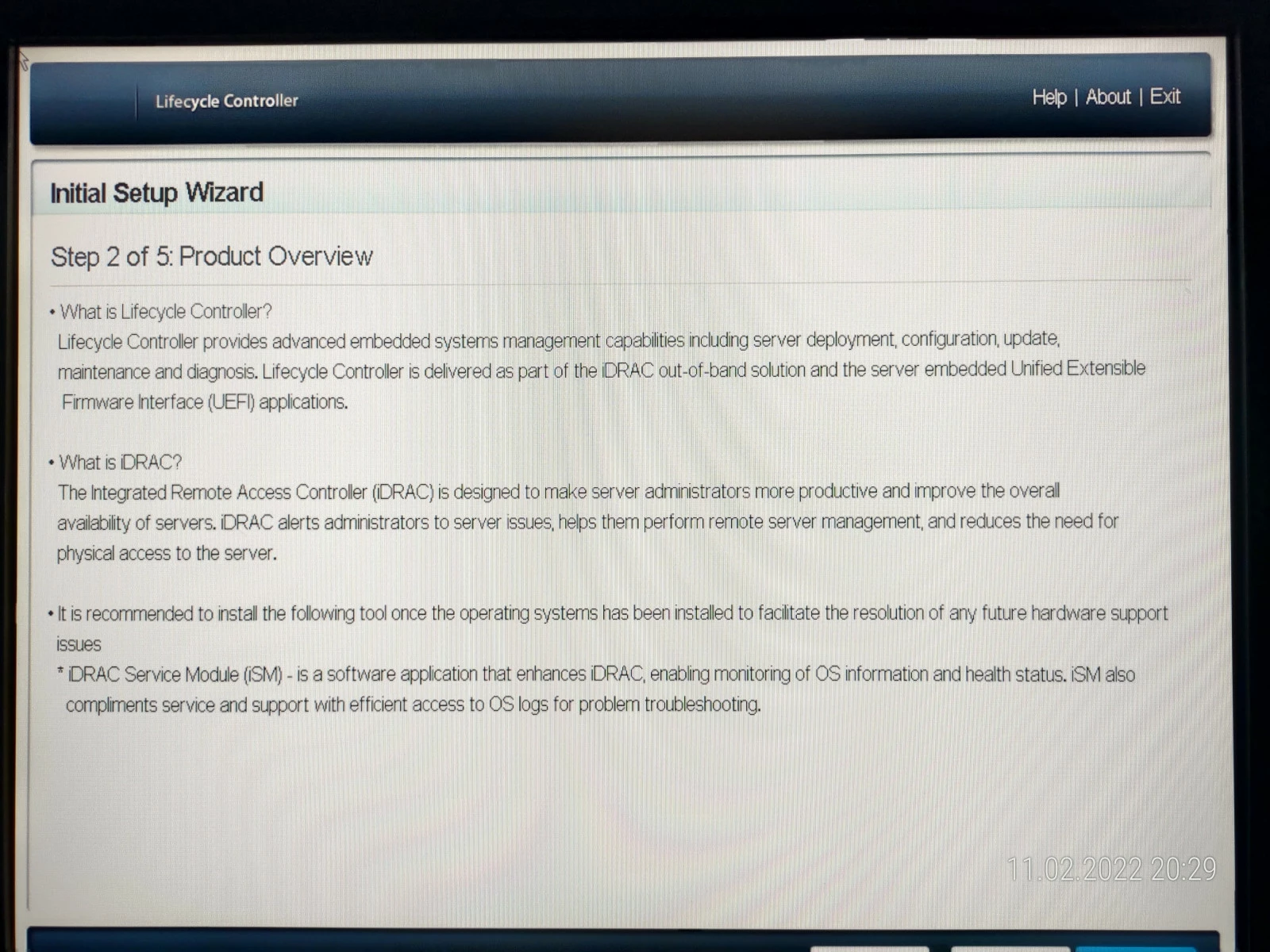

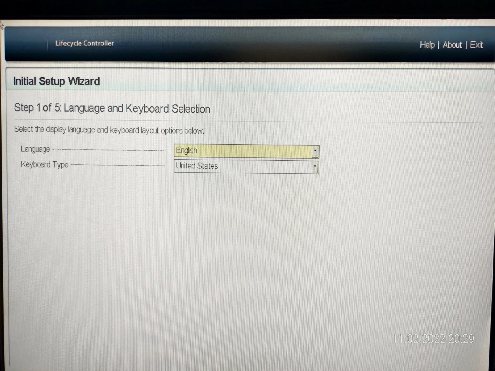

3) The setup wizard is displayed. If you had set this up previously, it may not show up. Step 1.
4) Setup Wizard Step 2.
5) Setup Wizard Step 3.

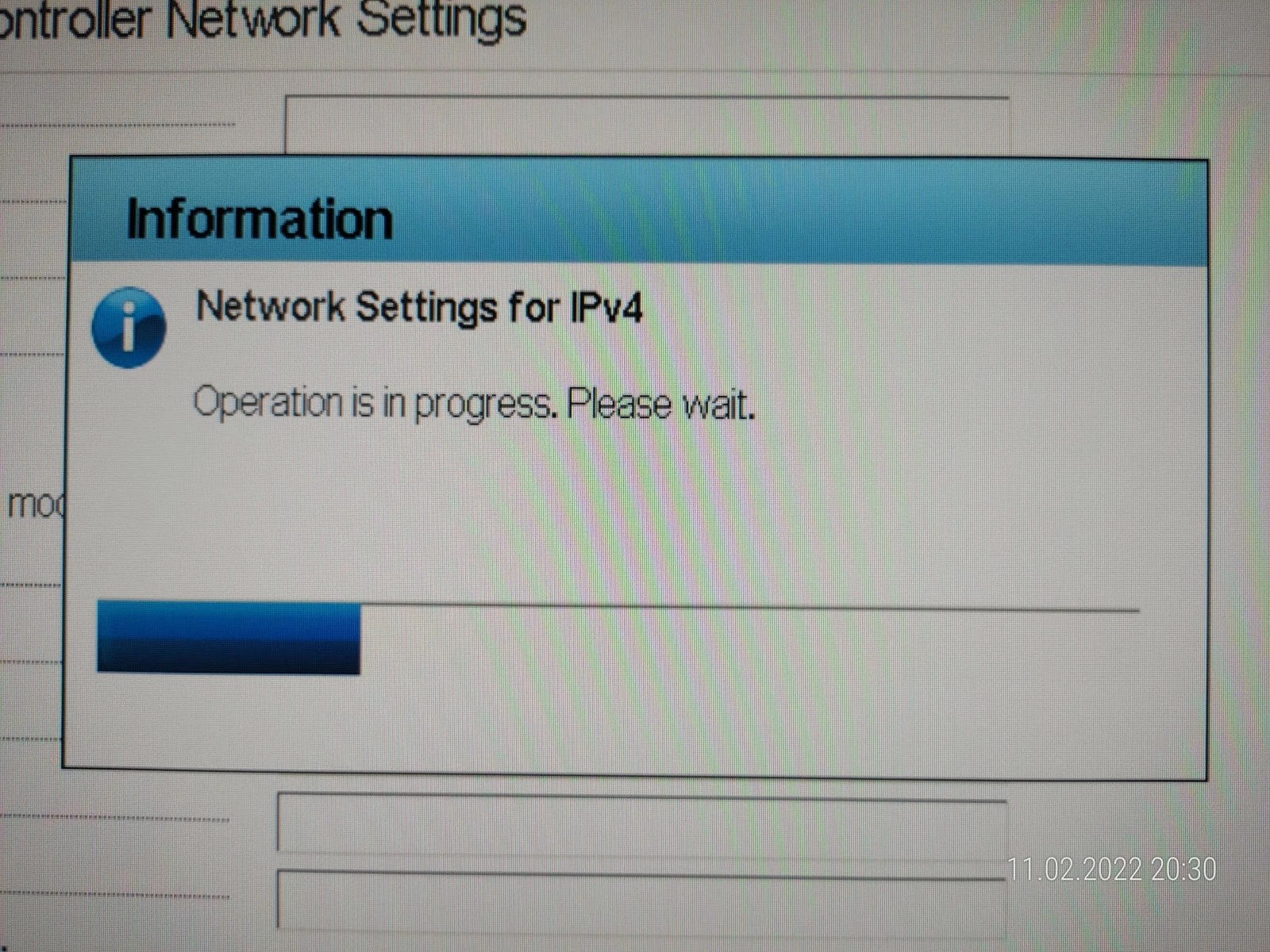

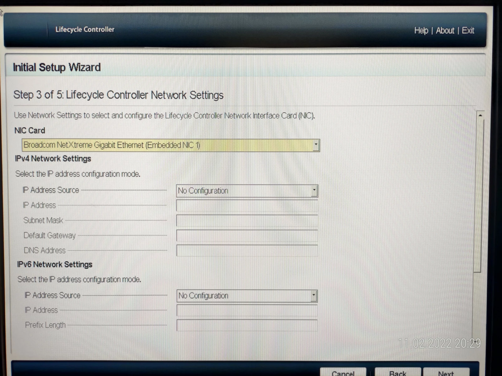

6) IP auto configuration as part of step 3.

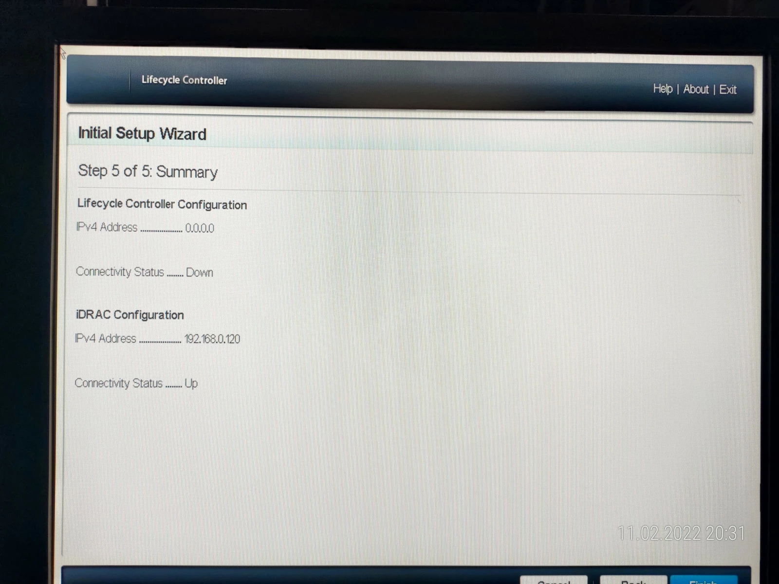

7) Step 5 of the wizard as Summary.

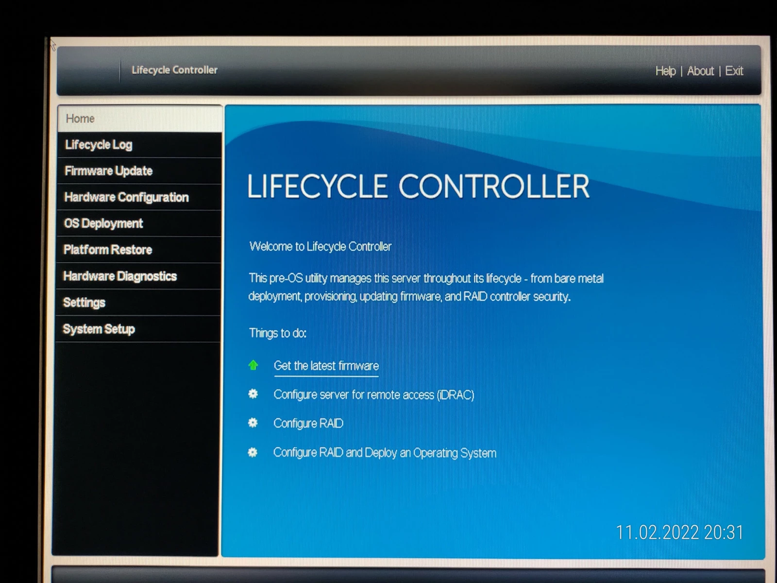

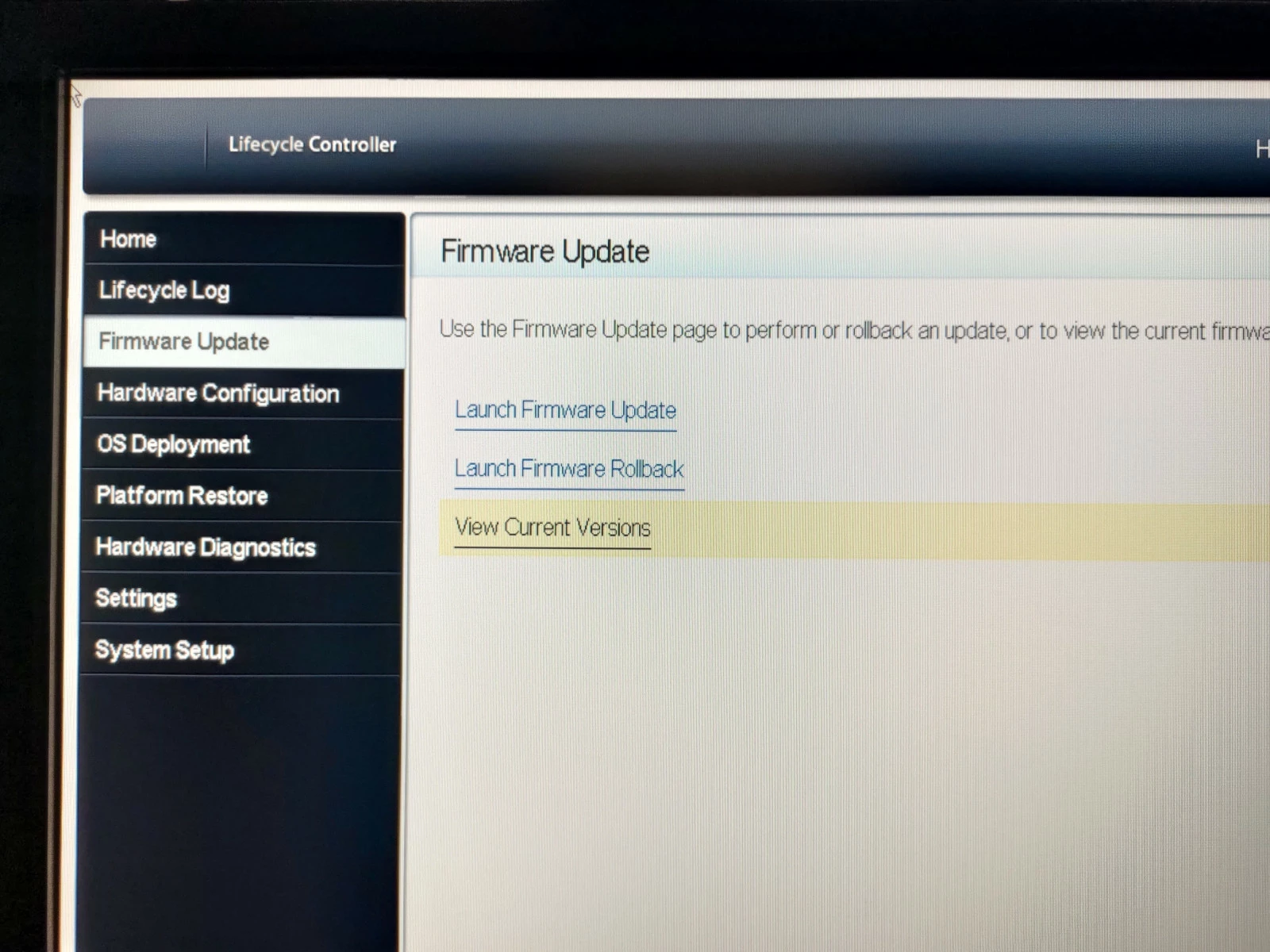

8) Home screen on the lifecycle controller - launch the 'firmware update' on the left-hand side.

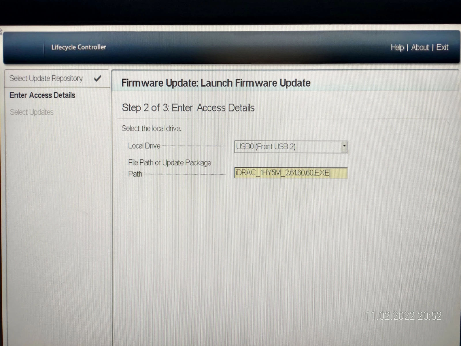

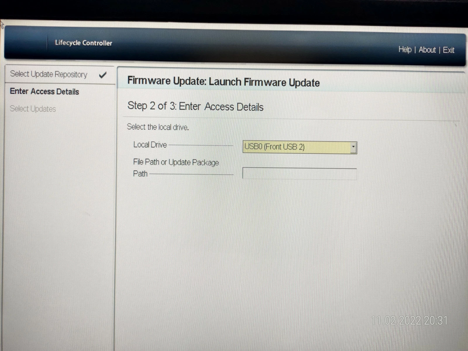

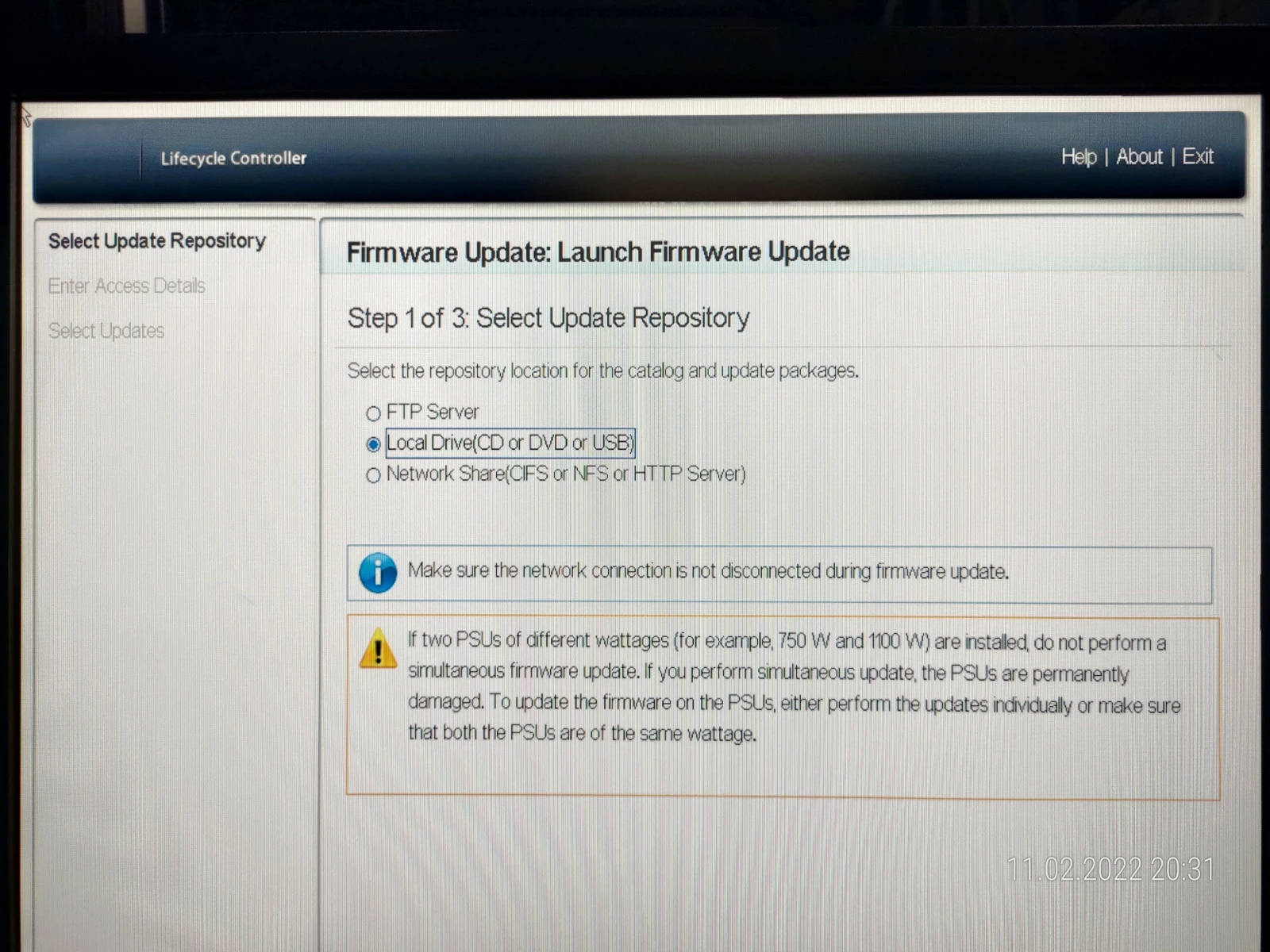

9) The following wizard will be shown - in this example,  the 'local drive' is used, that could be a plain USB stick/thumb drive in FAT32/VFAT file system format.
10) Confirm the USB port and manually enter the filename as it is stored on the thumb drive.
11) Filename entered:

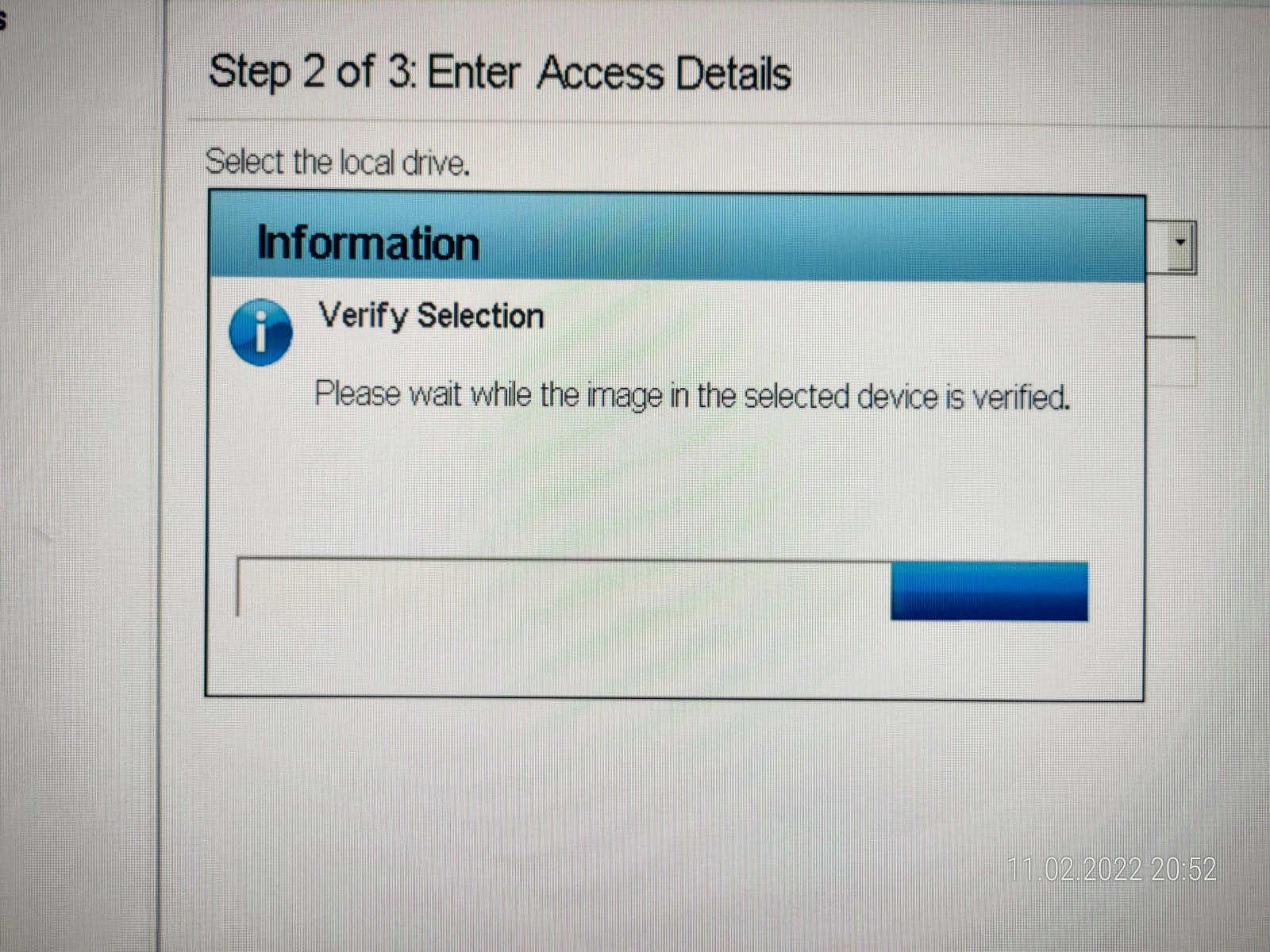

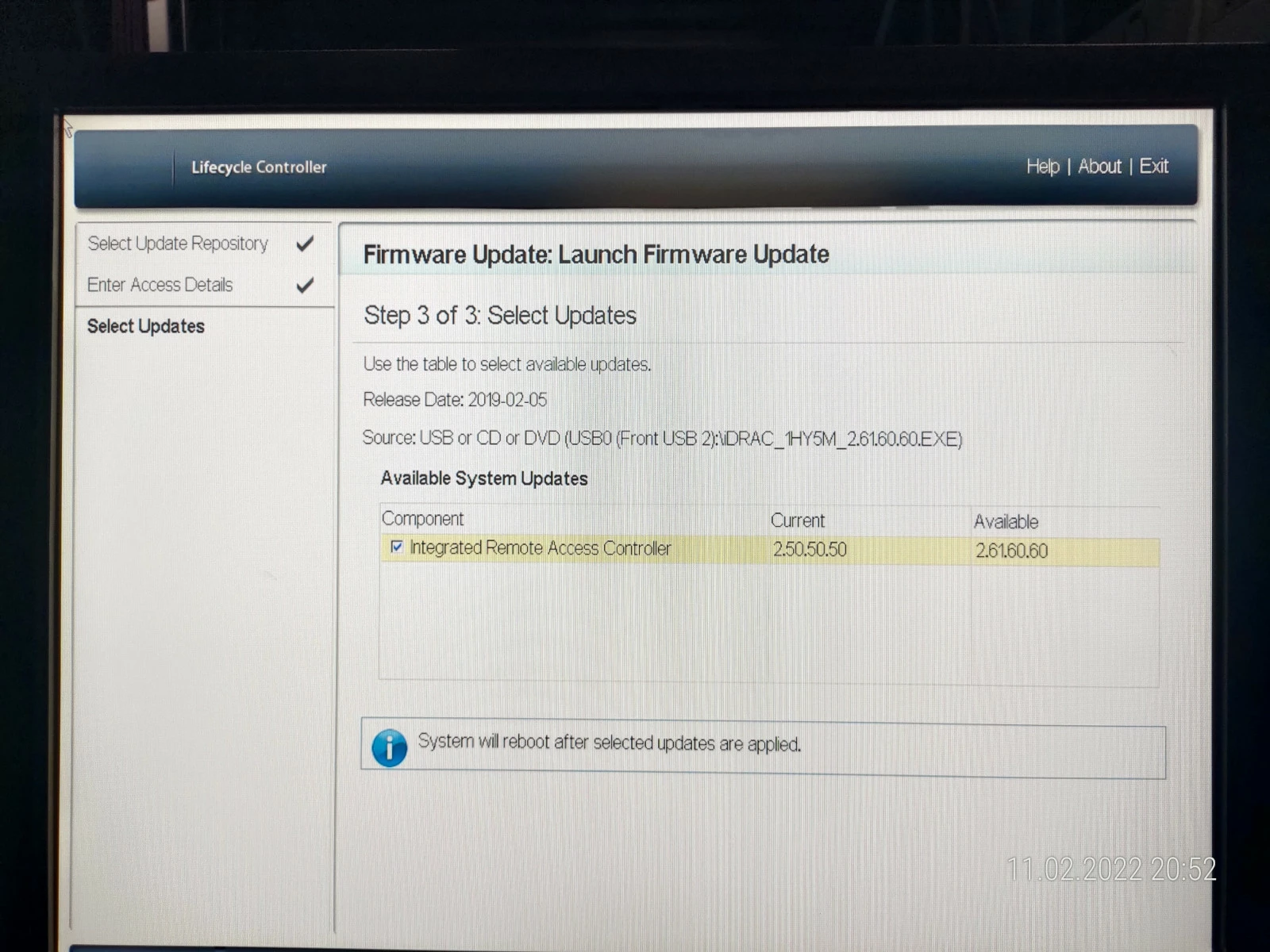

12) Summary prior updates - if it is accepted, the actual upgrade process will start, that will take its time.
13) Lifecycle controller image verification.

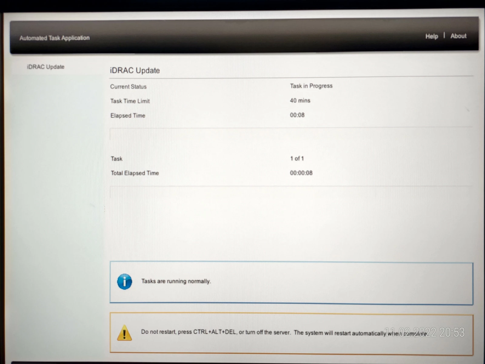

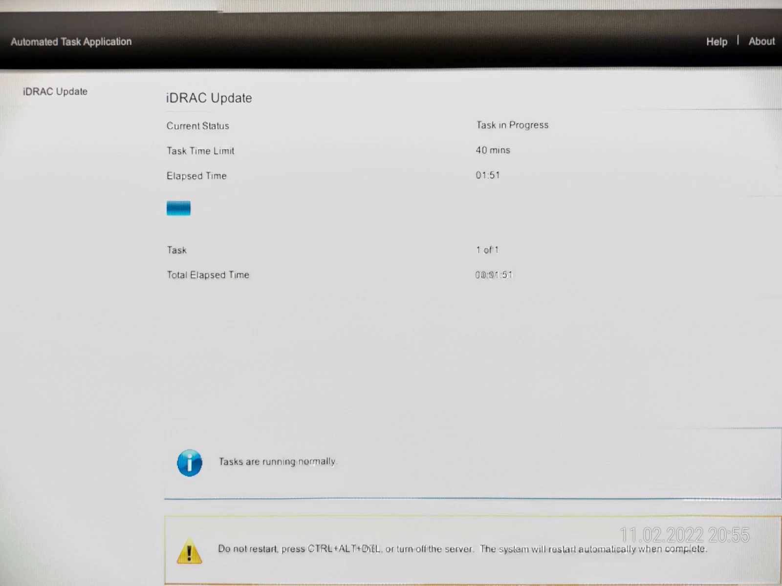

14) Upgrade started:
15) During upgrade:

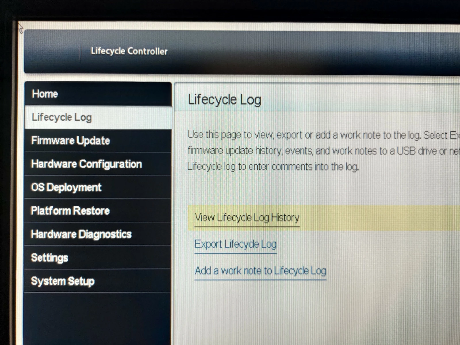

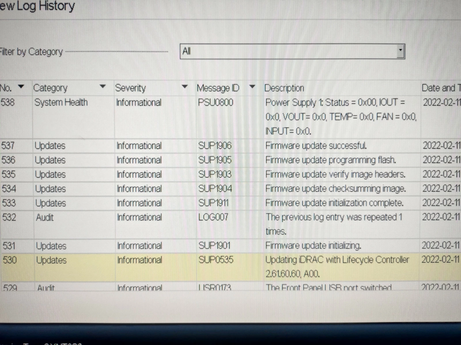

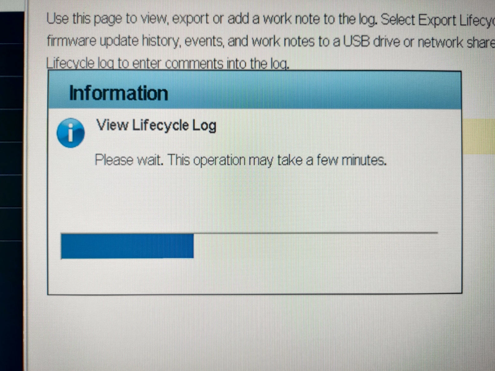

17) Enter the Lifecycle log:
18) That will also display a loading screen again.
19) The log should display the controller update was successful, such as:

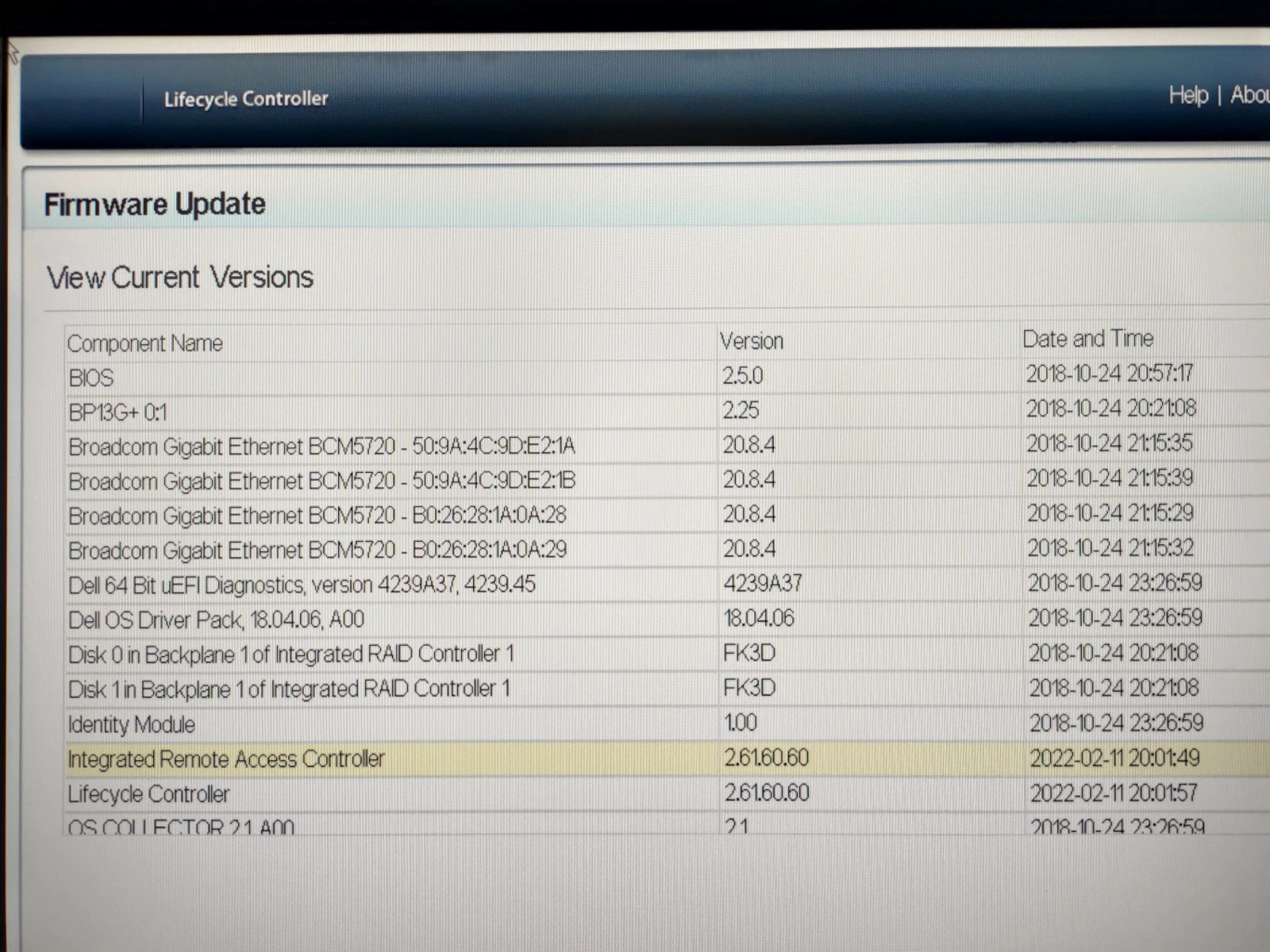

20) It is also possible to verify with the 'View Current Versions' under the 'Firmware update' section.
21) Example versions here after the upgrade of the Lifecycle controller and the Remote access Controller.
