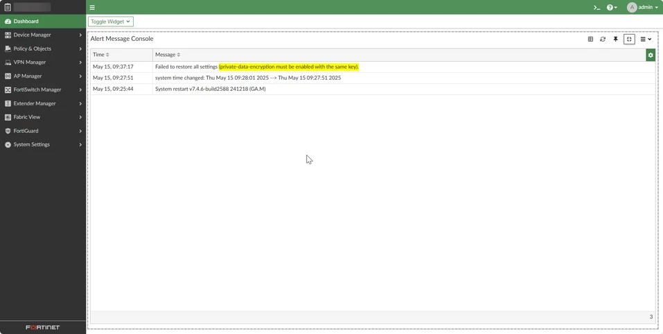

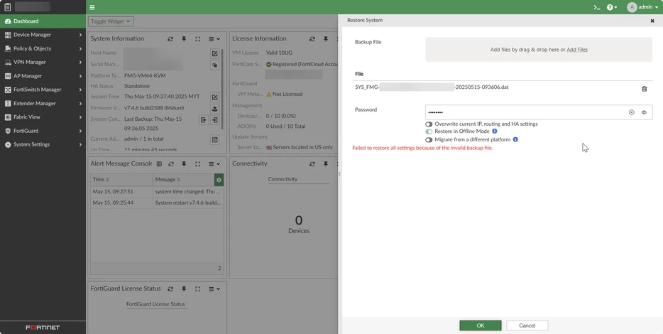

Users may encounter failure when trying to restore or migrate the configuration backup into FortiManager or FortiAnalyzer.
To find why the restore/migrate fails, users can check the Alert Message Console widget under Dashboard -> Alert Message Console, or the Event Logs under System Settings -> Event Logs.
In the example below, the error message 'Failed to restore all settings (private-data-encryption must be enabled with the same key)' can be seen.
This error message means that the configuration backup that was taken previously had the configuration 'private-data-encryption' enabled, while the current configuration does not have 'private-data-encryption' enabled (or it is enabled with an incorrect encryption key).

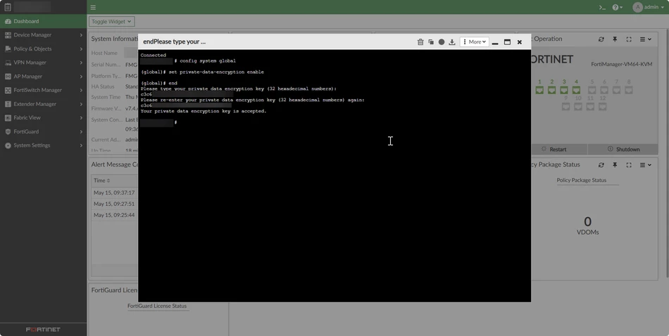

To enable this, enter the following command into FortiManager/FortiAnalyzer:
config system global
    set private-data-encryption enable
Please type your private data encryption key (32 hexadecimal numbers):
<private key>
Please re-enter your private data encryption key (32 hexadecimal numbers) again:
<private key>

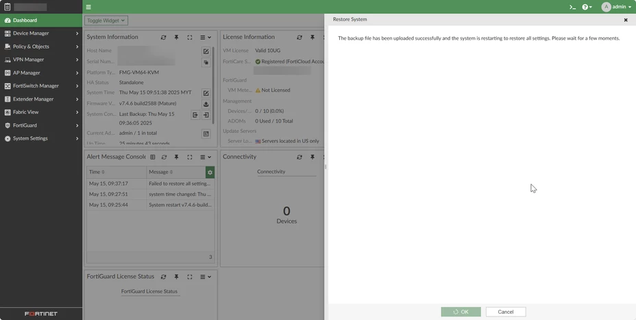

Once the configuration has been enabled, the restore/migrate process should be successful.
