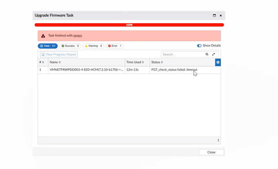

  1. In this scenario, FortiGate is upgraded via Device Manager -> Managed FortiGate -> Firmware Version -> Upgrade Firmware -> Custom -> Select the appropriate version/image and select -> OK.
  1. During the upgrade, the upgrade will fail with the error 'FGT_check_status failed:timeout'.

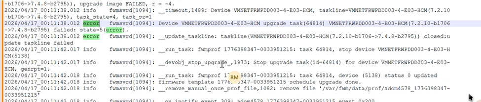

  1. To investigate further, run debug as below in FortiManager CLI Console and perform the upgrade again.
#diagnose fwmanager fwm-log
  1. Debug will show error failed state=5(error):
  1. Looking at the error code, it is related to FortiManager not retrieving the upgrade status within the default timeout.
