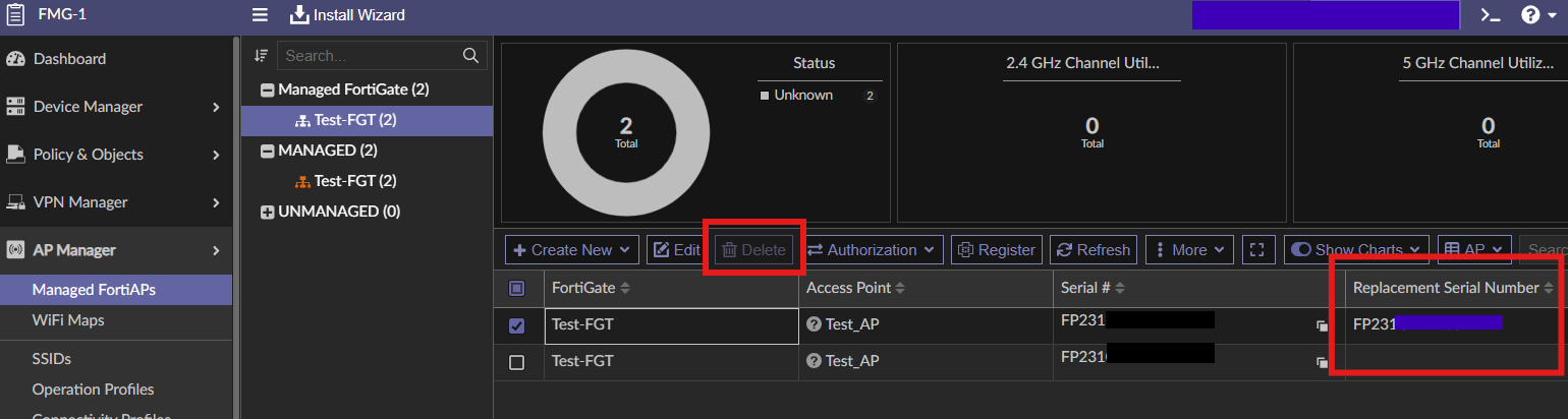

If the old FortiAP is unable to be deleted from the FortiManager, despite the new AP being authorized and running as expected:

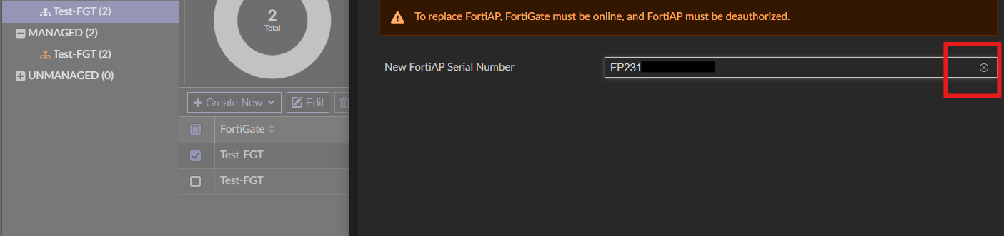

Log in to the FortiManager and go to AP Manager -> Select old FortiAP -> Authorization, de-authorize the old FortiAP, and then try to delete the FortiAP. If the delete button is still greyed out, proceed with the following:
Remove the replace serial number:
Run the following command to force a database sync.
